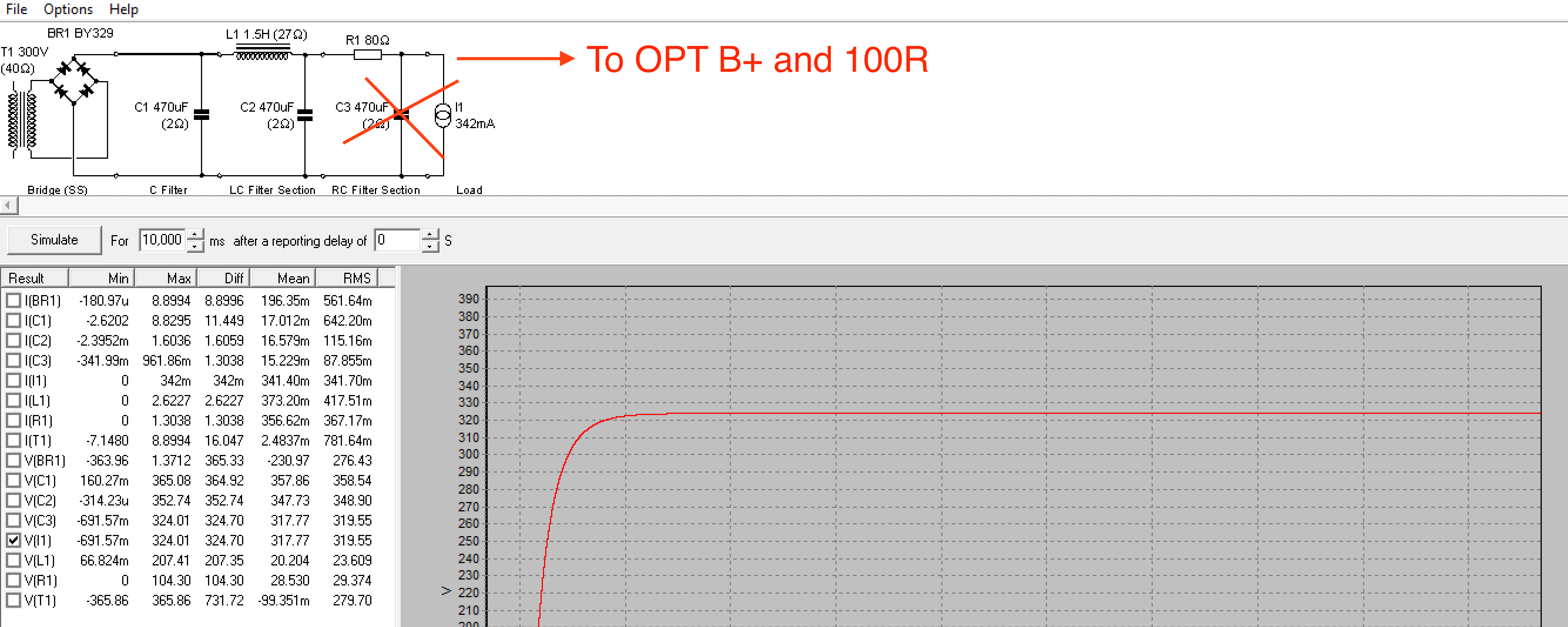

OK-- question for the council:
So, I need to drop about 30 - 50 volts to hit a supply voltage of around 300VDC to 320VDC and I'm running into some space restrictions in the chassis.
I'm sure I could drop the B+ by lowering the first cap to around 10uF or so (guessing at the value for the moment), but would removing the final filter cap be an option (see schematics attached)?
Thoughts?
Kofi

If you are 350V and under and no signs of red plating I would not worry about it, the supply voltage will likely sag a bit at higher powers. Otherwise I would recommend a power resistor in series with the HV secondary as already suggested.
Don't under any circumstances remove that last filter cap unless you want lots of cross-talk and generally poor performance.
Most of the antique 6BQ5 amps I have worked on were between 360 - 400V on the plates with a nominal 117VAC line (variac) and the only tubes that seem to have a problem with this are current production JJs IMVLE.. HH Scott stuff with 7189As were over 400V.

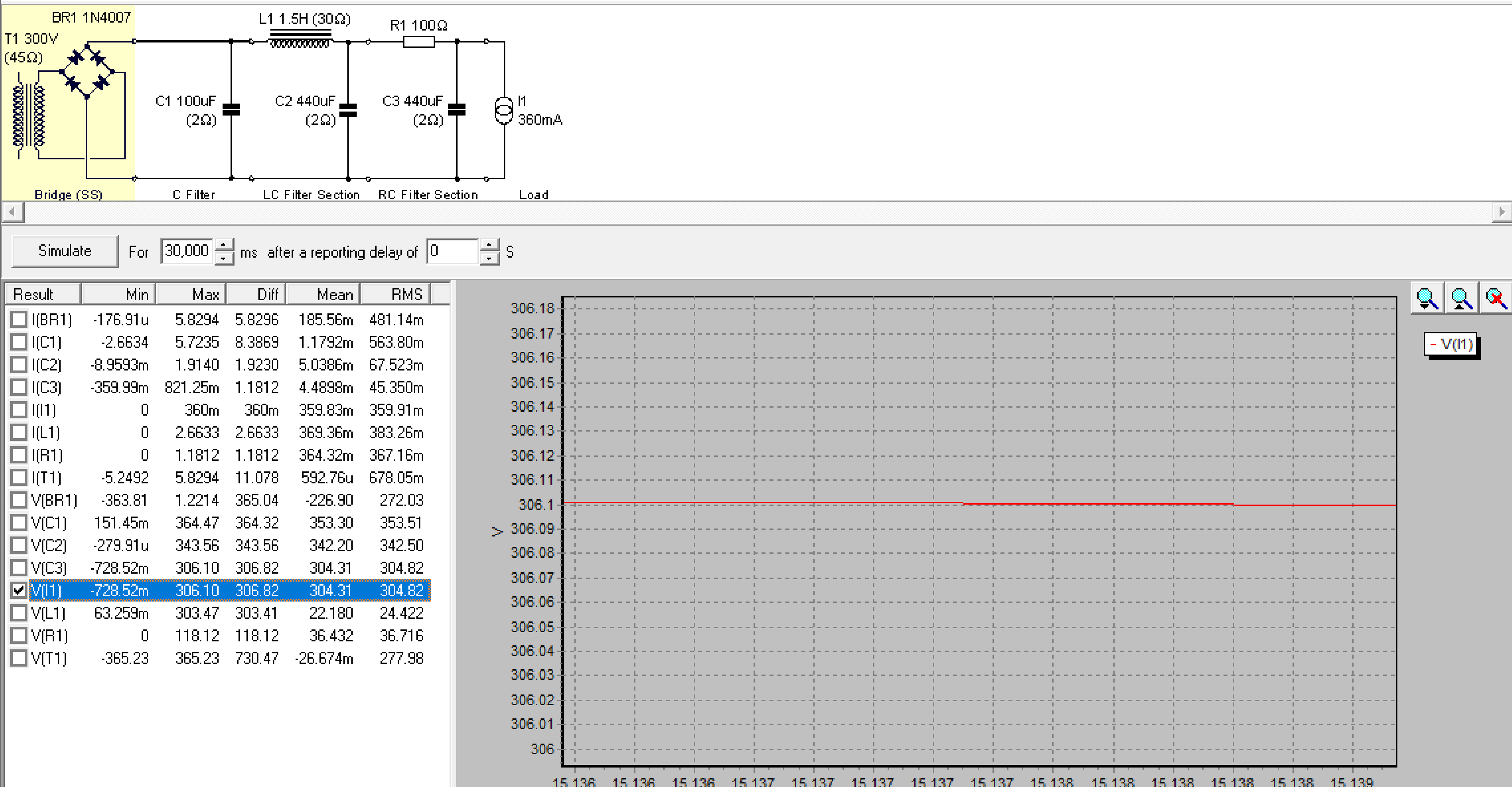

I'd leave the final cap in place. You could reduce the first capacitor to ~100uF to minimize the initial turn-on surge, and use something like 25R-10W in each leg of the PT secondary before the rectifier.
Hmm.. I believe someone mentioned this before but I blew by it.
So, I modeled another supply in PSUD, adding an additional 50R of source resistance to the power transformer to mimic the impact of the 2x25R resistors in each leg of the AC before the rectifier.
Does this look correct?
Kofi

I should not have posted late (for me) last night and I wasn't really thinking this morning.
You were correct with your model in post #134. If you take the whole supply into account there is plenty of filtering and all of the voltage adjustment can be done with the series resistors on the PT. And, you get rid of the big power soaking resistor. The power stage ripple should cancel in the OT.
I hope I didn't cause you too much trouble with my errant post.
