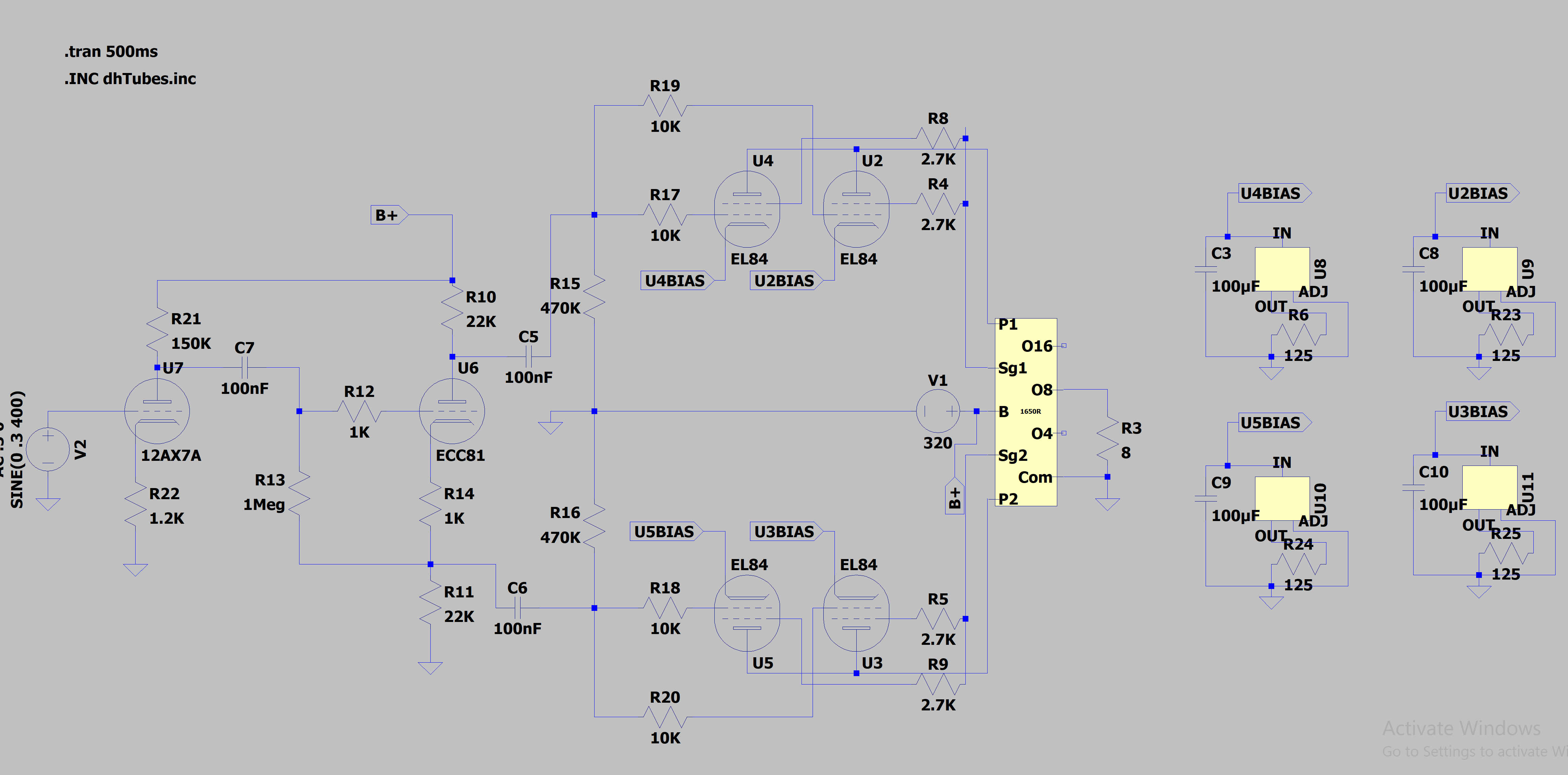

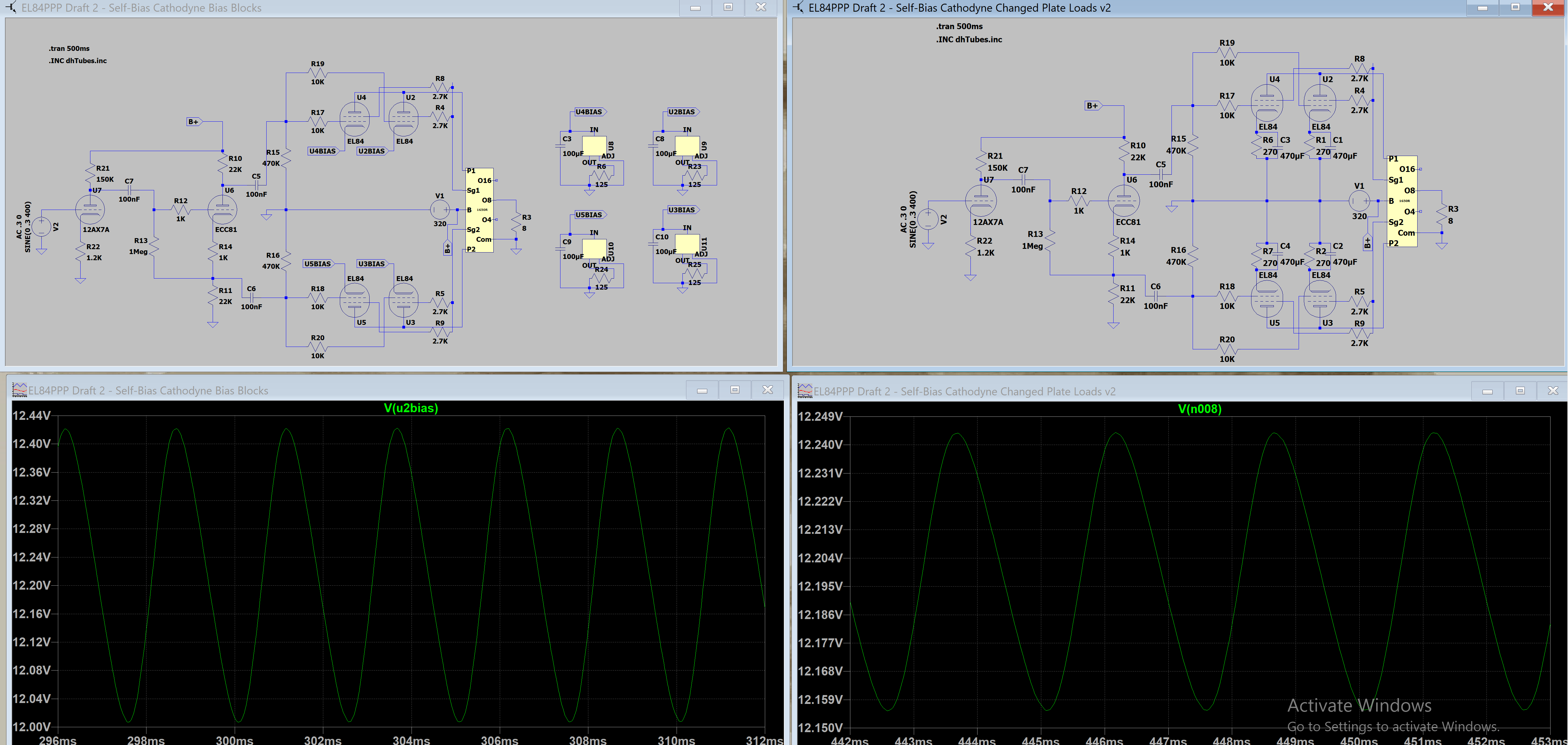

I put your proposed circuit into LTspice and let it do its thing. This looks like a nice circuit! At least in simulation...

Started noodling on a simple bias block using the LM7805 (see attached). Maybe this is a simple solution that would allow current regulation and keep the balance between the pairs?

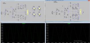

I'm having some trouble implementing gNFB in LT Spice for this design. I'll post my total failures in a bit, but can anyone offer advice?
Kofi
GNFB amount and square wave ringing damping will be very much a bench exercise. The output transformer and the whole layout will have it's practical behavior. You will judge THD benefits vs how many dB of NFB vs subjective tone vs how much square wave damping by the hundreds pF range capacitor to ride the Rf resistor yada yada yada.
But do you have enough open loop gain to spare some in GNFB to start with?
Also, if the polarity of the feedback signal is in phase with the input signal, the two will be additive (positive feedback) and LTspice will go nuts.
Try swapping the polarity of the outputs from the cathodyne to the output tubes.
I don't know if this will hold up in real life, but the simulation I did predicts that with the amp running open loop, an input signal of about 200mV rms drives the amp to clipping at approx 18W rms output (THD = 1.46%).
9dB of NFB is predicted to change that to 800mV rms input to reach 20W rms out at 0.6% THD.
Is 9dB of NFB enough?
I've attached the .asc (LTspice) if anyone wants to double-check my work.
It would be nicer if for 15dB of NFB, both for less THD and usefully less sensitivity for better SNR with modern system gain structures. But even 9dB brings a considerable improvement, yes.
