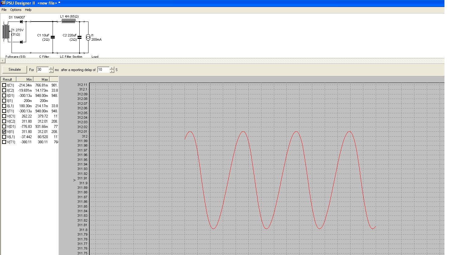

Here's the current PSU. Note that there are no resistors, per Sheldon's comment. This should give around 312VDC, but is the ripple acceptable?
Also, if I went with an oil cap for the last one I could only get about 40uF, which would increase ripple but would allow a non-electrolytic as the end cap. Which is more desirable?
If the ripple is acceptable, you are getting good CMRR, which means that the last cap is not really in the signal current loop, so even though a film cap is large enough, an electrolytic is fine.
If, on the other hand, the ripple is not acceptable, then it means that the cap is in the signal current loop, so you would want a film cap, but you would also want a better PS to reduce the ripple meaning that you might need the electrolytic anyway.
Were it me, I'd try a big electrolytic here, and if there is too much ripple, put in a simple regulator followed by a small film cap.

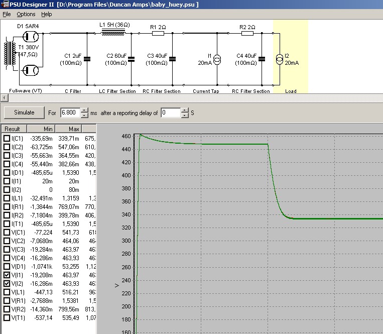

My modelled psu for the Baby Huey.
I1 and I2 show 20mA because thats how PSUD works. I've started each channel on 20mA and it goes up to 80mA after 2 seconds. (I'd rather PSUD shows the 2nd value of the current tap.
Thing to look for is lack of ringing. Which seems to be the case.
Closeup:
If you mean you are splitting the supply after the choke, then that's not the way to model it. You show them in series, but they should be modeled in parallel. Use one RC and one current source. Double the capacitance, halve the resistance and double the current.
Sheldon
Sheldon
Sheldon

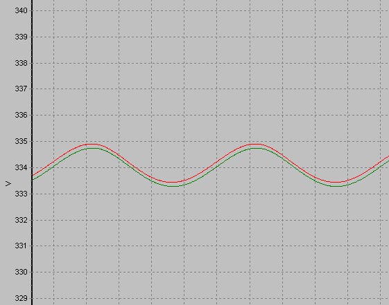

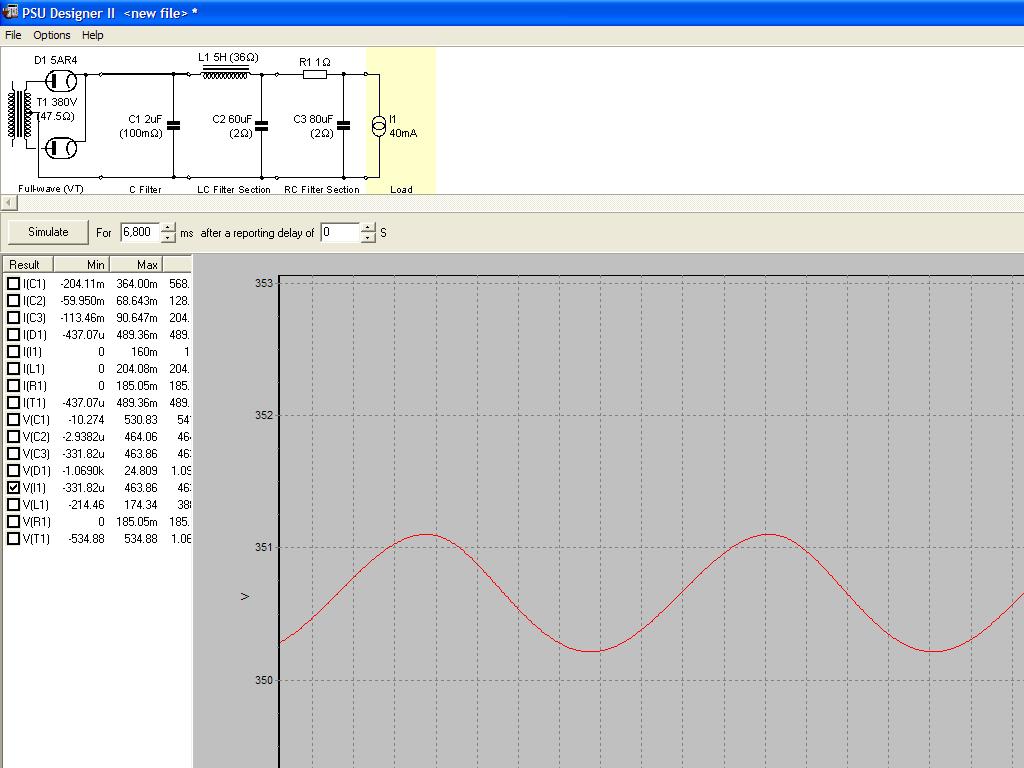

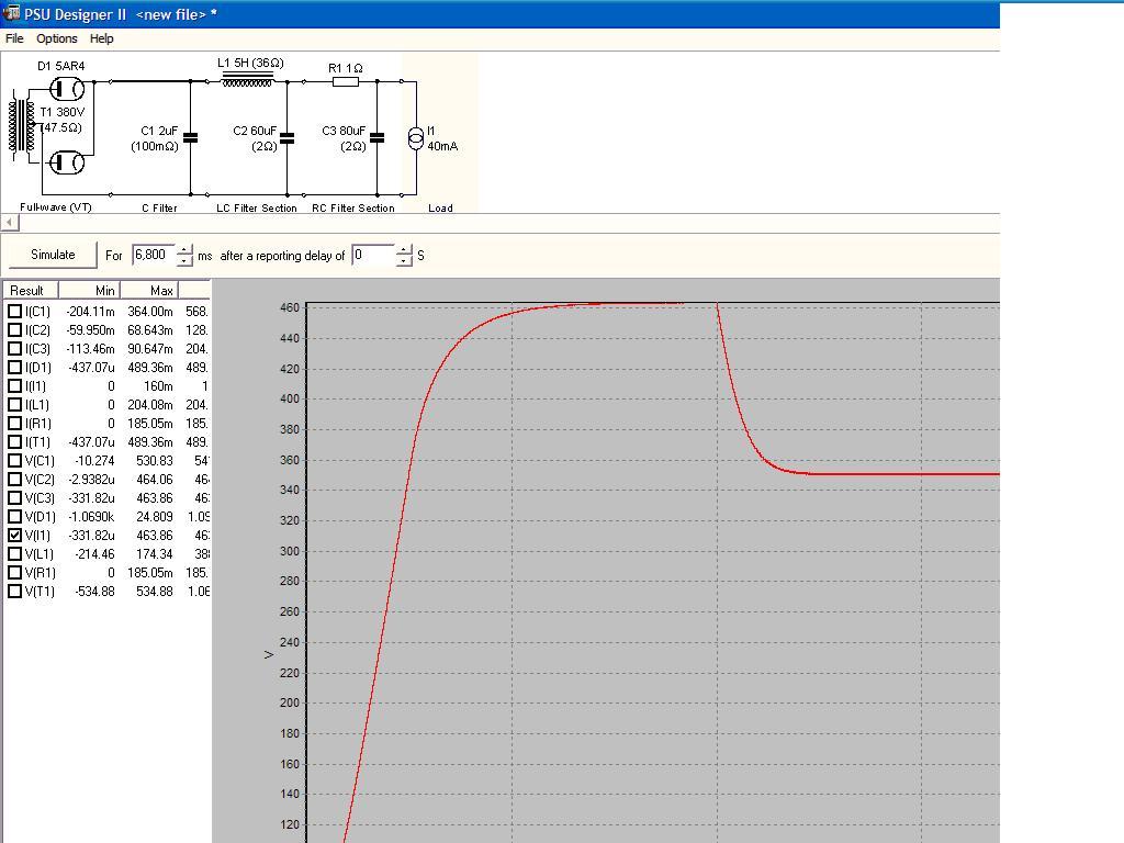

Like this?
Current doubles from 40ma to 160ma after 2 seconds
Note: changing the R value from 1 ohm to 100 ohms gets back to around 335V B+ with less ripple in this model.
Yes you are correct of course. I knew that. But just wanted to demonstrate clearly the branching after the choke. 🙂If you mean you are splitting the supply after the choke, then that's not the way to model it.
