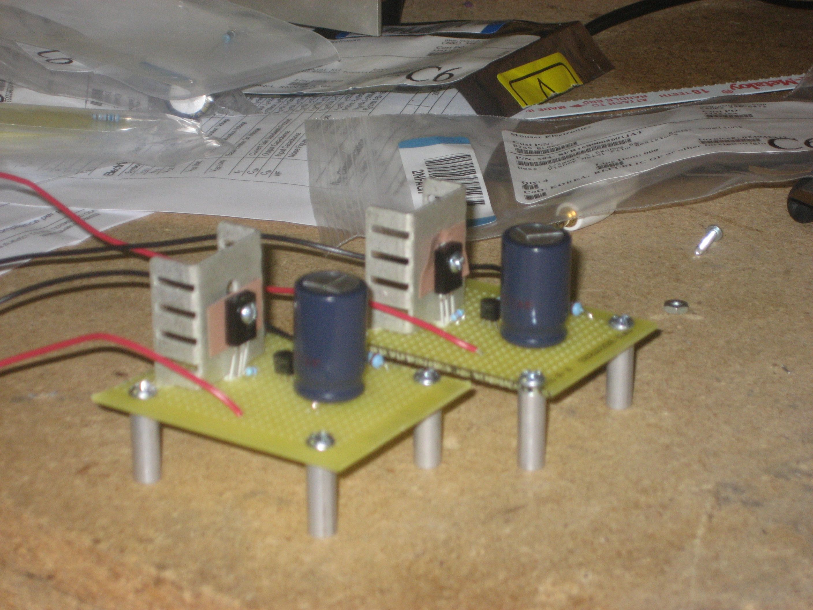

UPDATE
Most parts have arrived! I'm still missing transformers and some audio circuit parts,but I have enough to complete the bias blocks and CCS circuits.
Photos / moronic questions to follow.

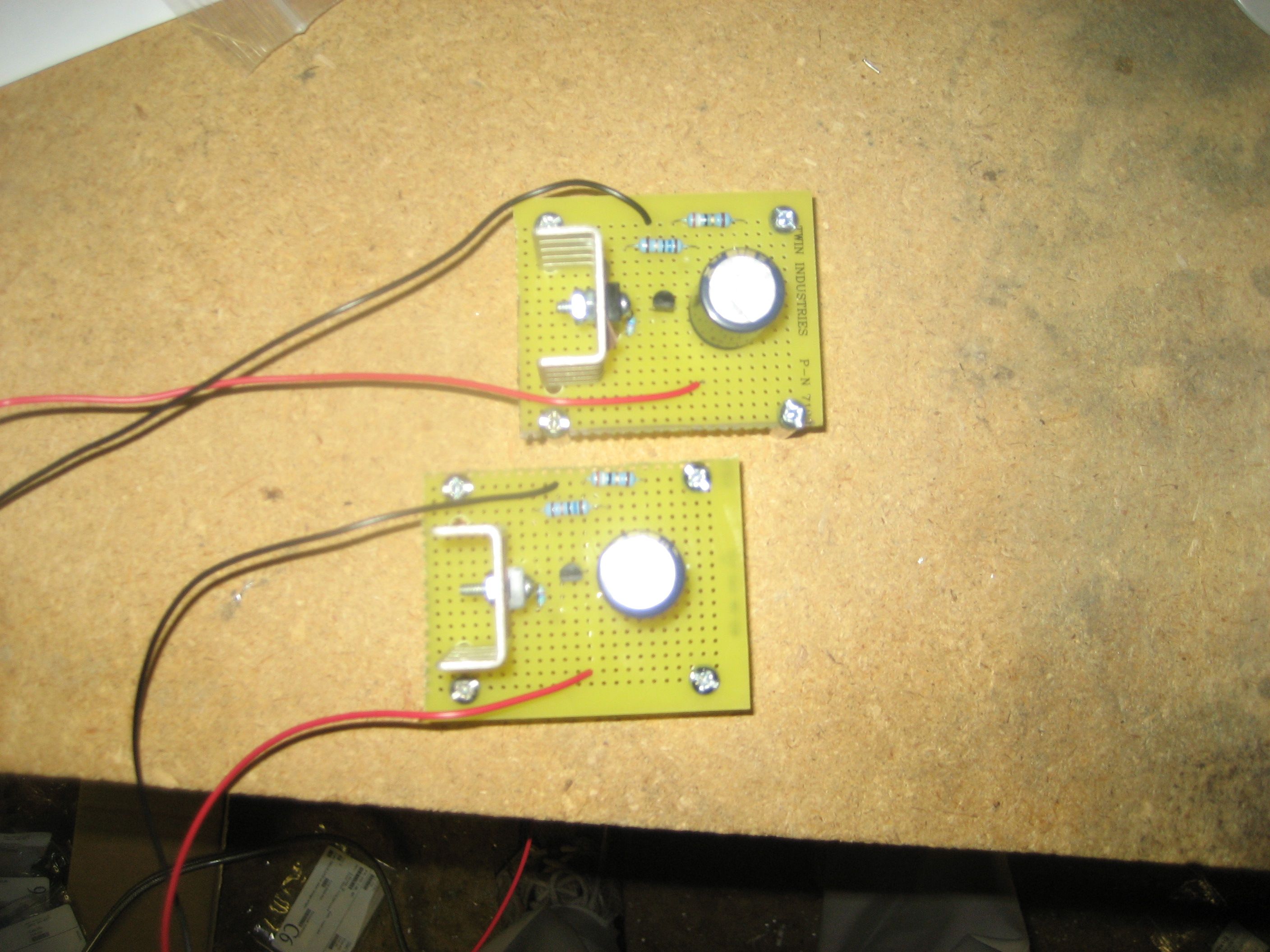

I know its been a while, but the top plate is now dry and I'm ready to start the serious soldering.
First question of the day-- what's the best way to test the bias blocks and CCSssessses? Can i put a resistor across them and test before they come in contact with the rest of the circuit? If so, what value resistor would be best?
Pictures coming...

If I understand what you are asking, you should be able to calculate that. You know the voltage drop (i.e. operating point) you need and the bias current. Ohms law V=IR or R= V/I. Make sure it has enough wattage P=IV or I^2 R.

Kofi: Gingertube covers testing the blocks in posts #402/#403 of the original BH thread.
http://www.diyaudio.com/forums/tubes-valves/72536-el84-amp-baby-huey-9.html
