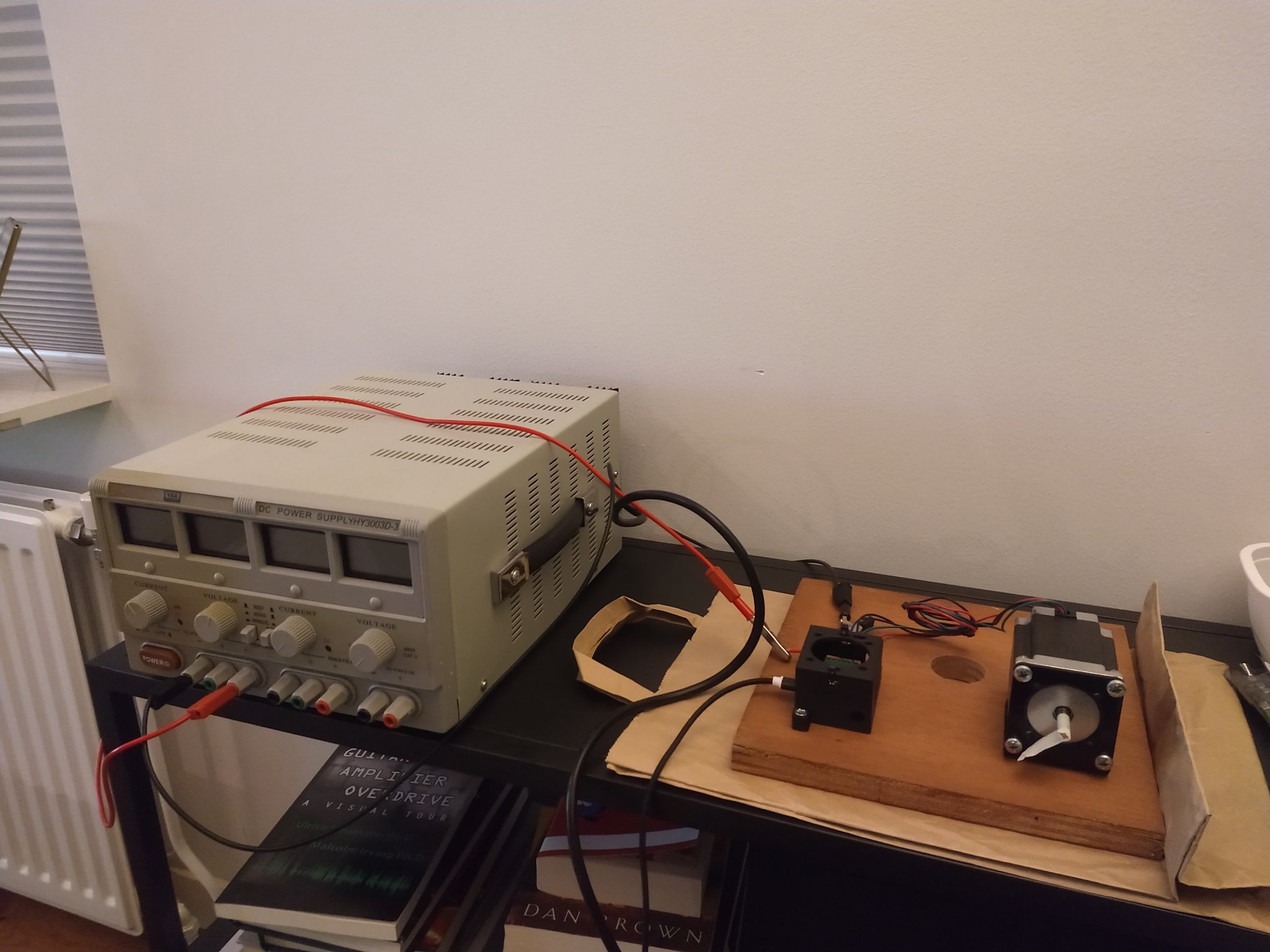

The controller has a USB interface.What are you going to use to communicate between the stepper drives and the computer?
https://www.pololu.com/product/3141
![IMG_20240217_201428027.jpg IMG_20240217_201428027.jpg](https://www.diyaudio.com/community/data/attachments/1182/1182528-3af4984181ebe72a4825cf8fa1852025.jpg)
