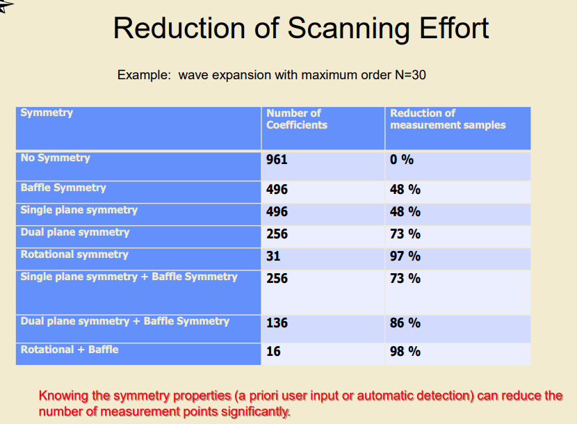

In my opinion, there are two primary reasons to pursue a DIY near field scanner:For symmetrical horizontal work this is about 12-15 as I said, but for full spherical work the number goes up rapidly.
- full range, high resolution, anechoic data from echoic rooms.
- high resolution polar data.
Maybe I should have clarified that: full range, high resolution, anechoic polar plots from indoor measurement data isn't something we can do at all right now.but a DIY anechoic polar plot from indoor measurement data isn't something we can do at all right now.

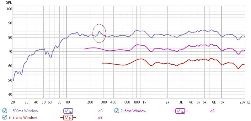

If I remember, you have said that you can use a 6ms IR window in the space you have for measurements, I used to have a room where I could do a 6ms window, the best I can get in the rooms I have to work with now is 3.5ms. Here's a comparison of those IR windows to a beamformed measurement with a 500ms window:
There's a resonance below 300Hz that completely disappears once a short IR windows are applied. Is this resonance audible? I don't know, but my data wouldn't show that it was there with a short IR window. Yes, I know that there are multiple ways to find an offending resonance, and there is every reason to use them. However, many of those methods are used because the frequency resolution from the primary dataset is too low to reveal those resonances. If you have a design process that identifies lower frequency resonances by a means other than frequency response, that's great, use whatever toolset works for you (and share tips and tricks!), but for me, I want to have a primary data set that has high enough resolution to see things like that in addition to those other analysis tools.

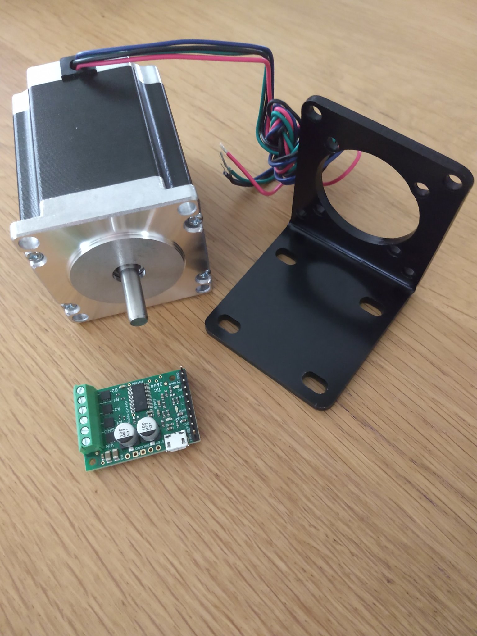

I'm trying to break things up into small pieces. I can move the stepper motor with the tic controller software, ticcmd and arta_tic. I can simultaniously play and record sound in Python (and I'm working on doing this in Octave). Python can story .mat files that Octave can read. MATAA can do stuff. Although NTK's code doesn't currently run on my computer, he's willing to help.
Biggest gap is the hardware. I've some ideas. I've order some stuff. But I guess that will take some time and experimentation.

Nice! What are you going to use to communicate between the stepper drives and the computer?First toys have arrived!
That's already more commitment than with arta_tic, which I developed without the tic board and stepper motor.
I'll go manual until a viable CNC system makes it's way to the threads. Right now I'm busy helping my oldest son make a kitchen cabinet set. See what happens when you were a Cabinetmaker?
As I would expect, there is strong agreement between your statement and with Klippel's process:But it could be far less than that if some simplifying assumptions about which modes to use are made.
Based on the information Fluid posted, device symmetry is one of the big the keys. So there would be benefit to allow the user to inform the system how complex the DUT is.
