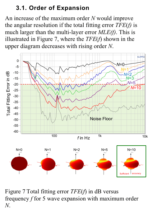

Klippel's documentation shows an error rate which is dependent on the number of fitting points related to the expansion number N. -20dB or more is meant to be good enough.This is not true. It takes exactly the same number of field points as the number of radiation modes, which are finite. Typically only about 20 modes (horizontal, maybe double that for full sphere.) More points are actually superfluous.
The number of measurement points necessary to reach the expansion order is given by: 1.5 * 2*(N+1)^2
This is how I came up with the figure of aiming for N=5, 185 points or more to reduce the fitting error to below -20dB for 1K.
That graph is showing exactly what I predicted, for higher frequencies the whole idea doesn't work.
They also just still use a stitching method as well, because it seems that for lower frequencies the method also doesn't work well anymore.
Leaving a small usable range left from just 60Hz to about 1kHz.
The question remains what method will give less error from 200Hz and upward?

I have no idea where this equation comes from and I don't see how it could be true.The number of measurement points necessary to reach the expansion order is given by: 1.5 * 2*(N+1)^2
If I want to find the radiation contribution values for 20 modes (unknowns), then I need only 20 data points (knowns) to uniquely determine the unknowns (all complex.) I found that for horizontal only, 20 modes was overkill and that 12-15 worked very well. This makes the above equation look absurd.
Remember that we are taking data in the near field and as such one cannot just calculate the impulse response and let it go from there. You have to move the results into the far field which is why the full blown analysis of the radiation modes is required at all frequencies and not just below some "matching" point.
This is because of the numerical issues that I talked about. The system is becoming "singular" and one needs to use some tricks - like SVD - to get stable results, but yes, things become less reliable at LFs.it seems that for lower frequencies the method also doesn't work well anymore.

The explanation from Klippel is in this document on page 25, there are further explanations of the error metricsI have no idea where this equation comes from and I don't see how it could be true.
https://www.klippel.de/fileadmin/kl...nsparancies/Klippel_holografic processing.pdf
Also on page 14 there is acknowlegement that in theory the directivity can be described by a very few points, which is perhaps what you are saying.
I don't have the ability to discuss whether what Klippel or you say is correct. I have no reason to doubt either, most likely both are right for different reasons.

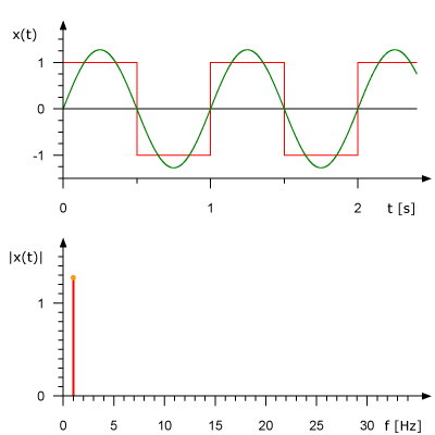

I simply don't get what everyone means by "phase" in this context. The term "phase" relates to the angular argument of a sine (or cosine) function.
However, as I see it, the microphone(s) will record the test signals from the speaker and its room echoes. The signals can be Dirac pulses, white or pink noise, MLS, sweeps, etc. They will not be sinusoidal.
I think this is not clear to many people at first, it certainly wasn't to me.I simply don't get what everyone means by "phase" in this context.
In brief, it's a consequence of the Fourier transform, that takes real values as a function of time, and transforms that into amplitudes and phases as a function of frequency.

A pressure as a function of time is equivalent to a amplitude and phase as a function of frequency. One is in the time domain, the other is in the frequency domain. Both contain the same information.
It's like a different language. An English newspaper and a French newspaper both have an accurate story on an event. Someone says the event took place at an 'eglise'. You say the word 'eglise' isn't an English word.
That's true, but 'eglise' means 'church' which is an English word and that is present in the English newspaper story and where the event took place.
Phase = 2 x pi x f x t
