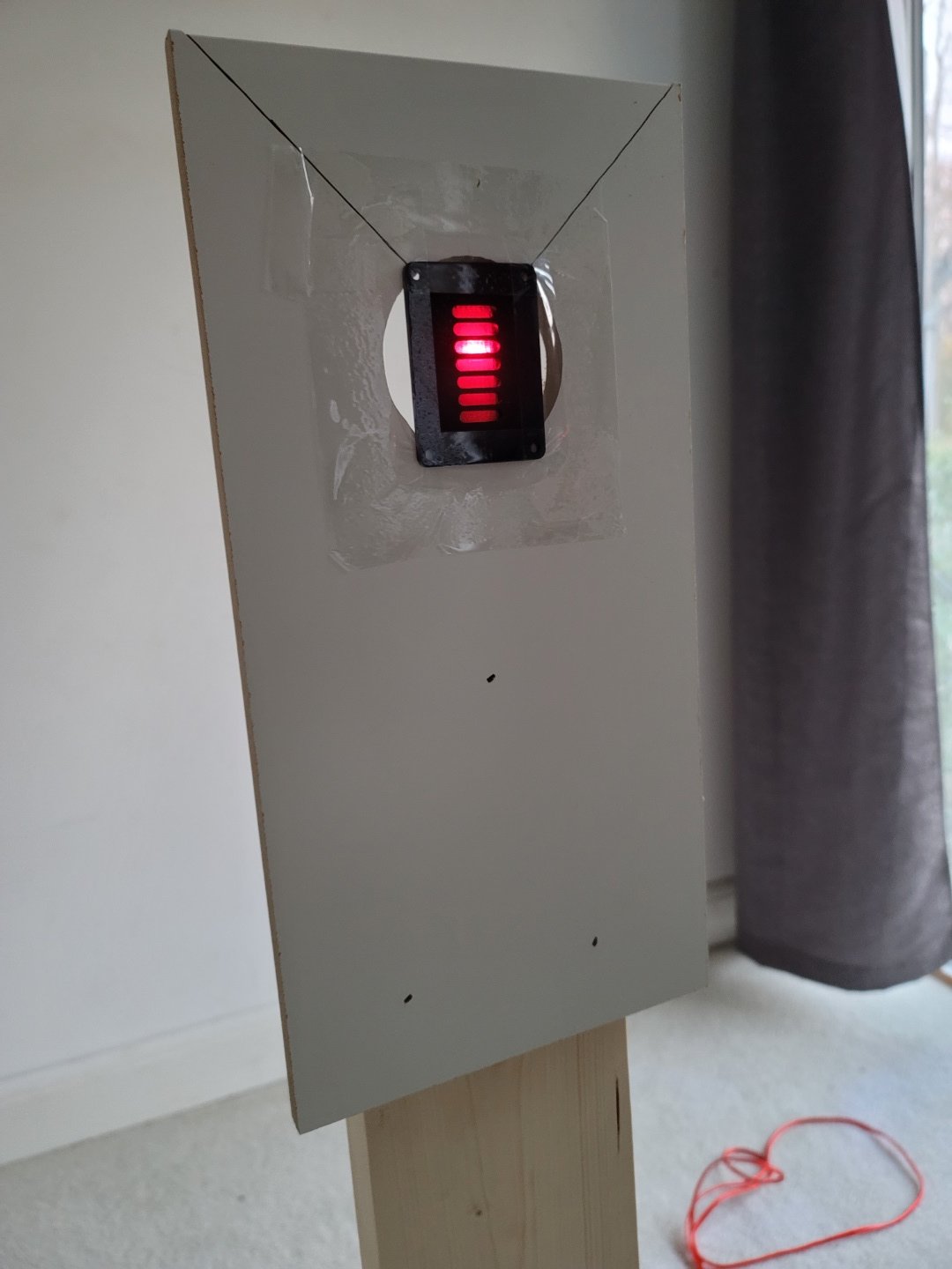

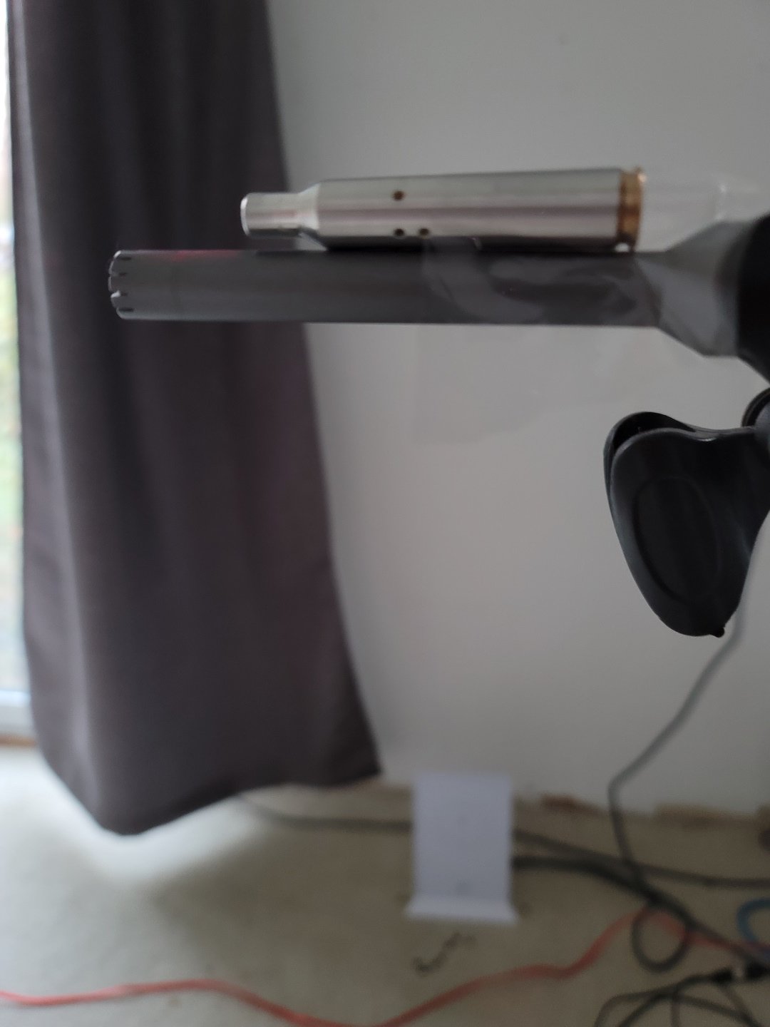

Earl is there any chance that you took a pic of your test setup?
I have done a lot of polars the old fashioned way with a mic boom and reasonable measurement. I use a gun bore LASER sighting tool to get a good idea where I am aiming the microphone.
Right now I use hi-tech tape.
