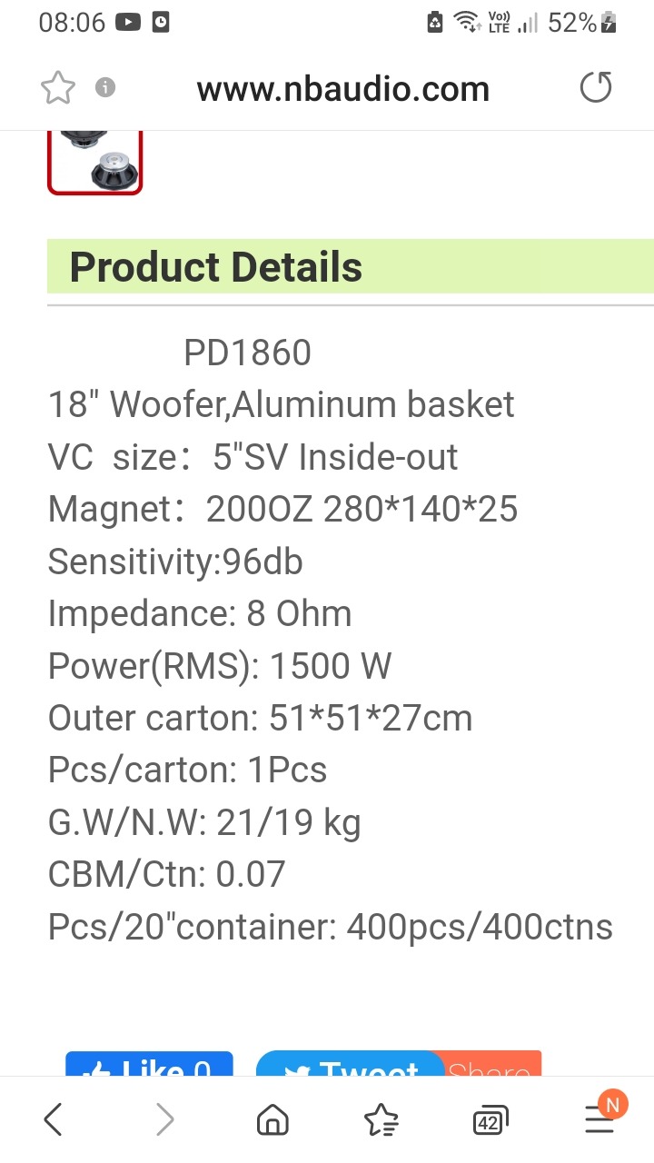

Are you referring to the precision devices PD1860?
They make a PD1850 but wasn't aware of a 1860. I can only see what looks like a copy of it?
The PD1850s are more than 20kgs compared to the 18sw115 at half that.
The genuine precision devices drivers are good but the 18sw115 will go lower and louder and hold together better while doing so. Save your money - do whatever it takes to get the 18sw115. It really is a beast!

Apologies I mistyped it, meant the pd186! I plugged the specs into hornresp and looking at it, it definitely will not hold a candle to what the 18sw115 can pull off. PD186's are really common drivers down my neck of the woods so they pop up cheap and readily available all the time so it seemed like a likely candidate, hence the intruige. Would definitely love to hear the keystones as they should so I guess I'll get saving!

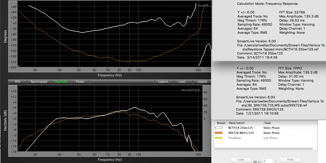

The Keystone loaded with a B&C 18SW115-4 has very similar sensitivity to the four ohm dual 18" JBL SRX728, the Keystone loaded with the 18TBW100-4 like you have may be a bit more sensitive.
The drivers in the JBL SRX728 have about 8mm Xmax, either of the B&C drivers have more excursion potential, so can go louder before they "run out of gas".
The DBX "auto EQ" is responding to the room response at the microphone location, and is simply not a good approach to system equalization.
Ported cabinets like the JBL SRX728 or your SRX722 are "phase inversion", the output at Fb (Frequency of box tuning) is around +180 degrees to the upper pass band.
Time/phase alignment is dependent on the acoustic crossover frequency, filters used, cabinet physical alignment, polarity, and phase response at a given frequency.

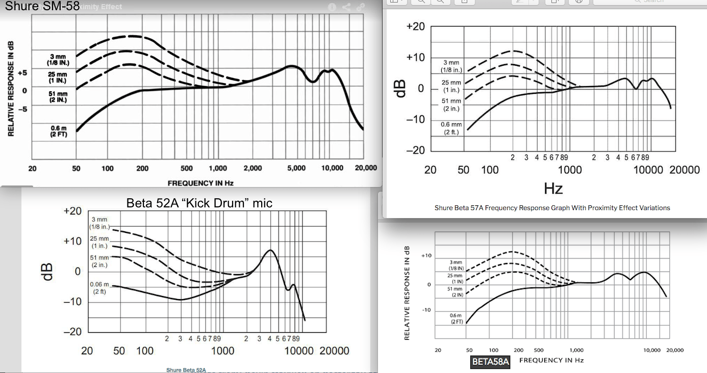

As far as response of a mic like the Shure Beta 52, or most cardioid mics, the low end response increases drastically with proximity to the source.
A 100mm (4") placement change can result in as much as +15dB at 50Hz for the Beta 52, +15dB in the 150-200Hz range on the SM or Beta 58/57.
All those mics have various "presence" peaks centered from 4kHz to 10kHz, primarily to "cut through the mud" created by the proximity effect.
