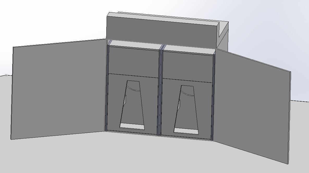

Regarding horn extensions for Keystones, can anyone confirm if this would be the most efficient (db/plywood) configuration for two Keystones? As I understand it, separating the Keystones and using individual extensions for each cabinet would provide even volume across a wider space, but at the cost of ~3db from coupling the two.
Assuming the same frontal area, there will be little difference in the on axis response efficiency of either individual extensions or coupling the cabinets in the center of extensions.
The larger center to center distance using individual extensions would narrow the upper frequency coverage pattern due to off axis comb-filtering, which could be useful or not, depending on the coverage desired.

Using the DSL TH-18 as a substitute for the Keystone, or the BC412 for it's similar extended mouth dimensions to what you sketched would be some models that should be similar in polar response.
