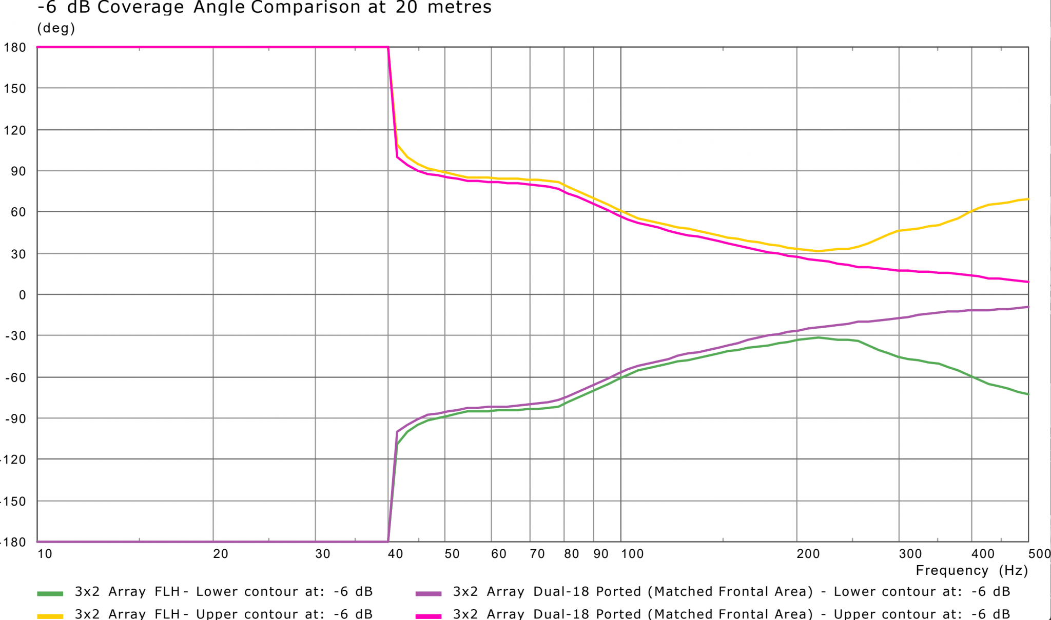

As far as arrays, there is nothing different about tapped horns or front loaded horns compared to bass reflex or sealed enclosures, other than their individual size, shape, and directivity. The upper bass range (above 60Hz) of TH and FLH generally has more directivity than direct radiators with similar frontal dimensions.
Like the Keystone sub, the upper response of many TH and FLH is not axisymmetric, so there is some degree of difference that will be noticed depending on cabinet orientation.
The Keystone sub has very similar frequency and phase response to the DSL TH-118, and is similar in size, if you would like to model various arrays, you could do so using the TH-118 in the Danley Direct modeling software:

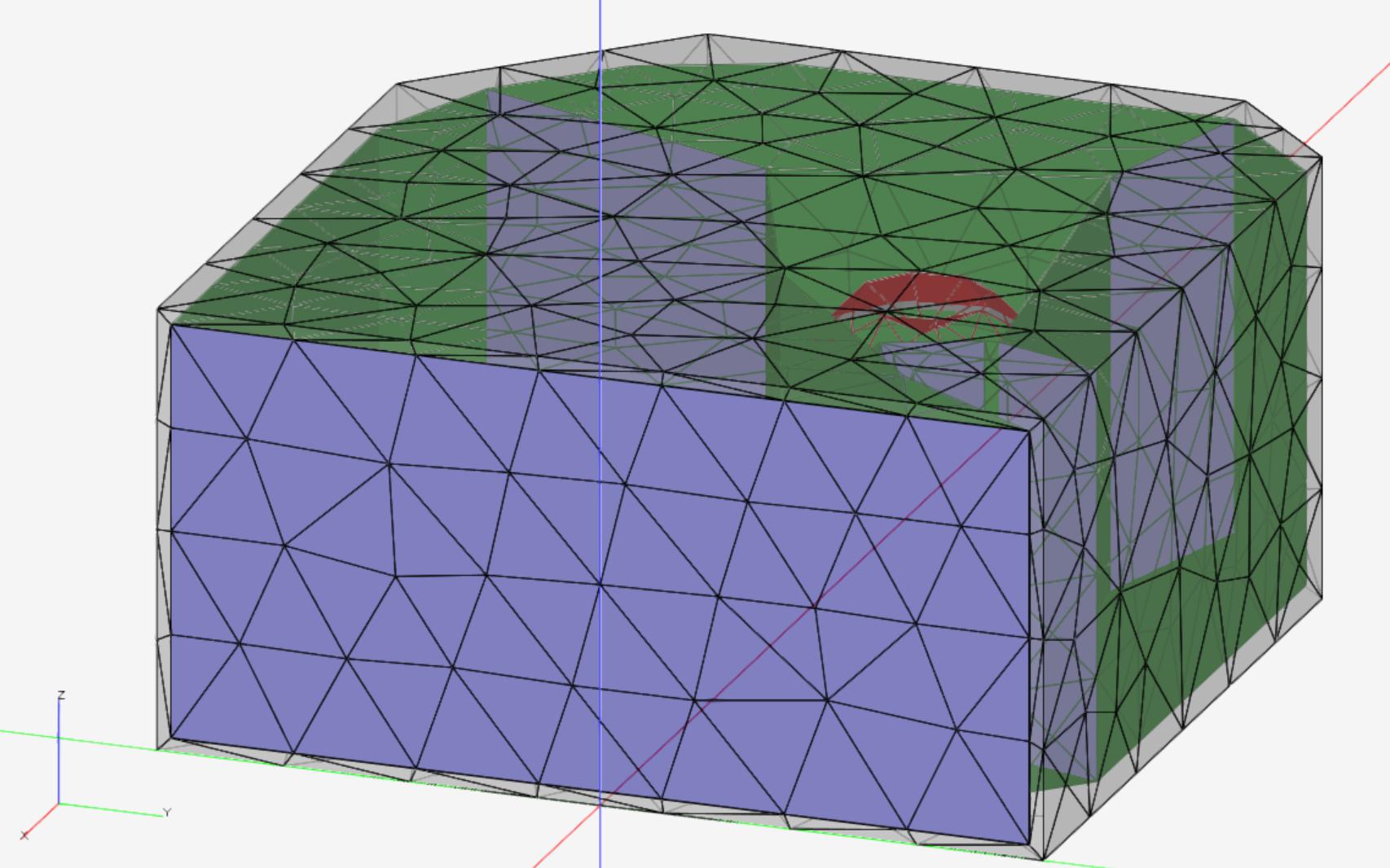

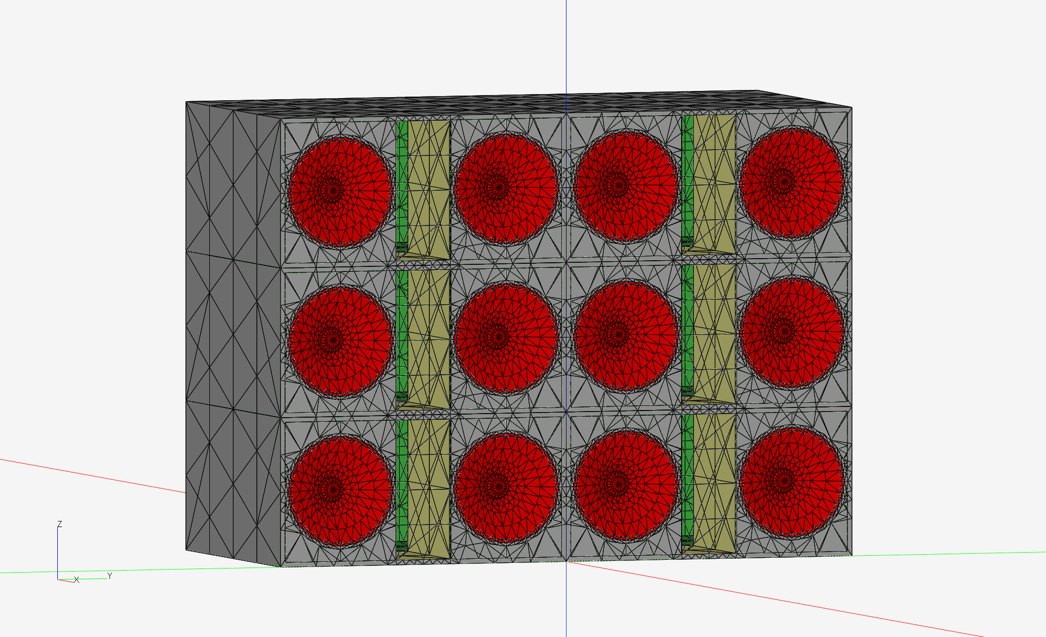

Inspired by one of your posts a while back, among other things, I recently did some pretty extensive numerical modelling (and qualification measurements on scale models) to assess when or if horn subs become 'more directional' than direct radiators. Cutting right to the meat of the results, for an array of cabinets having the same frontal radiating area, there is such a tiny difference in directivity until ka=5.7 that it falls within the margin of error.
I only had enough time and computing resources to run models for full 3D, coupled lumped element and boundary element models of up to 3x2 arrays in ground plane (effectively 12x cabinets, or frontal area of 7.84 m^2), but the data showed the same thing for any number of boxes. Each simulated box was qualified with real-world measurements of electrical impedance, acoustic throat impedance, axial sensitivity and the like.
What was really interesting is that the manufacturer's own 'direct sound' prediction software gave results that became less and less valid beyond this size array, which I found during the validation process. That appears to be because the cabinet geometry isn't included in the modelling; making a simple cuboid and putting theoretical point sources at the locations of the driver centres gave directivity results that matched the more complicated models, without crazy calculation times.
Anyway, the main thing is that for all intents and purposes, if the radiating area is a significant portion of the cabinet front, you can consider subs to be equivalent when making arrays. That means gradient, end-fire, and any other kind of crazy pattern control method should work just fine - that echoes my experiences in the field, doing bass arrays with front-loaded horns and tapped horns. Which is nice 🙂
I haven't done an asymmetrical radiating element like a tapped horn sub yet, as my supervisor had a hard enough time keeping me focused as it was. Considering the wavelengths are long compared to the 'plain wood' front part of the box, and changing the port size on the reflex subs made little difference to normalised directivity, I don't expect to see anything crazy occurring. Always nice to check, though... maybe I'll add it to the 'pet projects' pile.

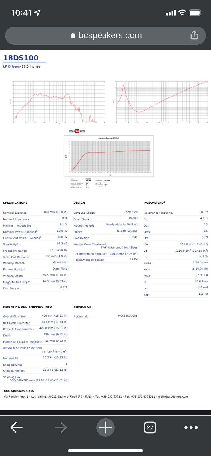

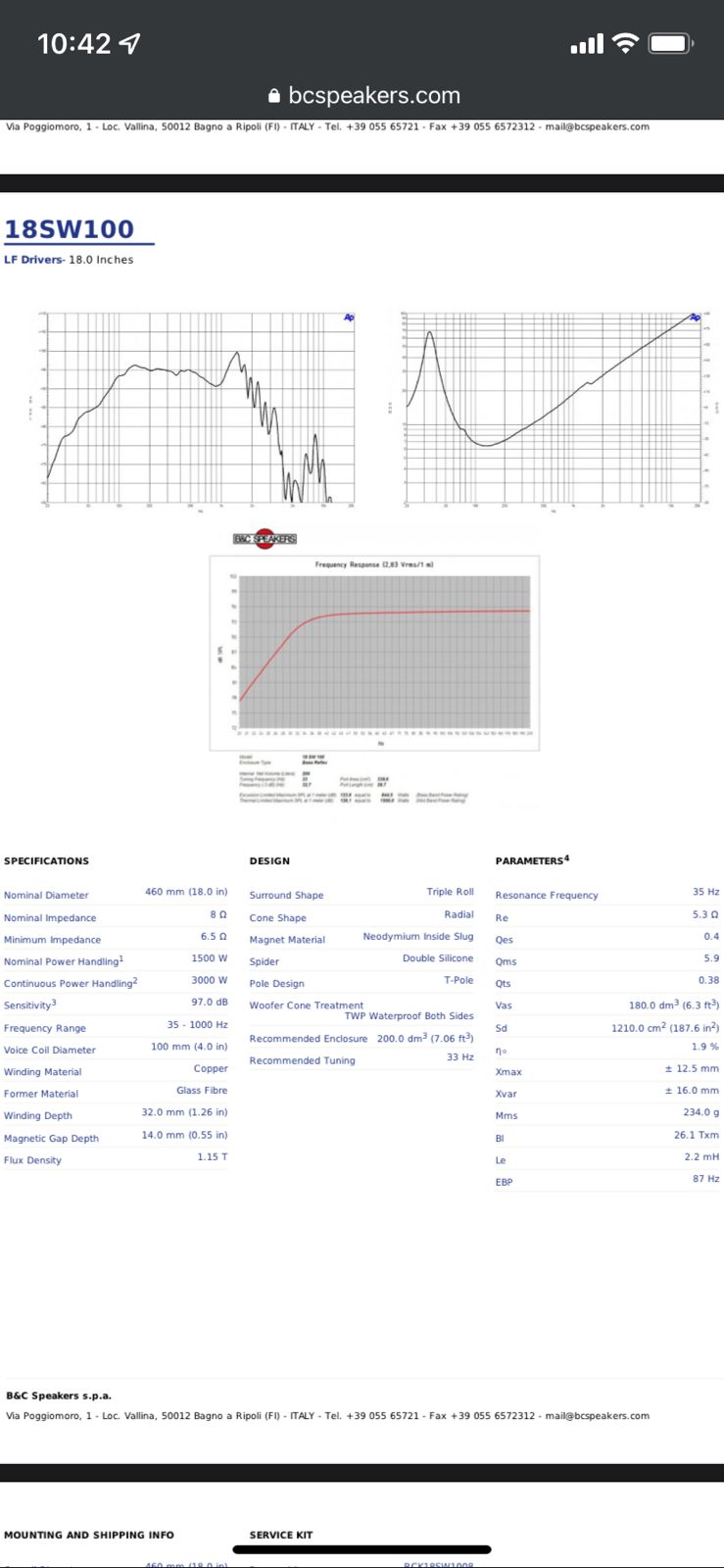

Hello guys, i'm pretending to build 8 keystone in a 2 time project, this year 4 boxes and next year 4 more.
Here in my country i'm not able to buy the 18sw115, just 2 other models that are similar, the 18sw100 and the 18ds100.
Maybe @weltersys or someone else could help me to determine wich one is the best for the Keystone? I'll be using the 8ohms model for better amplification match in the final project with 8 boxes.
I'll be putting the image of both speakers parameteres.
Thanks!

Viniciusv,
The 18sw100 is a bit closer to the 18SW115 parameters than the 18ds100.
I'd suggest ordering one of each and test them in the cabinet to see which performs better, though each could use a different exit size/shape to optimize response.
Either of the speakers could easily use 3000 watts peak, which requires around 155 volts for an "8 ohm" driver, 110 volts at "4 ohm". What amplification are you considering?

I'm tending to go all the way with the 18sw100...
Also i'm considering to go with an handmade amplifier that is build by an friend. It has 14.000wrms tested with continuos sine wave for more than 10 minutes. I know that i'll not get the best audio quality, but is what i have in hands for the best budget. Brazil sucks for buying imported products like powersoft, labgruppen etc...
Thanks Art!
If the 14000 watts is divided between two channels, that's 7000 per, so 1750 per 8 ohm speaker.
If the amp has 3dB more peak power than continuous, that's plenty, otherwise I'd still go with 4 ohm drivers.

With regards to the the SW100 range for a tapped horn, I’d suggest getting the SW115 if possible. Due to a mix up, my business partner ordered four of the SW100 for some 21” tapped horns we were using for a run of festivals, and they were clearly struggling compared to the other SW115-loaded boxes.
