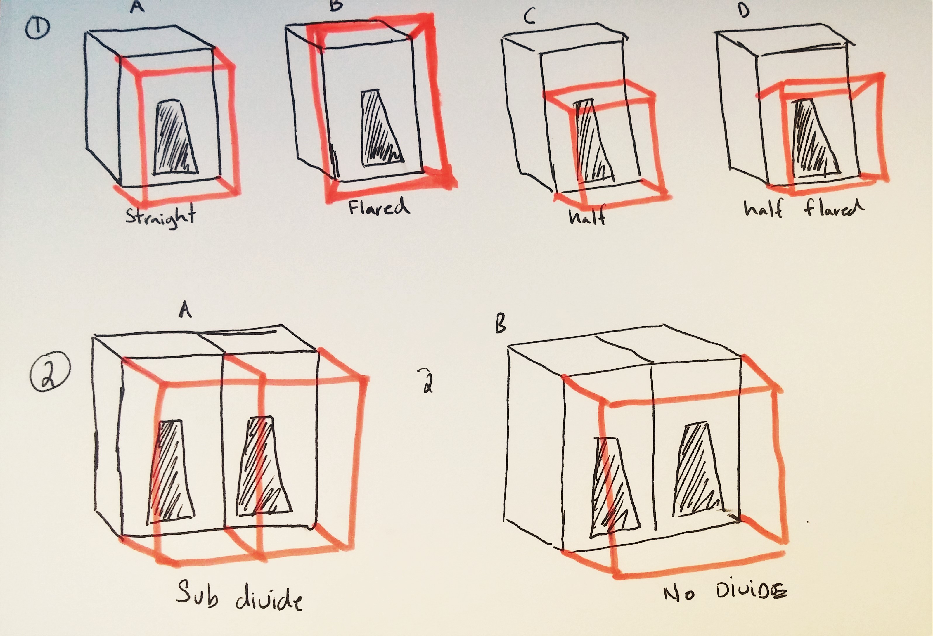

I have looked over the horn extension pages and have a few questions. Hopefully the rough sketch attached makes it easier to answer.
1- what is a good length to extend the cabs?
2- does it matter if they extend 90 degrees or should they flare out like a wave guide?
2A- if waveguide - what angle?
3- do they need to extend from from the top? or if it's equidistant from the top of the keystone exit to the bottom of the keystone would a mid-height work like in figure 1C
4- I have not decided how I am going to arrange the subwoofers. They will either be 2 per side with the mains sitting on top of them - or 4 lined up in a center cluster and figure out something to set the mains on. If all 4 were lined up in a center - would one large mouth extension work? or should they include subdividers between every driver?
Last year 2 went to the burn - this year it will be 4 🙂

Bjones,
1) I have neither built nor modeled any "horn extenders" as depicted in your sketches.
If you are looking to extend the horn, it would be best to match the Keystone exit shape. Extending the horn will lower the low corner frequency (Fb or Fc), but also will lower the upper null frequency, which may be a problem if your tops can't handle a lower crossover frequency.
2) The "flare" should be equal or greater to the cross sectional expansion of the latter portion of the tapped horn.
2A) The wave-guides I used with the Keystones were designed to match the 90 degree dispersion angle of the Paraline top cabinets. Just using the lower 56.25" portion of the wave-guide increased low frequency forward output by an average of 3 dB. I never did measure the gain using both portions, but I'd say it was better than 4 dB- the 28 eight inch horn loaded drivers clipped (ran out of headroom) at the same SPL as the pair of Keystones. The ten 3" diaphragm HF (high frequency) drivers were also near their headroom limit, but much of that was due to the unusually severe HF air absorption typical in the hot, dry environment of New Mexico.

3) No.
4) Mains at 45" above the deck? Guess you don't care about projecting very far, or about deafening those near the stack. Of course, with enough drugs, nobody notices hearing loss...

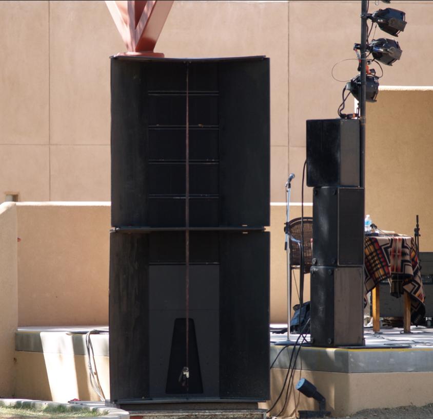

Unless you model whatever you plan, and like the results, I'd suggest doing wave-guides as pictured below.
Double stacked, the Keystone/wave-guide combination would be a good platform for top cabinets.
The box directly above the Keystone in the picture below is a 4x8", the lowest HF driver is 76" (over 6') above the ground.
Normally, the cord box the center fill cabinet is sitting on to the right of the stack would go below the 4x8" cabinet, raising the lowest HF horn another 11.25", but that extra height made putting tarps over the stack at night (or during monsoons) difficult. That said, I now use PVC "goal posts" to lift the tarp over my SynTripP tops (over 10' high), much easier than climbing a 10' stack with a 25' tarp in a hand with only 2 fingers ;^).
Art

Sorry Art,
I guess I am using the wrong vocabulary.
the tops are JBL 722's - which don't really have output below 77hz. The horn HF driver would be around 8' with the 2 12's below. I have no mid box. I currently run the xover at 100hz. It sounds to me like I might be talking about dragging a lot more plywood to playa that won't yield much of an spl increase if I do it wrong - and it seems that's the track I am on.
Then change tracks 😉 .
Wave-guides like the ones I built yield 3+ dB increase in output.
That is like doubling your amplifier power with no power compression.
Another way to look at it is you will draw half the power compared to without, half the generator size required, or about half the fuel consumed.
Between the wave-guides and doubling your speaker and amplifier count, you will hear about a 10 dB gain from last year, more than twice as loud.
