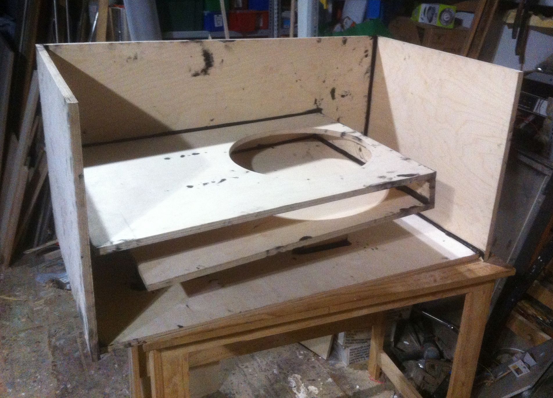

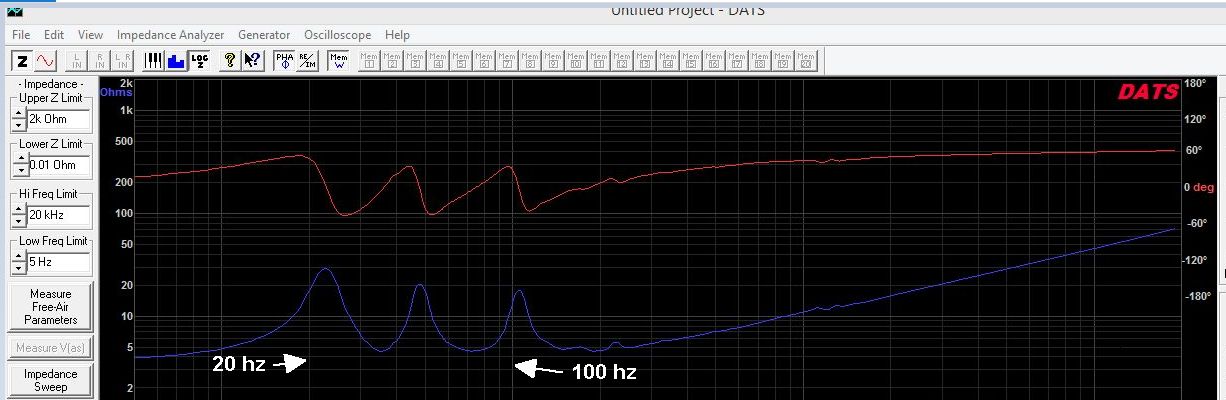

Keystone Impedance
Keystone Impedance via DATS v2.
B & C 18SW115 - 4 ohm
One side panel not glued yet, only screwed together. Keystone panel without any bracing added (all other bracing is to spec). High-grade 18mm Birch Ply (heavy). The cabinet was made prior to the updated dimensions some time ago? -I believe Art mentioned there wouldn't be much difference in performance ?
Nice one Art !

Sounded really good in the low end for deep/heavy bass music
A bit muddy for more classic techno and house
Maybe its a question about to lowcut a bit higher around 40hz/50hz???
Gonna have a test with the 2 boxes next weekend in a party in a similar room of 5mX7m (also gonna do some measurements there)
Any idea of what would be the best position for optimal output/sound/less bass cancellation.
2 keystones together in 1 corner?
Or 1 in each corner?? or any other ideas???
Any inputs appreciated... And if someone is up for making a SIM with these drivers... Would as well be highly appreciated.
