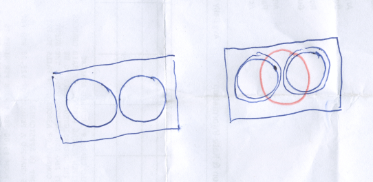

I am planning to build some of these soon in using the 2xLab12 configuration but after reading the whole thread i haven't been able to find any photos or schematics showing exactly what the adapter mentioned in #1 looks like in relation to the original design document, if anyone can share photos/details it would be greatly appreciated.
Levi,
I used a 2x 12" adapter plate over the existing 18" cutout, the 12" cut outs centered horizontally over the 18" cutout (depicted in red below).
If you don't plan on upgrading to the B&C 18" in the future (strongly suggested if you want maximum SPL), just cut the 12" cut outs in the baffle.
