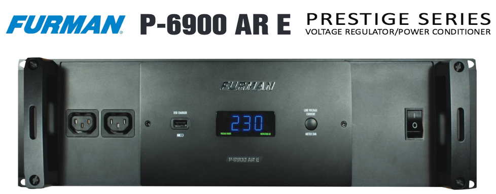

For A/V professionals, a regulator must be rack mountable for easy transportation, it must be stable even when subjected to distorted AC signals from poor generators, and it must be able to handle the high current demand of large power amplifiers while protecting all connected equipment with non-sacrificial transient surge suppression. The Furman Prestige True RMS Voltage Regulators will provide you these benefits!
Lightning surge protection is not voltage regulation.I must admit I don't know much about this, but I was recommended power conditioner for this use and this is what people use them for.

If you want voltage regulation, you have to pay the price for voltage regulation, a product like Furman's P-6900.
Personally, I'd put the money towards a bigger generator rather than a voltage regulator.

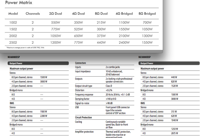

Well after considering everything here, I think I am going to go with the new Crown XLS2502.

The NU6000 has more than double the output of Crown XLS2502, is lighter, and cost $210 less.Well after considering everything here, I think I am going to go with the new Crown XLS2502.

Unless I am missing something I see:
Behr = 2200w rms
Crown = 2400w rms
Just to be clear, I am comparing 2 Crowns to 1 Behr so the cost difference is $770. The benefit being redundant amps, as I type this I realize I could buy a second NU6000 for less and literally just keep a brand new amp on stand by and still come out cheaper.

You are comparing the wrong figures, the Crown's 1kHz output should be compared to the NU6000 maximum output of 3000W.Unless I am missing something I see:
Behr = 2200w rms
Crown = 2400w rms
Even if you don't want to believe that, the difference between 2200 and 2400 watts would be inaudible (a fraction of a dB), assuming the XLS2502 current limiting sounds as transparent as the NU6000.
One side of the NU6000 can deliver more power than the bridged XLS2502. With two NU6000 you would have more than four times the power and save around $420 over a pair of XLS2502.

Both the NU4-6000 and the NU-6000 are two of the NU3000 in one chassis.I think I am going to go with 2 NU3000DSP units. (Isn't the NU4 basically 2 of these in 1 chassis?)

Because the NU-6000 is already two amp channels internally bridged mono per side, it can't be bridged mono in to any load.
