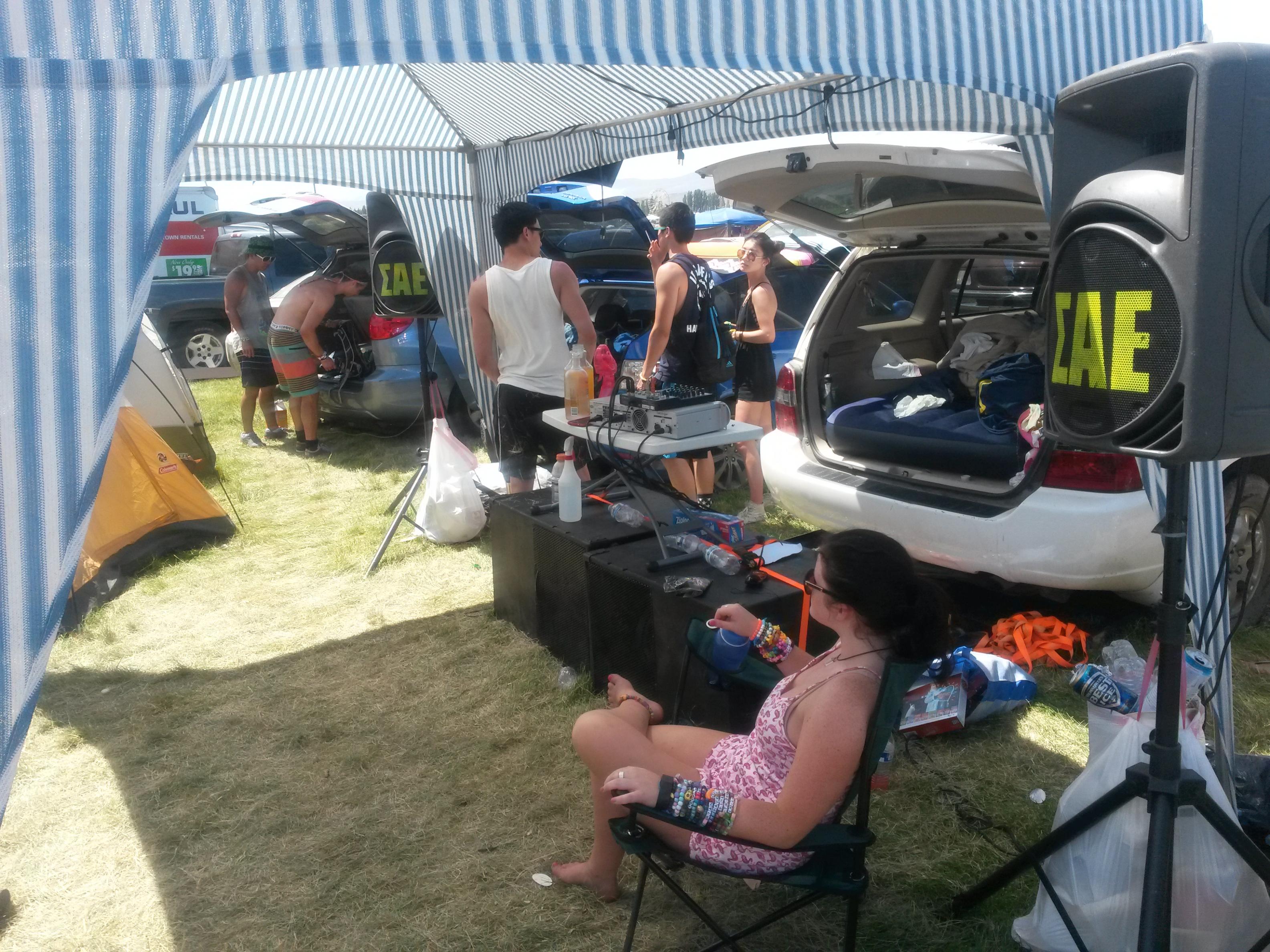

I was running a NU3000dsp off a Honda EU2000i at a festival and trying to milk every dB of power I could get out of the system. The iNuke seemed much more eager to trip into protect mode at the limit of the power I could get out since both the amp and the generator were struggling, but if you turn it a bit down from that point it seemed to work well enough.
You said festival 🙂
What type of music were you playing? It's hard to get good feedback of what sounds "good" and what is "enough" when seldom do I hear the music played back. If I just needed to output some rock 'n roll - I wouldn't even be overthinking this. Wedding DJ's - just playing the hypercompressed pop hits with some old school "hey I know that tune" isn't the type of environment I will be in. More like blinky lights, fire spinning, house/trap/bass dance until sunrise environments.

Yep, up at Paradiso Festival.
Trap, Dubstep, Moombahton
Lots of stuff like Baauer, RL Grime, Excision, Dillon Francis, Bro Safari, Zeds Dead, DJ Snake, Flosstradamus etc. Yeah real hard on the subs. Going into two 4015lf drivers in the modified lower tuning SS15. Had 2 Mackie SRM450s for tops.
Keep in mind this was just in the campgrounds for a commercial festival. We weren't running an actual stage or anything but during thursday night before the festival proper we were DJing and had a good number of people coming through to dance, drink, or just see what the commotion was about. Even with that modest setup we probably still had the most bass out of any campsite and the tops were cruising at moderate level.
Sure as hell beats the other campers who think they're clever bringing PA on a stick out to the campgrounds and turning it up to shrieking levels
