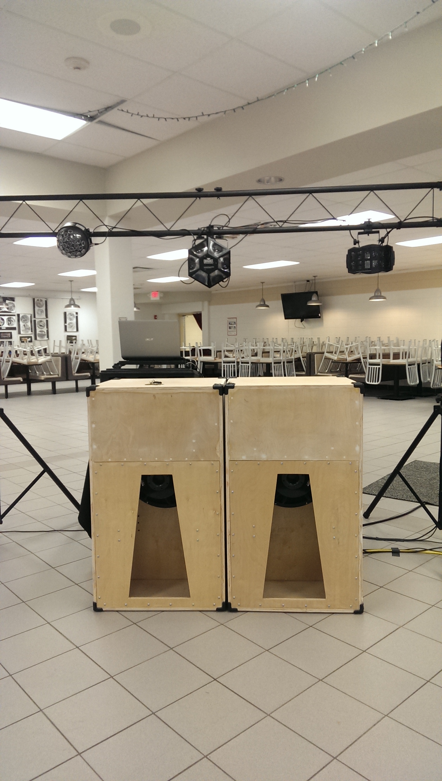

Chris, I wish I could say I got this figured out but I don't . So I'm gonna use my DCX2496 to set rms limit and threshold for the 18TBW100-4 along with the crosssover curve . Right now I have the crossover at 30hz hpf with BW24. And 100hz lpf and I'm thinking a BW24 as well. I am trying to set the rms limit to 50v and I believe a threshold of 5db . Then I believe I need to set my standard BR tops on a 8ms delay to match the timing of the keystone sound. My understanding is to set the rms limit on crossover , I need to use a voltmeter and adjust it from there using the limiter db control. I am not sure on the attack setting. Have a dance tomorrow night so kinda sweating out the details right now.
Ok. So first gig report with the keystones. I set up for a high school homecoming dance . I was told at the door they sold 500 tickets and may be another 50-100 that showed up at the gate to get a ticket . As I have said in previous posts , mine are loaded with 18TBW100-4 speakers. I limited the keystones to 50v per the recommendation here, hpf at 30 and lpf at 100 being pushed by a inuke 6000dsp. I crossed my mid tops to pick up at 100hz on up and had a BW24 slope where they met. I warmed up the subs during setup for a little while on low voltage . When I finally did some real volume sound checks I couldn't stop smiling. The bass coming from these were crisp and clean . They filled the room with low frequencies and I was pumped to show the kids the new sound . The keystones btw did not vibrate or have any odd buzzing either so the build is tight and solid with the bracing . I did not get a spl tho so this is seat of the pants sound results. Having done their last 8 homecomings I know positively the keystones were at least twice as loud with bass as my prior 18 BR boxes and much deeper in the sub 50hz range . It made me realize what I've been missing all these years . I will post some pics tonight. Btw, they are heavy as hell and don't forget the cart. Lol

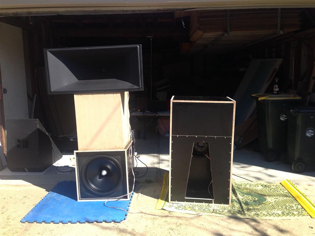

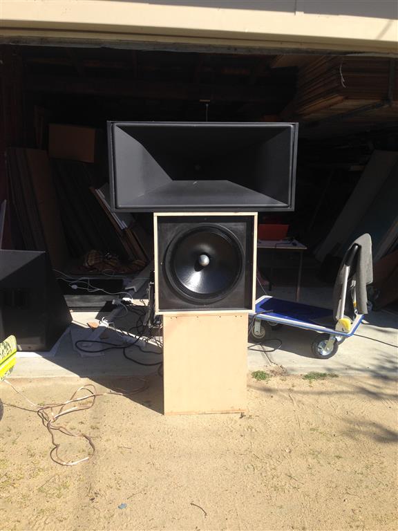

So finally finished my Keystones, although they are not painted yet. Spent Sunday measuring the responses of all my speakers and setting the crossovers on the Synergy Horn (from 350hz up), the sealed TH18H+ ( from 80hz to 350hz) and the keystone (from 35hz to 80hz). The Keystone was very flat from 38-150 and didn't need any EQ.
I only had 1 of each speaker out so no photo's of the full system. I'm doing an outdoor party in a few weeks so will take some shots then.

LOL.....I see you typed TH18 and was think......WHAT. BUT Then saw your pictures and your using a TD18H+. NIce
Yeah I always mistype that...and being a Monday it's even harder to get right.
