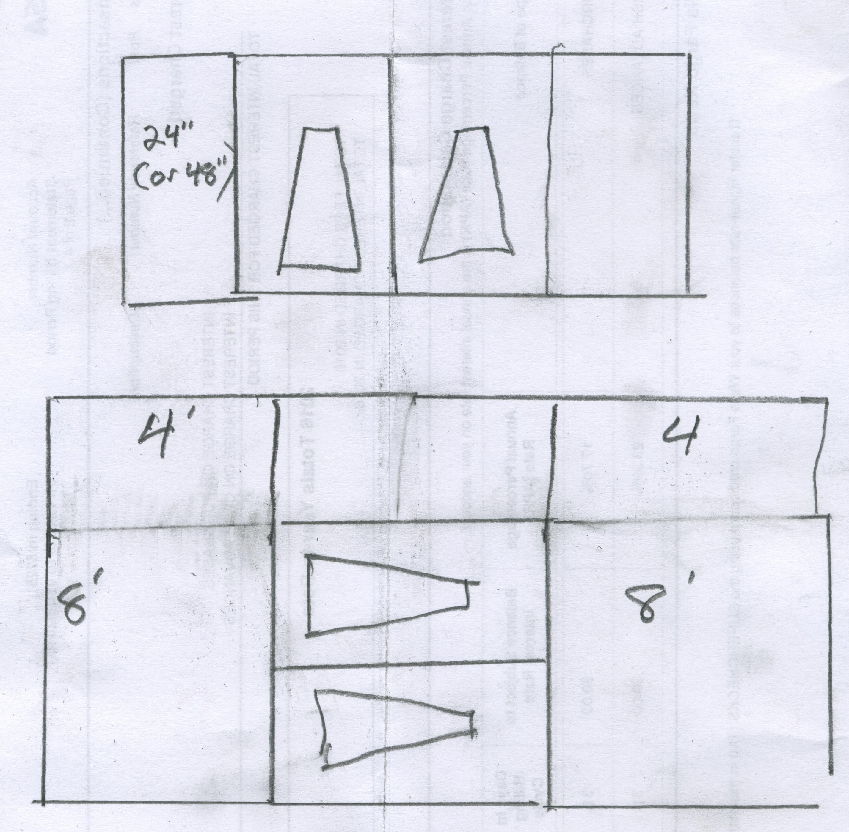

Would you lay the keystones down and place them in pairs at 90° angle for the v-array you mention? Would this also increase horizontal dispersion
Actually I only have two for the moment(8 ohm drivers), but I have an amp that can push two more so I'm tempted on two more some time in the future and try the end fire configuration:)

Would you lay the keystones down and place them in pairs at 45° angle for the v-array you mention?
I would be more inclined to place them upright to take advantage of the additional forward gain the vertical array would have compared to a horizontal placement. That said, a horizontal array with a "V" wave-guide above could be awesome. One could experiment with the angle, although 45° would certainly work, it may not be the optimum for forward gain, or smoothest frequency response.
The physical distance between the Keystone acoustical centers will be different in either horizontal or vertical arrays, and the "V" angle will also affect distance from front to rear, so different delay times will be required. The addition of wave-guides will also affect optimum delay time for rear cancellation due to the longer rear path length to go over the guide.

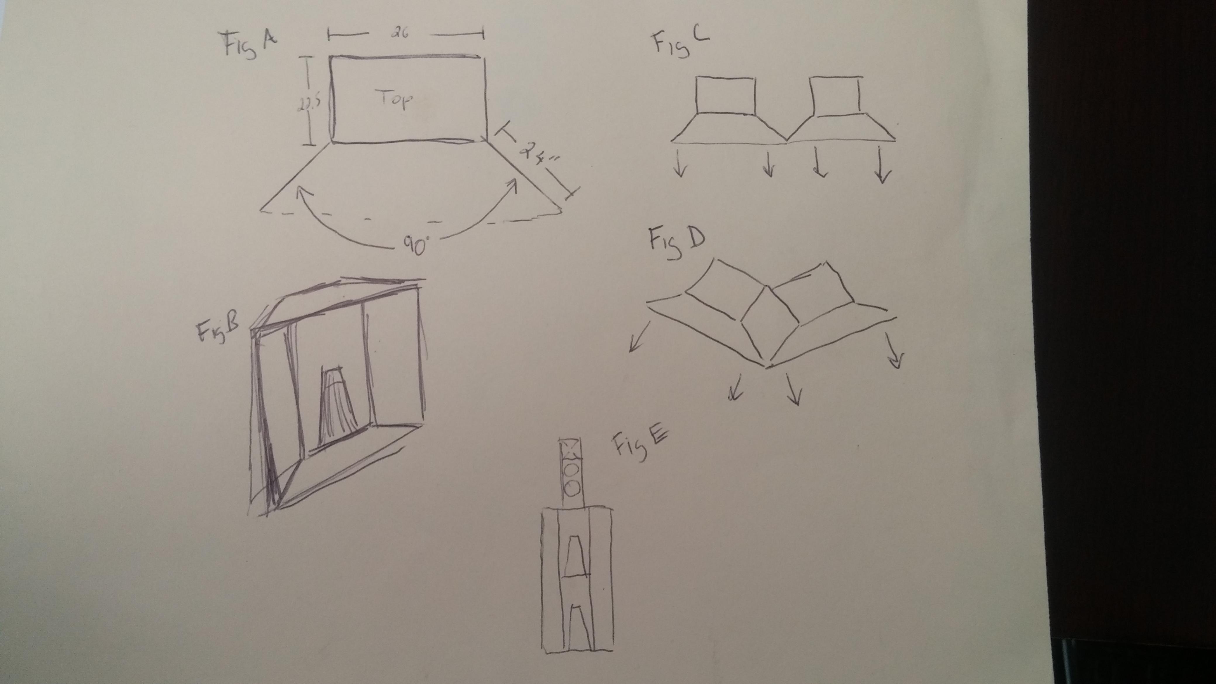

Good morning Art,
Becuase I have only a day or so left to complete the wave guides, hopefully you can give me "just enough" and I can delve deeper when I return.
Fig A - Because you know the exact subwoofer I am using, rather than tell me how to get to the proper dimensions, could you provide either confirmation that the ones I have will work, or ones that will. Based on Fig A - each side is 24" wide with a 90 degree horizontal (I planned on using 1/2" for this)
Fig B - poorly drawn perspective
Fig C- I really don't know how combing works on low frequency and realize that these guides overlap -
Fig D top down view with the subs angled as I would if using multiple narrow dispersion mains
Fig E - I feel like this stack is what you were saying would be ideal - i could match all the horizontals up however, I think it will be taller than the structure its going to have over it - also there are other camps close and the goal isn't to project the sound as far as possible with even spl coverage, but more create as much sound in a 100' x 50' area - in this case having bodies absorb the sound is a plus which is why I was keeping the stack under 9 feet with subs side by side
If I am way off - maybe just a "90's to wide use 60 degrees and they need to be at least 30" I know this is over simplification

Mr. Jones,
1) The wave guides I was using were 90 degrees because the top cabinet horns were 26.5" wide, and 90 degrees.
Functionally, at low frequencies, whether the "wings" or "barn doors" are parallel or angled to the cabinet makes little difference, the larger boundary area is what increases forward directivity, and therefore gain- the 3 to 6 dB that would wrap around behind the cabinet goes forward, just like if the cabinets were mounted in a wall. There is no reason for you to make wave guides, you could simply use pipe clamps on the top and bottom of plywood.
2) I don't recall the exact sub woofer you are using, but barn doors or wave-guides will work with any cabinet design equally well.
3) The vertical stack is optimum for not wasting your sub SPL on birds and gyrocopter pilots. If it is too tall for the venue, try something along the sketch below. Bodies absorb very little <100 Hz output, unless they are actually pressed up against the Keystone exit, in which case, pry them away.
4) It is so simple you have missed the point. Make the boundary as big as you can afford to, and you will get more gain, to a lower frequency, topping out at a theoretical maximum of +6dB.
Stand the plywood up, screw it to the cabinet front, done deal, Day-Glo paint is optional.
My tests indicated a +3 dB at 36 Hz to +6 dB around 160 Hz with only doubling frontal area. A +6 dB gain down to to 36 Hz (or as low as any sub can go) requires an infinite boundary ( a 100 mile long and deep cliff), so there is obviously a point of diminishing returns, there really would be no reason to go wider than the lowest wavelength reproduced even if you could afford to lug and erect that much plywood.
Don't cut off any more skin!

Art, I can't thank you enough. Talk about missing the forest.
Last question for now than is - 1/2" ply with some 2x4 beams ran across the back is my plan.
Obviously, flex is bad. How bad? I want that rear sound wave to reflect and not absorb and I know the second that ply flexes its absorbing.
Since there are no other "walls" to create pressure it cant hit with too much force, but I imagine constant vibration.
I want to avoid time/cost/energy to have something end up soaking up sound energy - so if I need to spend/do a little more to reinforce the crap out of it let me know. Otherwise Im thinking 2 8' studs on edge ran across the back and screwed in to prevent excessive flex.
