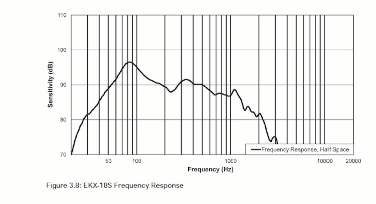

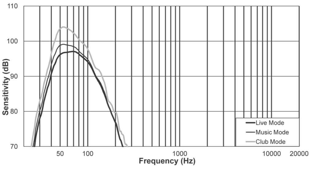

Which model EVs were those? The ELX118Ps?
Your observations aren't unexpected - what most people consider as "bass" lives above 50 Hz, and if your EV sub is a "B6" alignment that basically boosts the low end around Fb a bit, the result can be a smaller box that gets low and actually sounds pretty good as well.
...until you hit lower frequencies and realise that where the EVs stop giving any more output, the KS just keep going and going 🙂. And, you can probably try a "B6"-type EQ on the KS a little around Fb as well (last time I looked at the sim, Fb was below the passband) to further increase its LF output.

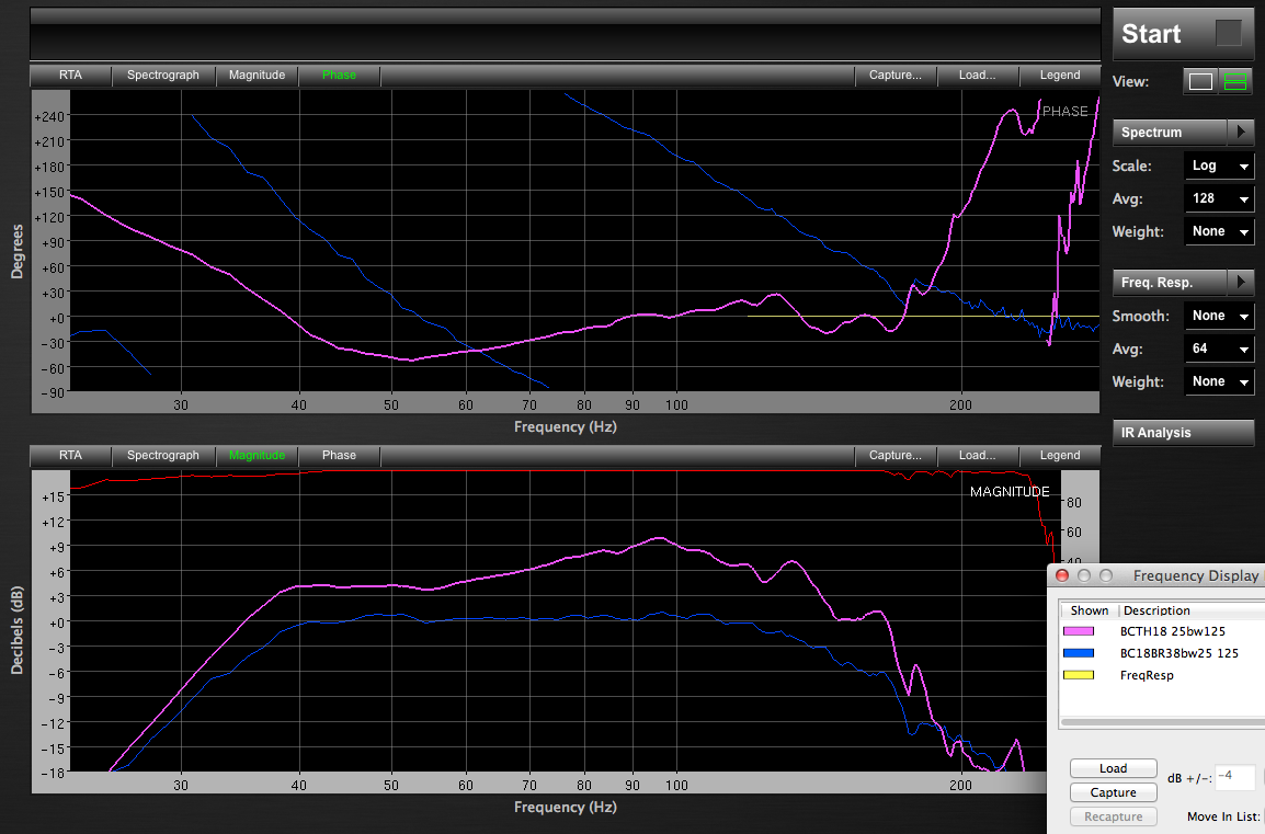

The phase response difference between the cabinet types would be minor compared to the comb filtered response resulting from the subs 30 feet apart, outer cabinets delayed.
Below is the phase and frequency response of the Keystone compared to a bass reflex with the same low corner and driver, both have BW24 filters at 25 & 125 Hz. As you mentioned the EV subs are probably tuned higher, the phase response would be even more divergent.
That looks like a pretty big phase difference. If I'm reading the graph right, it suggests that they're totally out of phase near 100 Hz?
I believe that the EV sub spec quotes -3dB @ 42Hz. I'll bet that's right where Fb is, if this is a powered sub.
BTW - the phase response of the KS in its passband looks impressive.
