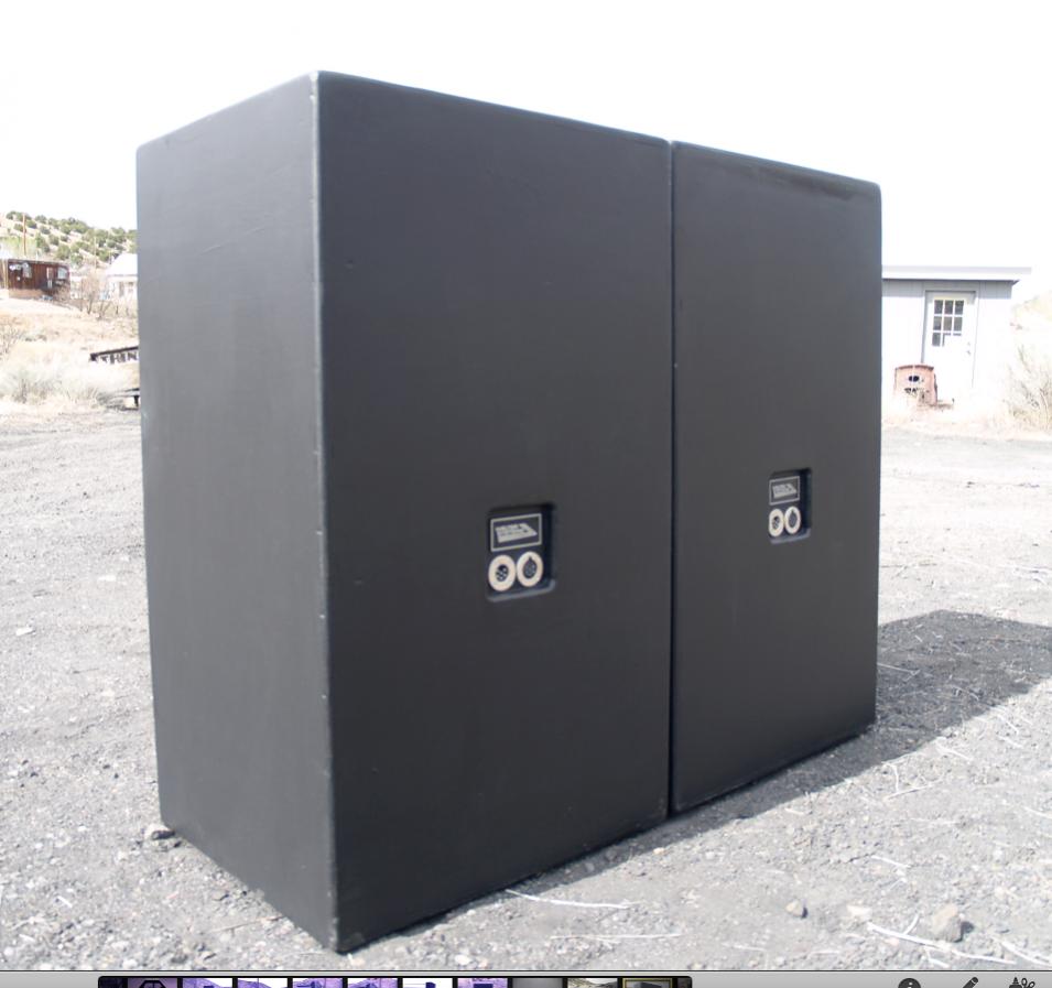

Quick question. What is the best way to route the speaker wire internally? With that being said, where is the best location to install the Neutrik Jack? Thanks .
"Best" would depend on your usage, if you want to have the cabinet pushed up flush to a wall, the connectors can't be on that side.Quick question. What is the best way to route the speaker wire internally? With that being said, where is the best location to install the Neutrik Jack? Thanks .
I mounted the connectors on the back of the cabinet between braces J & K, the wire runs up part H, over G, and along M, stapled and caulked in place.
Art

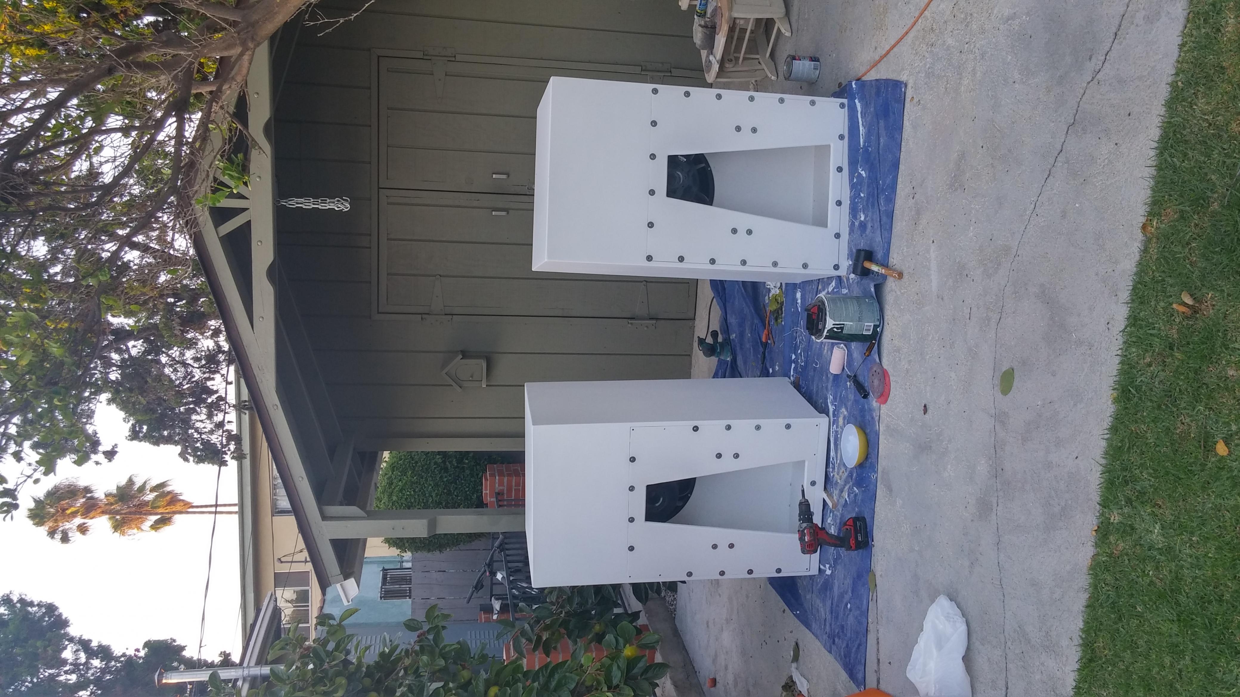

Almost ready. One is going to get strapped to the roof 🙂 and off to the playa they go for punishment.
How did they do?
-Kelly

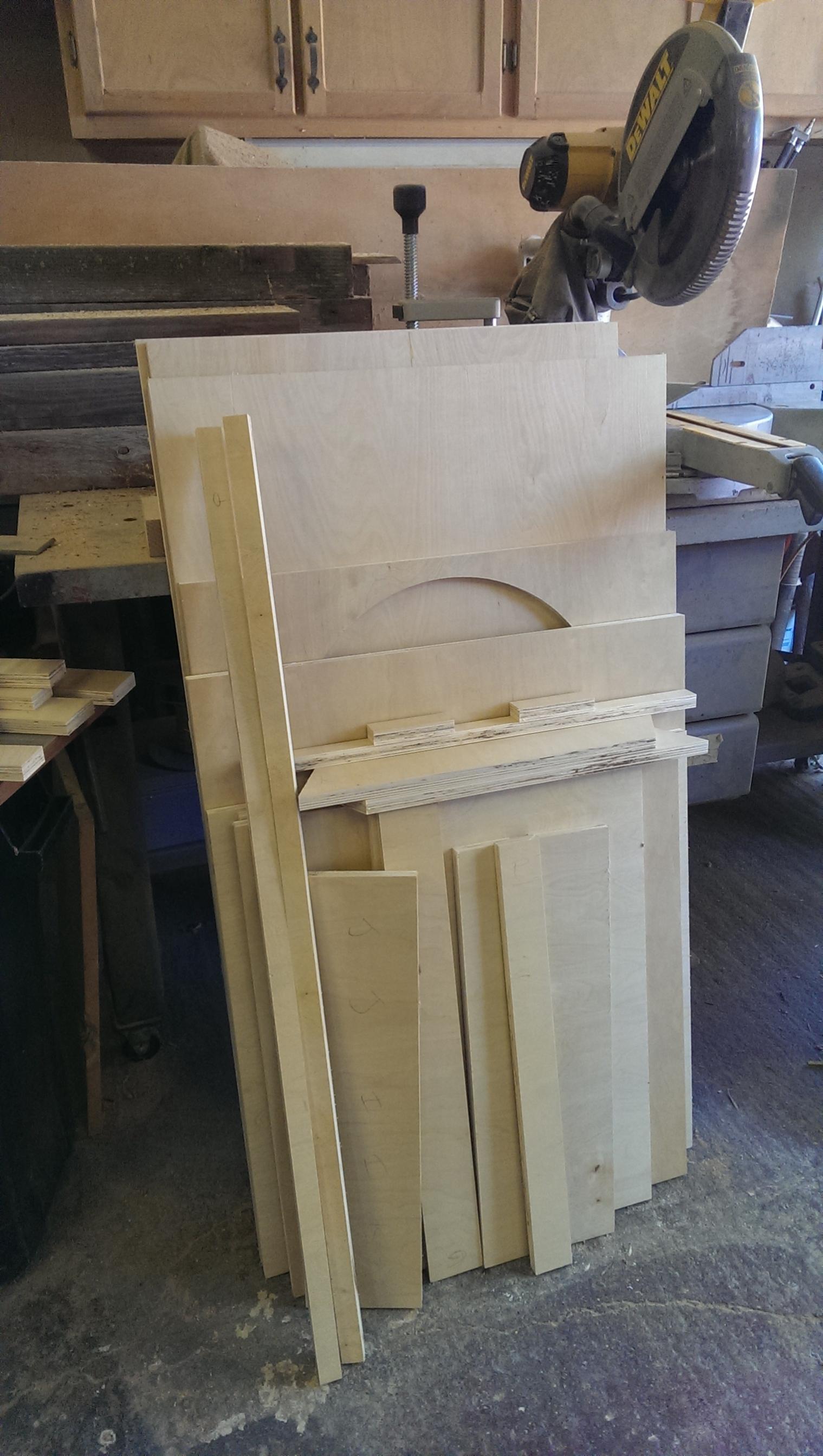

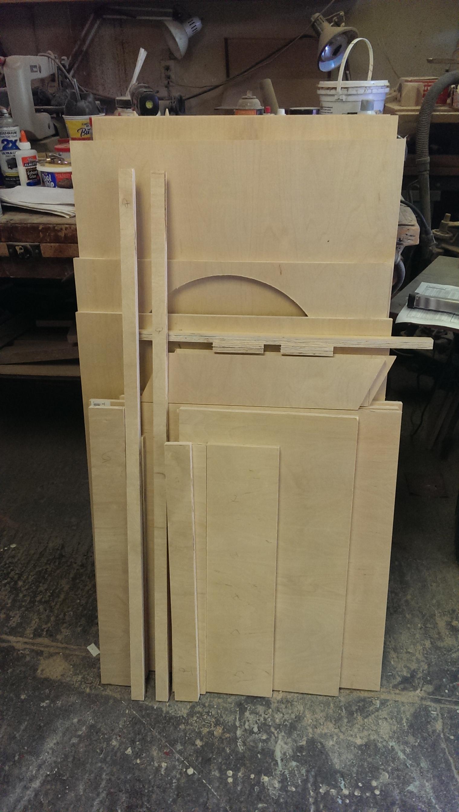

Made a bunch of sawdust today. Got all the panels cut , the baffles done, and all the braces cut to proper width, but waiting till assembly to cut their final lengths and angles for tight fit. Speakers will be here tomorrow. I am debating between screws and crown staples for panel assembly. I have always used screws, but see a lot of cabinets are put together with crown staples in lieu of screws. i suppose the screws would draw the panels tighter. Thoughts on that?
How did they do?
-Kelly
They did really well. We ran the 2 KS up front with the JBL mains on top and then a second delay about 30' back with 2 EV 18's and some MSR tops.
Honestly, considering that the EV's were half the size, half the weight, and had about half the RMS power in their built in amps, they were very impressive. I was hoping the KS would have tromped them a bit more. Sonically, the every DJ complimented just how great everything sounded. The end of the week we had a small party where only the KS and JBLs were playing so everyone really had a chance to hear the KS. The DJ's all praised the clarity. Output wise, I think they paid $600 each for the B stock EV subs. Each KS was around $500 without an amp (we used a 2500 watt amp on each KS). Once you factor in your time, the DIY approach really better be something you enjoy, because logistically those EVs impressed me. However it was Burning Man and the fact that the KS were hand built and brandless left everyone really happy. The veteran DJs all agreed the dance floor never sounded so good, and it was the first year we had to interrupt the parties on 3 different days to have people move their bikes from blocking the road it drew in so many Burners.
