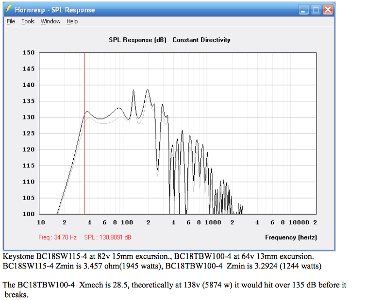

Osse,Would it be sufficient to give two 18tbw100-8 loaded keystones a run for the money per side of the iNuke 6000, giving each cab approx 900 watt each? Could end up a cheap solution reaching around 140 dB capability.
Or would it be safer to use 4 ohm drivers and one a side?
The iNuke 6000 is 3100 watts at 4 ohms. The four ohm speaker would see 3 dB dB more level than a pair of 8 ohm drivers (each 8 ohm driver would get 1550, not 900 watts peak), so would have the same output as the pair, less perhaps 1/2 to 2 dB due to power compression, depending on the dynamics of the program material.
The pair of 8 ohm speakers sharing the power would be "safer" than a single four ohm driver getting twice the power. That said, with proper average limiting, 3100 peak watts should be no problem for the B&C 18TBW100-4 (or 8).

The iNuke was measured to 1800 watt continuous(I think) in the 33% duty cycle test, behringer claim 3100 watts which should be peak power afaik.
I didn't write 900 watts PEAK, but each.
would 1550w peak be enought for techno music with a crest factor of around 4.5-5.5? I looked at two typical songs I'm playing with the voxengo SPAN plugin and when resetting the crest factor and letting it play for about half a minute during the bassline that was where it landed. Is peak power capability as important in low crest factor music as with "live" music? I guess LF peaks won't be as substantial when the lows are squashed in EDM for example.
What makes me think it could work with one iNuke 6000 with four TBW100-8 is that AFAIK the lower the crest factor, the more important to distribute the high RMS energy over more VC's.
Zwiller claimed in #387 that the 18sw115 would reach xmax at 1000 watts(the tbw likely less than that) which made me think this approach might be viable and desireable with low crest factor music?
1) With the power compression likely with that low a crest factor, another 3 dB of peak power won't make much difference.1)would 1550w peak be enought for techno music with a crest factor of around 4.5-5.5?
2) Is peak power capability as important in low crest factor music as with "live" music?
3)What makes me think it could work with one iNuke 6000 with four TBW100-8 is that AFAIK the lower the crest factor, the more important to distribute the high RMS energy over more VC's.
4)Zwiller claimed in #387 that the 18sw115 would reach xmax at 1000 watts(the tbw likely less than that) which made me think this approach might be viable and desireable with low crest factor music?
2) No, about 9 to 20 dB less important.
3) Yes.
4) The B&C 18SW115 requires 82vto reach Xmax, at most frequencies several times more power is required to hit Xmax. The B&C TBW100-4 requires a bit less (64v) to hit it's lesser Xmax.

that is quite a substantial difference between the tbw and sw115, 5 dB at 90 hz, around 3 dB at 40 and a few hz lower f3, looks like a pair of 115-4 driven by the iNuke could put out sufficient spl to not stand shy compared to four tbw100-8 driven by one iNuke aswell, also due to increased peak output. especially if coupled with your waveguides from the other thread one might experience close to equal performance
wouldn't the processor unit need two limiters, one for peak and one for rms to benifit from the increased peak spl capabilities?
1)Perhaps you are looking at the graph thinking those are 10 dB between the lines, the difference is only about half what you suggest, and the 18SW115 requires quite a bit more power than the 18TBW100 to get to that level, as the 18TBW100 ha a higher sensitivity.1)that is quite a substantial difference between the tbw and sw115, 5 dB at 90 hz, around 3 dB at 40 and a few hz lower f3, looks like a pair of 115-4 driven by the iNuke could put out sufficient spl to not stand shy compared to four tbw100-8 driven by one iNuke aswell, also due to increased peak output.
2)wouldn't the processor unit need two limiters, one for peak and one for rms to benifit from the increased peak spl capabilities?
2) Yes, though for EDM I'd be more concerned with RMS than peak.

Yes you're right, I read 10 dB steps between the lines. The extended LF response is looking really nice on the sw115 tho, and if the iNuke can drive it to it's thermal long-term limit in the KS I could see the ~150$ difference between them justified
