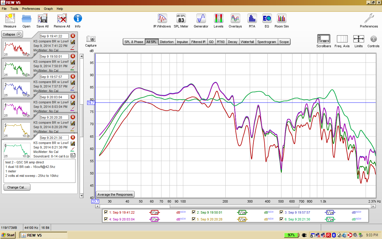

Gave another try with REW....

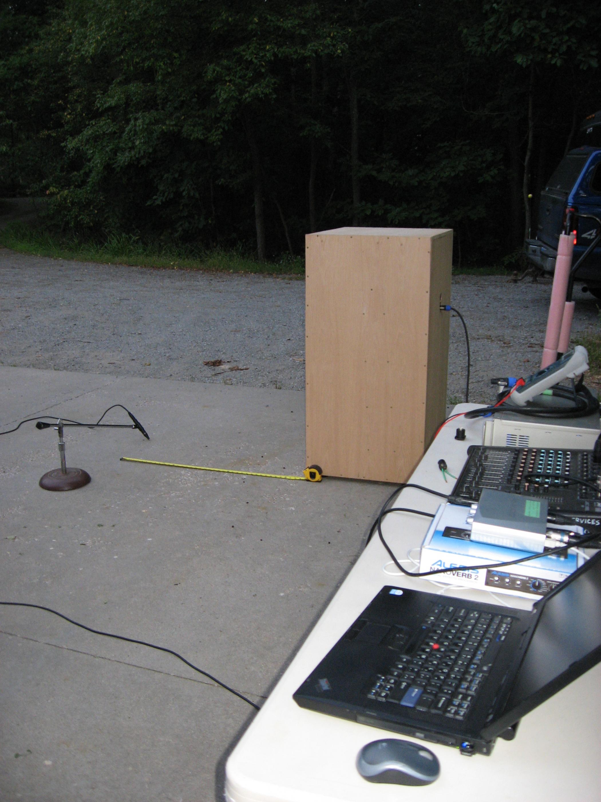

2 volts @ mid sine sweep – 25hz to 10khz. PVR1 mic, ground plane @ exactly 1 meter, on axis into M-Audio Mobile Pre USB into QSC SRA 3622. No HPF or LPF applied. 5.2 meters from any structure. All drivers are Peavey Low Rider 18s.
Red = 1 KS
Green = 1 dual 18 BR – 16 cu.ft. at 42.5hz
Purple = 2 KS
Red = 1 KS
Purple = 2 KS

It will give you more acurate results, when you lie the mic directly on the ground.
(see 'ground plane measurements')

I will re-check available info......I have always placed mic at roughly 45* angle to ground at < 1/16" to surface. I got his practice from posts/photos I read years ago on PSW forums from some pretty sharp folks....never thought to question it.

Your measurements in post # 323 look much more like I expected, if you used 2.83 V (one watt at nominal 8 ohms) for the single Keystone compared to 2 V for the four ohm dual drivers, you would see pretty much the same level. As it was, the single Keystone was getting 3 dB less power than the dual BR.What I did yesterday was put meter across amp output and start stimulus signal. Voltage starts at 0, rises to 2 v, then falls back down. I saw that at the mid point of the sweep I had 2 volts.
The charts show two Keystones almost 6 dB more sensitive in the upper and lower response, with a midband "saddle" dip as was predicted for the Low Riders.
If you run a 0 Hz to upper sweep, you should see the lower response that the 25 Hz sweep is (apparently) cutting off.

I still don't think the latest graph you posted is representative of the LF response, I'd like to see a full range sweep, rather than starting at 25 Hz before advising on the low cut filter. If you don't do that, you can simply look at excursion, set the low cut filter so excursion stays under control using pink noise run up to your amp limits. Probably be around a 30 Hz 24 BW filter, BW has less cut at the knee frequency than LR. The LowRider probably will run out of excursion in the 60 Hz range before 30-35 Hz, don't overdo the low cut filter.
Apply the inverse EQ of your measured response to smooth out the "saddle" dip and upper peak. If you have two bands of PEQ on the sub output of your DSP, apply a broad band boost around 70 Hz to correct the saddle, and a narrow Q cut at 175 Hz, measure the response with HP and LP in place to see what changes are needed.
You have shown the pair of Keystones has increased small signal (2V, only 1/2 watt per speaker) response by around +5 dB over the BR in the 45 Hz and 100 Hz range, I'm still curious how the LowRiders compare at large signal level, with your amp just at limit, like we all actually run them ;^)
Doing the high power test, then turning the DSP output down by 10 dB and 20 dB will make power and port compression evident at the various levels you would use the subs.

Tralfaz last test showed two LowRider Keystones had increased small signal (2V, only 1/2 watt per speaker) response by around +5 dB over the dual 18" BR in the 45 Hz and 100 Hz range, but only about +1.5dB in the 70 Hz range.
Doubling output would be +6 dB across the entire range, which occurred in my test using the B&C18SW115-4, but not with the LowRiders.
