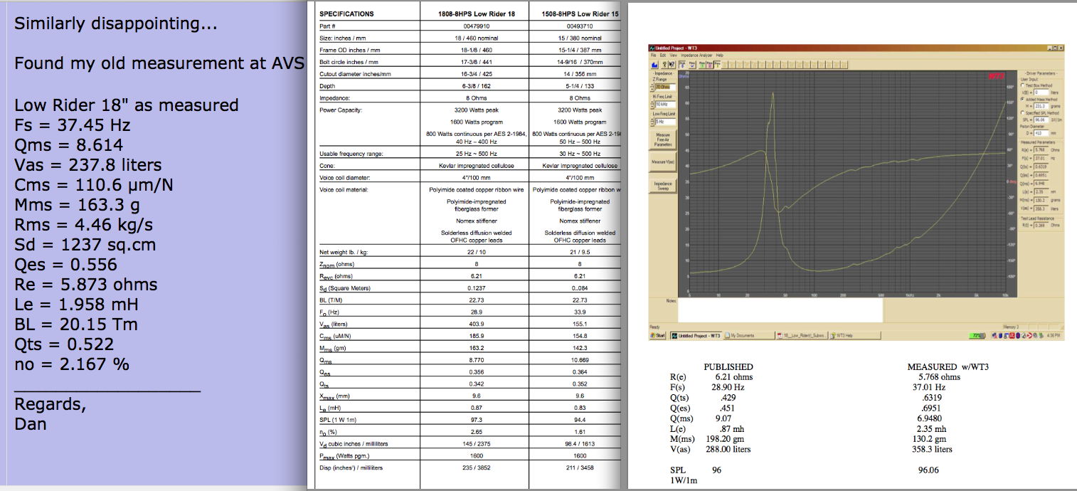

Could not get REW / TS to play nice w/my set up. Got this from WT3. What do you think?
Similarly disappointing...
Found my old measurement at AVS - thanks Google 😀
Low Rider 18" as measured
Fs = 37.45 Hz
Qms = 8.614
Vas = 237.8 liters
Cms = 110.6 µm/N
Mms = 163.3 g
Rms = 4.46 kg/s
Sd = 1237 sq.cm
Qes = 0.556
Re = 5.873 ohms
Le = 1.958 mH
BL = 20.15 Tm
Qts = 0.522
no = 2.167 %
There appears to be more than one iteration of the "Low Rider", note that the published figures I have below are not the same as yours, and Dan and your measured results are also different.Could not get REW / TS to play nice w/my set up. Got this from WT3. What do you think?
More than one iteration of crap is still crappy, time for potty training at Peavey... 😀

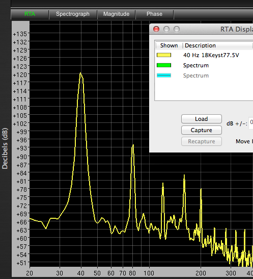

Distortion testing is easy with some measurement systems, but still can be done the hard way by looking at a sine wave signal and the resultant harmonics on an RTA, subtracting the difference in dB, then calculating the distortion percentage.

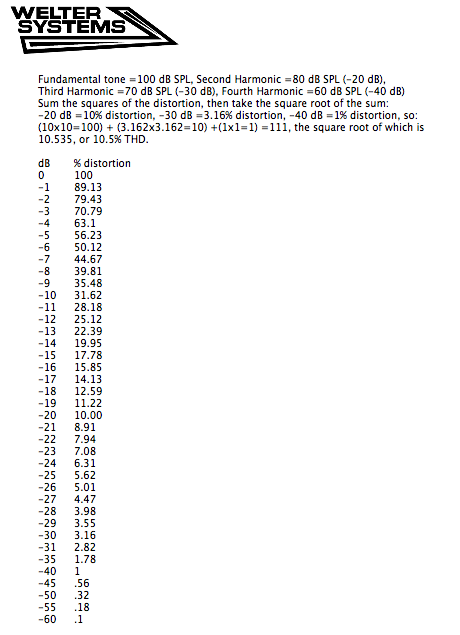

For " close enough for rock and roll" purpose I calculate distortion % using the calculator below, the harmonic with the highest level pretty much determines THD, the contributions added by lower level harmonics generally add only a fraction of a percent to the highest harmonic.
In the example below, we can see 80 Hz, (the second harmonic of the test tone) is 94.1 dB, the 40 Hz test tone is 120.5 dB.
120.5-94.1=26.4
Looking at the distortion calculator chart, we round up 26.4 to 27 dB, and see the speaker has around 4.47% distortion. Rounding up insures the contribution of the harmonics of lower SPL level will still be less than the reported figure.
Art
The above was wrong, the difference between the fundamental and the loudest harmonic should be rounded down to the nearest whole number, 26.4 to 26, the speaker has around 5% distortion. Rounding down insures the contribution of the harmonics of lower SPL level will still be less than the reported figure.Looking at the distortion calculator chart, we round up 26.4 to 27 dB, and see the speaker has around 4.47% distortion. Rounding up insures the contribution of the harmonics of lower SPL level will still be less than the reported figure.

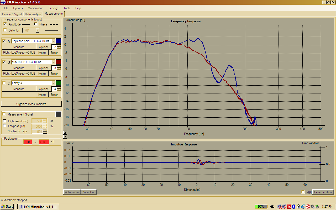

I hope the more experienced will provide input but I am surprised how well the KS performed as the Low Rider does not sim well at all... This is making me think more about trying the PA465.
John,was approx 1 meter on axis at roughly 95db.
Looks like there is a 45 Hz LP engaged on both tests. The Keystone should go a lot lower.
If that is two Keystones compared to one dual 18 BR, that still is not a good result, unless the 45 Hz LP is masking the Keystone' LF extension, and the BR Fb is upwards of 45-50 Hz.
Were the tests at about 2 volts? Same signal applied to both the Keystones and the BR?
What is the BR cabinet size? Have you checked it's Fb?
Art
John,
Art
Same signal - yes. Moved cabs in and out of same test position
2volts? Across amp output? Not sure - what is correct way to measure 2v at output? Pink noise or sine at some freq?
BR cab is 16cuft tuned to 42.5hz. It has a bump at 50hz. Lower tuning smooths out bump but looses power handeling and gives very little lower extension.
AFAIK the only filter used in this A/B test was 3rd order hi cut at 100hz.
Stimulus signal was log sine sweep from 30hz up. Mic at ground plane 4 feet in front of cab. Nearest structures about 15 ft away.
