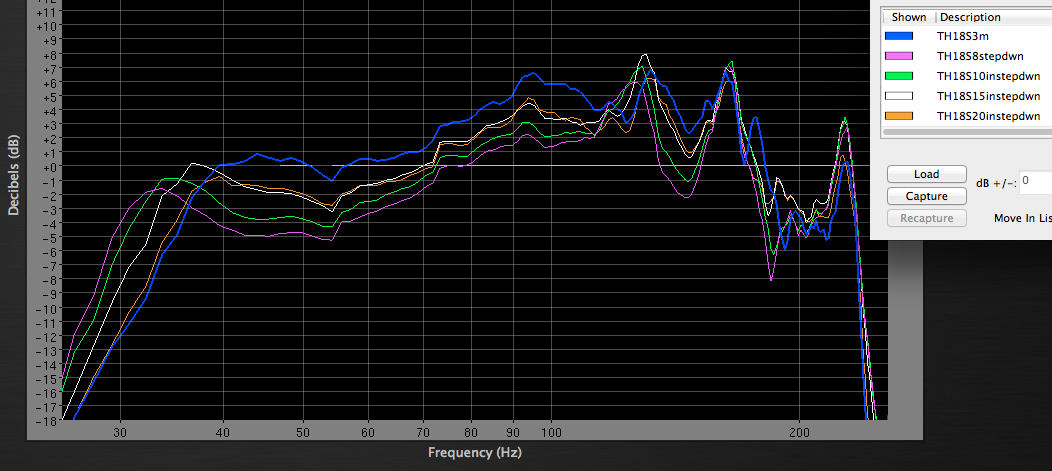

The simulation EPA posted in #248 shows a lower response than the actual measured response of the Keystone, which starts to roll off just below 40 Hz. Since the excursion minima is around 36 Hz, EQing the response flat in that range is no problem, but boosts below 32 Hz will end up increasing harmonic distortion quite a bit as excursion rises rapidly.
One interesting aspect of the Keystone design is the Fb can be lowered by simply covering the upper portion of the exit, the measurements below show the difference between the normal size exit, "TH18S3m", and covering up the upper portion of the exit, "TH18S20" has the upper 20 inches of the exit covered with plywood. The "step down" cover results in as much as an 8 dB increase in 30 Hz level, but with progressive losses in the upper bass range, so for most music the trade off is not worth the extension.
The RTA 420 mic used for those tests reads -2 dB low at 30 Hz, so LF response is actually 2 dB better than indicated.
Art

So Art, if I increase the Keystone measurements hight by 4" and the width by 5" we will get a roll off just below 35hz and loose only 2-3db with the B&C 21SW152-4 driver, (which looks to be out of stock until 9/19)? Also with this cabinet extension, the Keystone exit stays the same, right? And after reading about the Keystone covering of the upper portion of the exit lowering the Fb, which leads to progressive losses in the upper bass range, I too think that the trade off is not worth the extension. I hate trade offs, when loosing db's or bandwidth.
The sound engineer at church says he would like a 25hz extension, but I think he really doesn't know what he is asking for. I can see that in car audio, home theater, or just showing off. But what would you need 25hz in a church environment for? It's live sound, bass, guitar, drums, and electronic keyboard. I think he would be happy with a well designed cab with high efficiency, high output, and as you have done 5hz lower than the norm of 40hz, what do you think?

1)So Art, if I increase the Keystone measurements hight by 4" and the width by 5" we will get a roll off just below 35hz and loose only 2-3db with the B&C 21SW152-4 driver, (which looks to be out of stock until 9/19)?
2)Also with this cabinet extension, the Keystone exit stays the same, right?
3) But what would you need 25hz in a church environment for?
4)I think he would be happy with a well designed cab with high efficiency, high output, and as you have done 5hz lower than the norm of 40hz, what do you think?
Shaun,
1) Sounds about right, but given more power, the increased cone area of the 21" should about equal the output of the 18" and go lower.
2) No, it probably should be scaled up approximately by the percentage of cabinet volume increase.
3) Pipe organs going down to 16 Hz have been used in churches for centuries.
4) Comparing the response of the Keystone to headphones that have response down to 9 Hz, I seldom hear any missing low notes in any of the music I play, or even in the music of the few EDM DJs I have worked with. I designed the Keystone as the optimum low extension vs. size, and wanted something that can do justice to the low B on a 5 string bass (31 Hz). That said, there are keyboard patches and musical genres that have output deeper than the Keystone's range, and other larger cabinets that can reach lower for those willing to build them.
