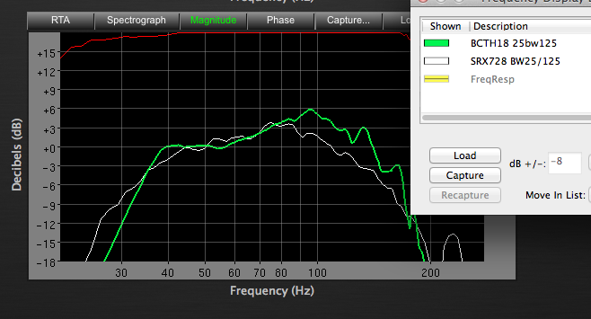

Hey art did you ever directly compare your keystone to a JBL srx 728?
I compared the WS 2xLab12" bass reflex cabinet to the SRX 728, and by duplicating the same drive settings have compared the BC18SW115-4 loaded Keystone to it, so the comparison of the frequency response and sensitivity is as in the graph below.
JBL mistakenly published the Xlim/Xmech rating for the 2268H woofer used in the 718 and 728 in place of the Xmax rating, more than double it's actual Xmax of around 8mm. The BC18SW115-4 has almost double the Xmax of the 2268H, so a single Keystone can almost equal the output of a pair of SRX 728.

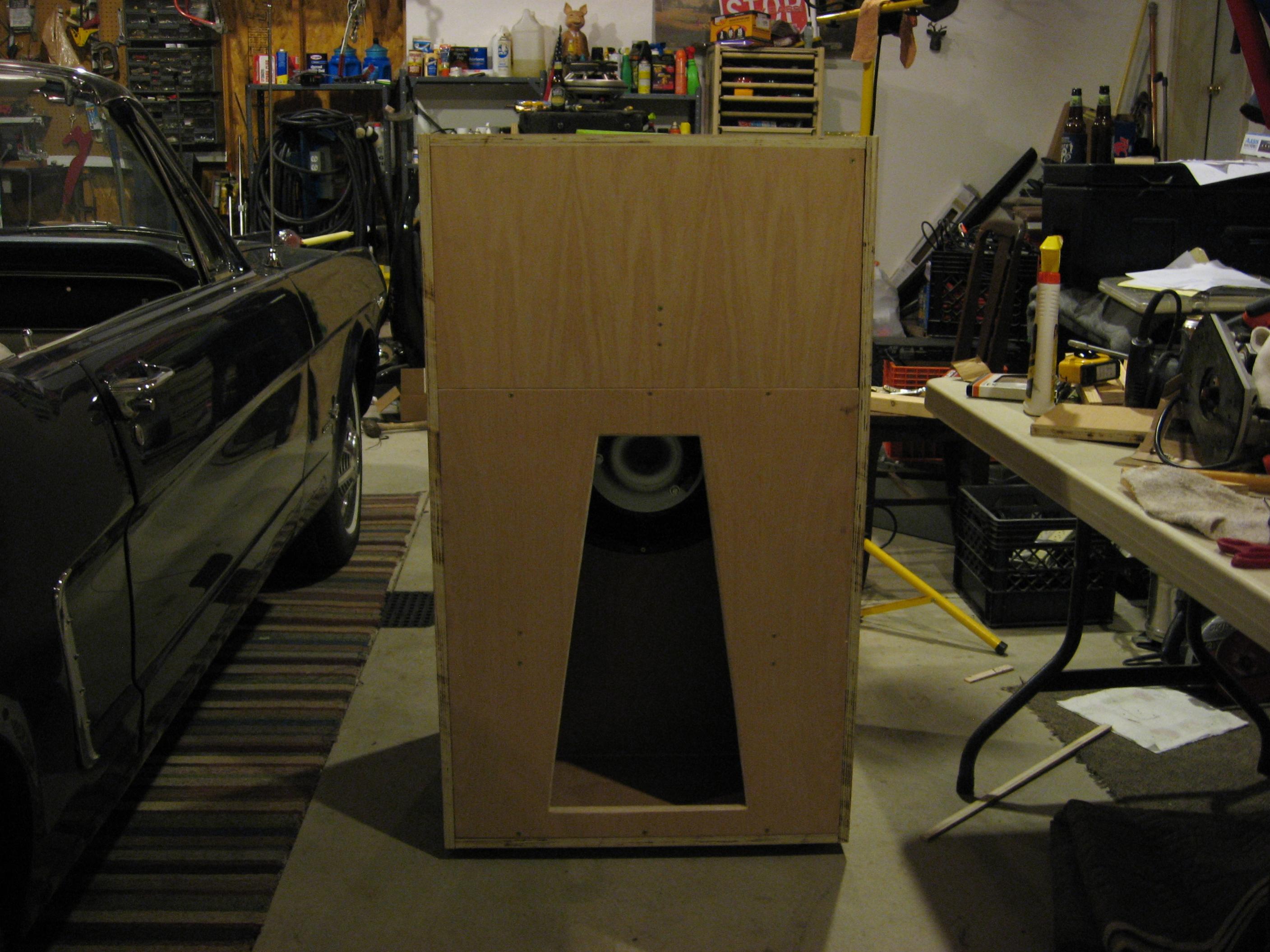

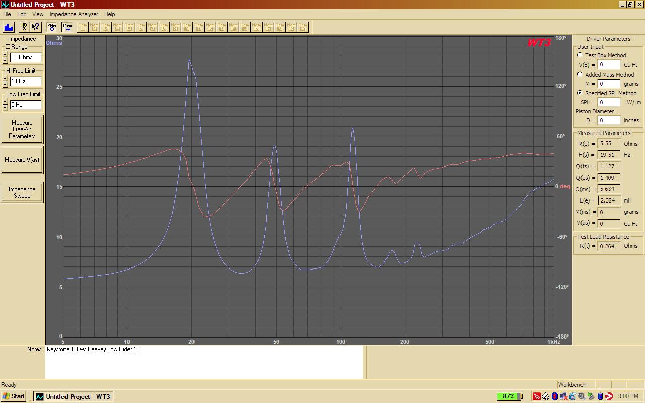

Great stuff! The curve suggests tuning around 34 Hz as another poster has indicated. The flattened impedance dip around 70 Hz and the slightly misshapen peak above that suggests the possible impact of panel flex, but it would take more testing to confirm if this is the case.
I'm new at this so whatever measurements I make - take with a grain of salt. Panel flex would not surprise me - the cab vibrates a lot. Overall the construction is pretty tight though. The 3/16 gap at the top right face panel section is the worst one on the box (oops) - cut everything with a skill saw and carbide blade. I used TiteBond, deck screws, and sub floor adhesive to seal all joints so no air leaks or rattles.
When choosing wood I went for a serviceable quality within a budget - not marine grade or anything - it's an oak veneer 24/32 9 ply as I recall. It is not too bad for voids but a bit softer/less dense than the good stuf. I figured the oak would give me a tough exterior surface under the planned Duratex coating.
I'm looking forward to running some sweeps with REW as soon as I get time. I want to see what the response looks like compared to what I am hearing - because what I'm hearing is excitingly good.
