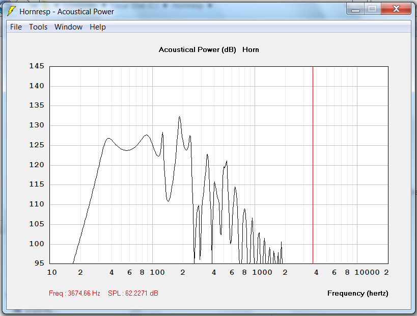

There have been two measurements falling of quite a bit over the f3 point claimed in the last pages, not bashing the design as it could have been many reason for it but for EDM solid 35 hz would be mandatory... Hope it could deliver it!
That would be really cool, both the part with top cabs and a review on your cabs! Especially regarding EDM/techno/trance.
link? the tbw100 loaded cab appears to have a 36hz f3 witha bump in output around 43hz.... id say thats spot on.

Sine is spot on. Last few posted measurements were cabs not loaded with Art's recommended driver. Mine either. I will posts some build thoughts later.
