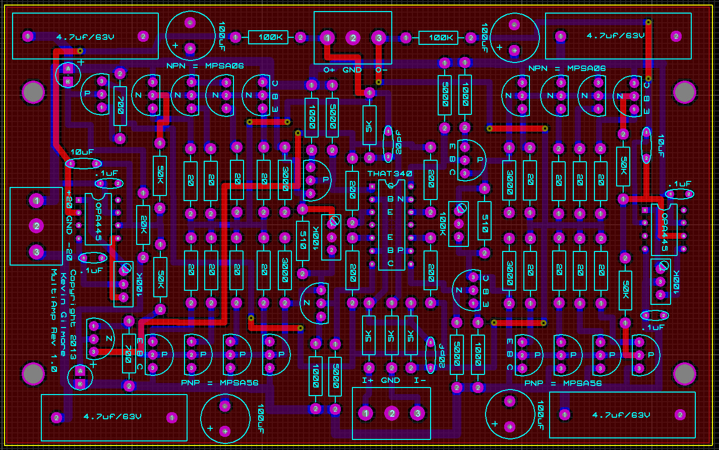

I have recently purchased the following Unbalanced to Balanced Convertor boards but the vendor now tells me that he has lost the parts list.
Can anyone help ?

I'm trying to search for a quad transistor array with 2 x NPN and 2 x PNP but I'm drawing a complete blank.
It's likely these; not sure where you'd get them:
THAT Corporation 300-series Low-Noise Matched Transistor Array ICs
Likely the THAT 340.

Take a look at this thread.
Balanced to unbalanced board - Do It Yourself - www.Head-Case.org
There is a BOM for the SMD version, but not for the thru-hole.
The ebay vendor that ripped these boards off (though Kevin doesn't seem to mind) should be able to supply a board to support their "product". The BOM would have been a spreadsheet. How do you lose it?
Thank you for that, it answers all my questions.
The THAT340s are available from Farnell.

I managed to get most of the semiconductors from Farnell, the THAT340s, OPA445s and the MPSA06s. I had to get the MPSA56s from a UK seller on E-Bay.

Any and idea what the power rails are for this?
I'm guessing at +/- 20VDC but that seems an unusual voltage.
+/- 20V nominal, but the original specs from Kevin were +/- 16-20V (IIRC) so there should be some room to adapt to what you need.
Is it really necessary to use E96 resistors in this design ?
I have seen two boards that use different resistor values in the same positions.
50K could surely be 49.5K.
3K0 - I can't find them
5K0 - I can't find them
700R - I can't find them

Probably not. The "right" values are:
50k = 49k9
3k0 = 3k01
5k0 = 4k99
700R = 698R
Depending on where the resistors are located you can probably get away with a few percent off (value + tolerance). Because it is a differential circuit, in some places the matching between sides is probably a lot more important than the absolute value.
