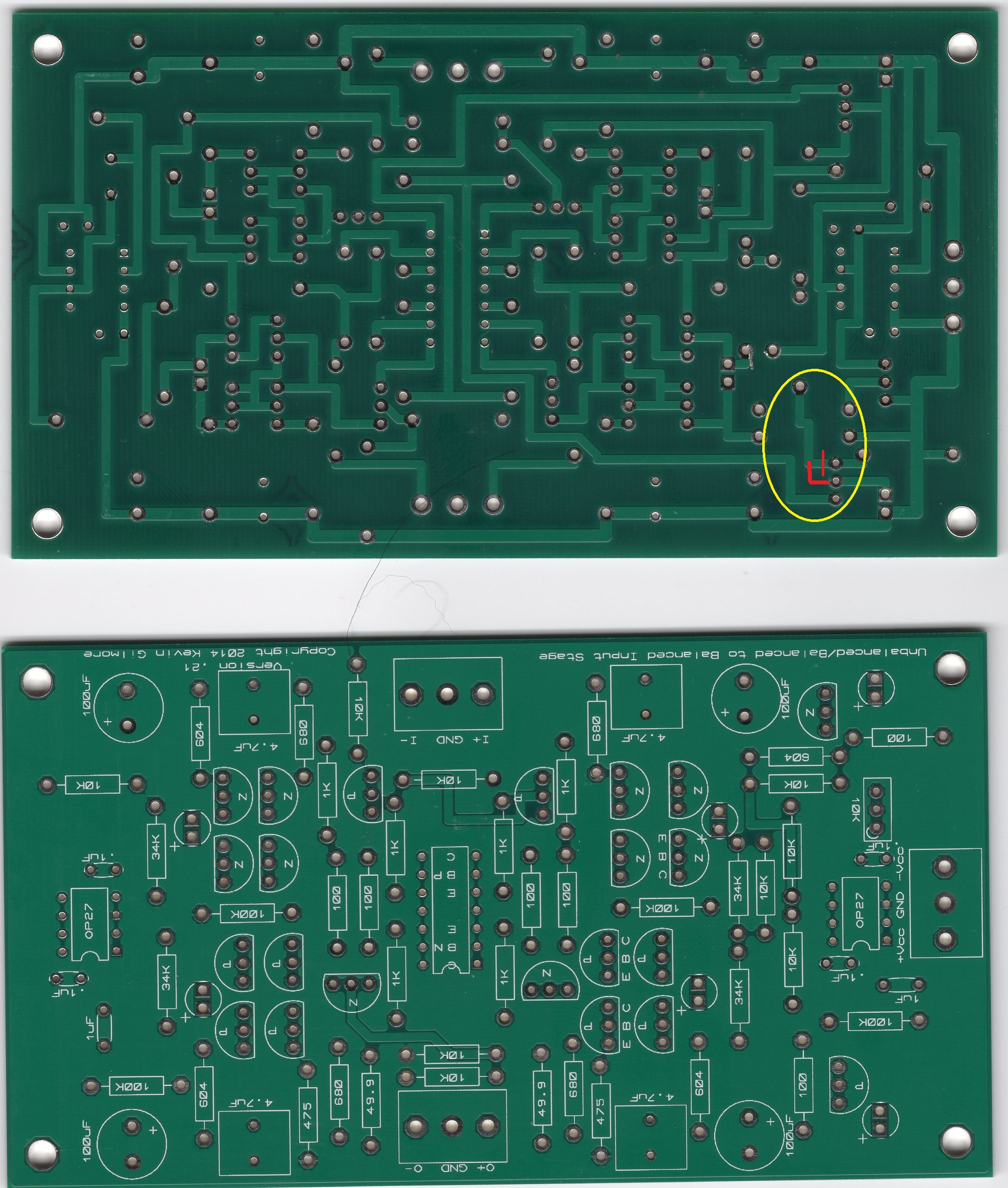

The error is easy to correct.

The 10K needs to be connected to the B not the E.
That was what I considered as the only way of making sense of it.
Now, if the router made this mistake, or had another bjt in mind, and this other part in mind during routing, be aware that it is possible more errors can be encountered on the board.

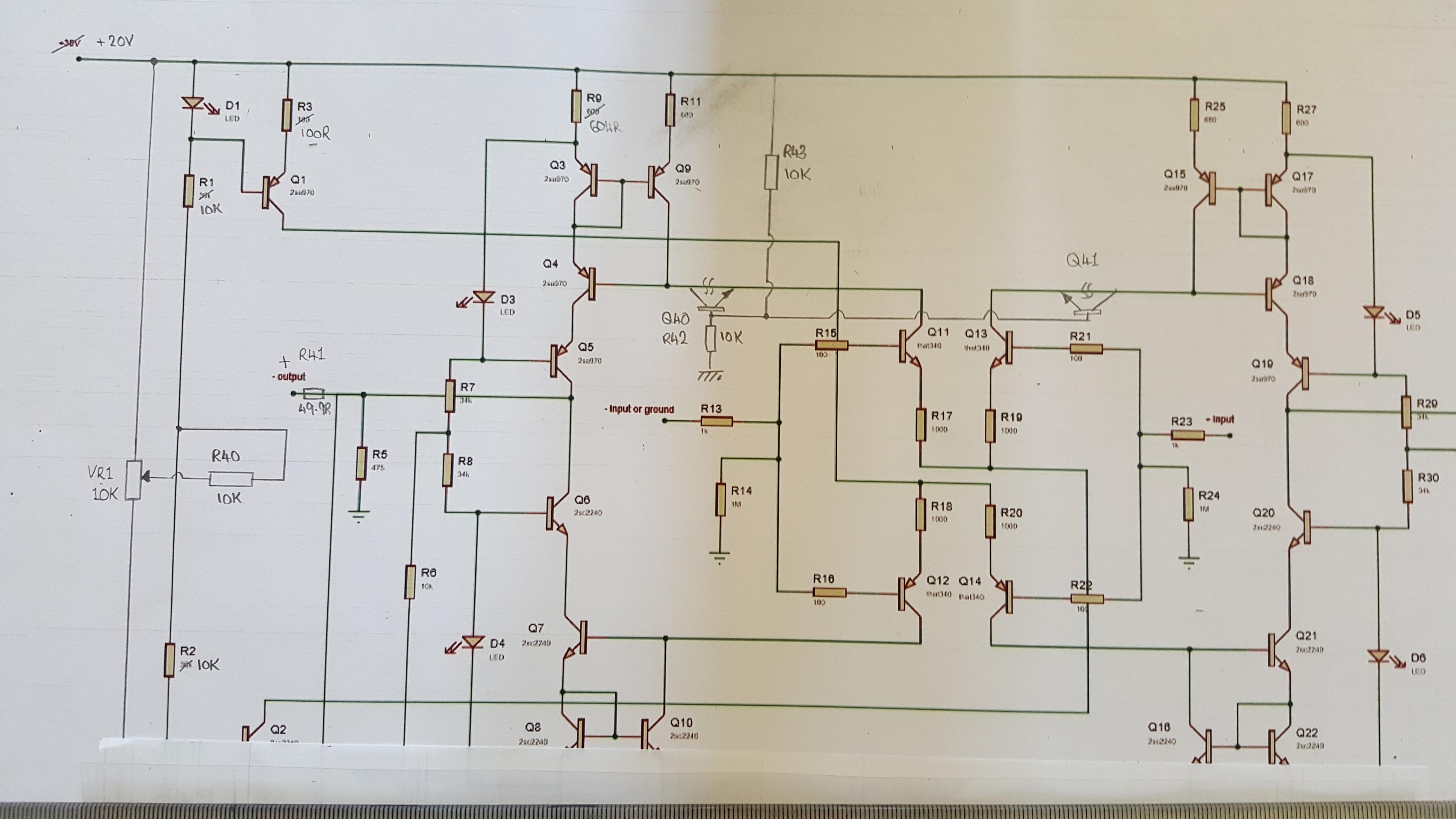

Can you post the circuit drawing here so others who feel tempted can cross-check too?
The circuit resembles #24, but with some differences.
The four bjt's in the that340 have cascodes added in their collectors, held at halfway the supplies with two 10k resistors at each supply.
Added in the outputs are extra 49.9Ω resistors, input resistors are 100k.
Integrator input resistors are 100k (at pin 2), current determining resistors R3 and R4 in the current sources for the differentials are 100Ω, so the diff's run higher current.
Obvious some caps on the rails.
And the found error on the board, I could not find others.

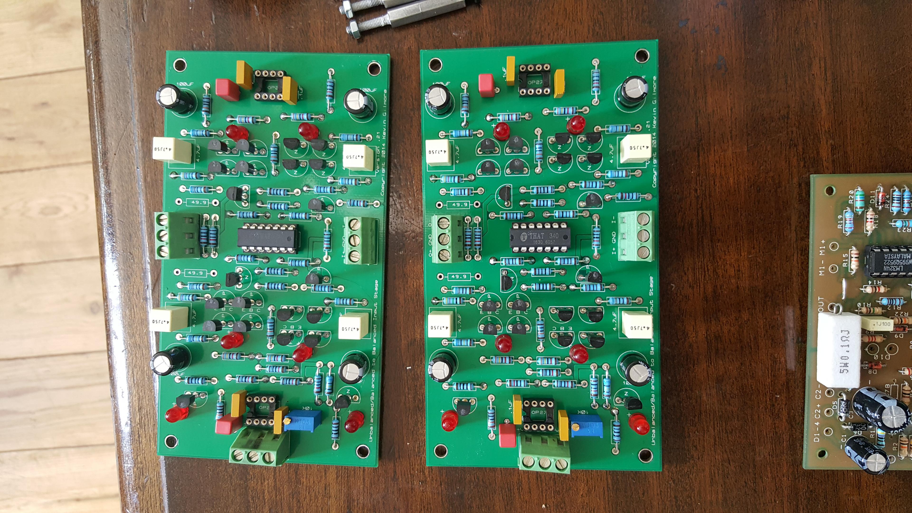

The wife's been tidying up and the packets with the op-amps and 49.9R resistors have probably cone up the vacuum cleaner.
Other than that, I'm ready to go.

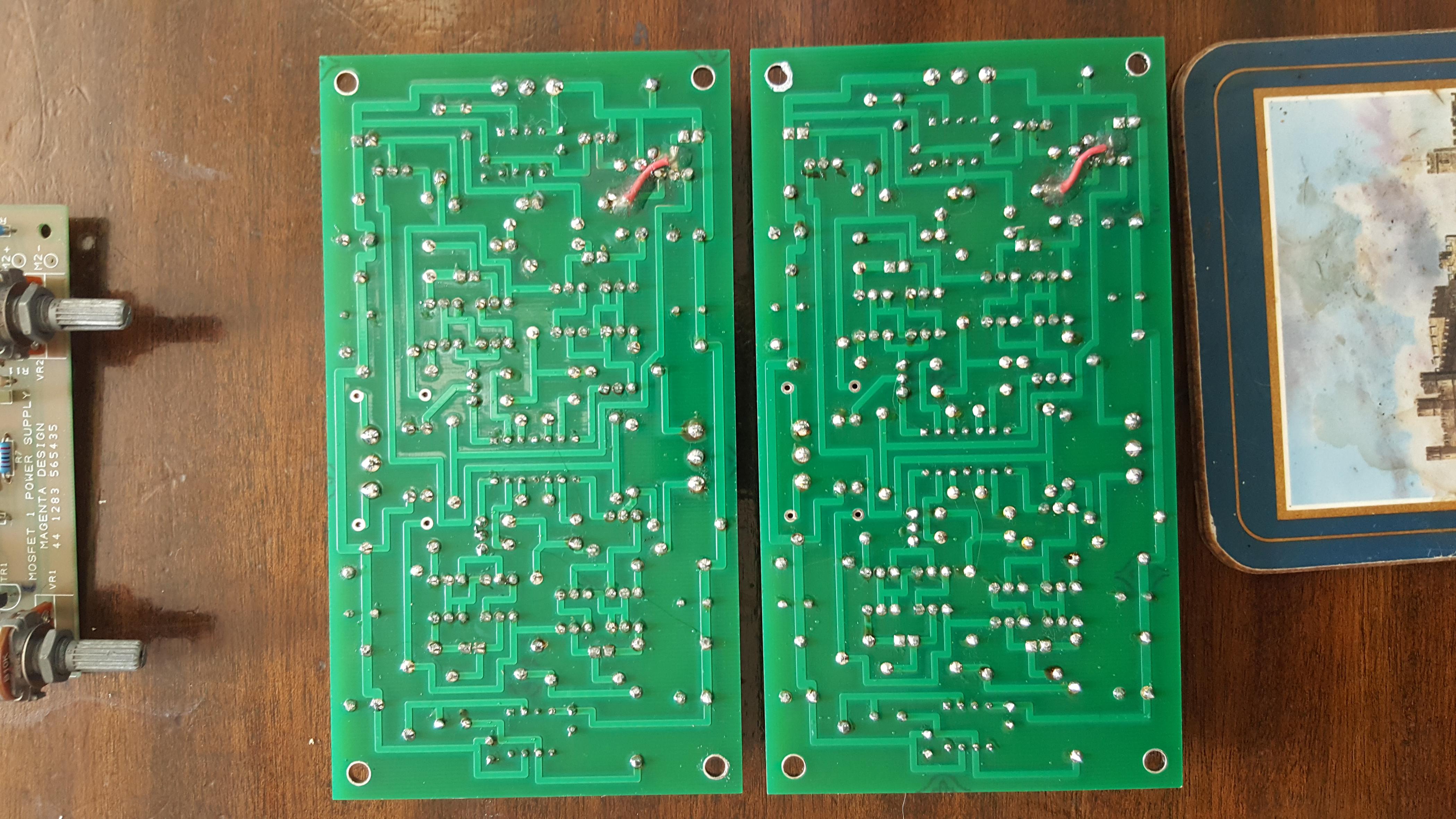

You can see the mod to the incorrect artwork on the bottom of the boards.

Oh, I forgot to mention the pot and 15k to the centertap of the two 10k's in the current sources for nulling on your board.
I've decoded the purple board in #8 this morning. It's an elaborate circuit and only the second and end stages are corresponding with #7. The front is the That with same current sources. Two dc integrators to stabilize the circuit and yet four pots needed to tame the thing... why so complex?

I spotted that the PCB artwork was incorrect just by reverse engineering the board.
Some guys built the board and found that they couldn't adjust the DC offset.
Between those pieces of information I deduced that the VR should adjust the DC output and that there was an error on the PCB artwork.
Thank you everyone for your help. I will let you know if they work when the missing components arrive.
On both boards the op-amps are running extremely warm, is this to be expected?
No, not to be expected. +/-18V is near limits of most opamps (40V total), so maybe separate rails needed... not nice on those boards. Was this circuit ready for +/-20V up actually?
Current through from the current sources to the input differentials is depending on the forward voltage over the leds. If they differ, the cs- currents differ too. Better have them somewhat selected.
I'll have a look on your reveng-circuit drawing when/if posted.
