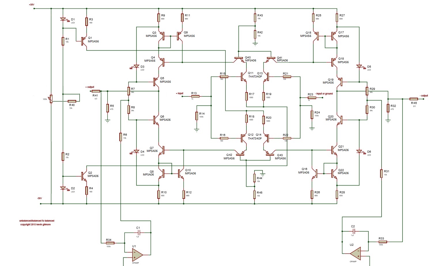

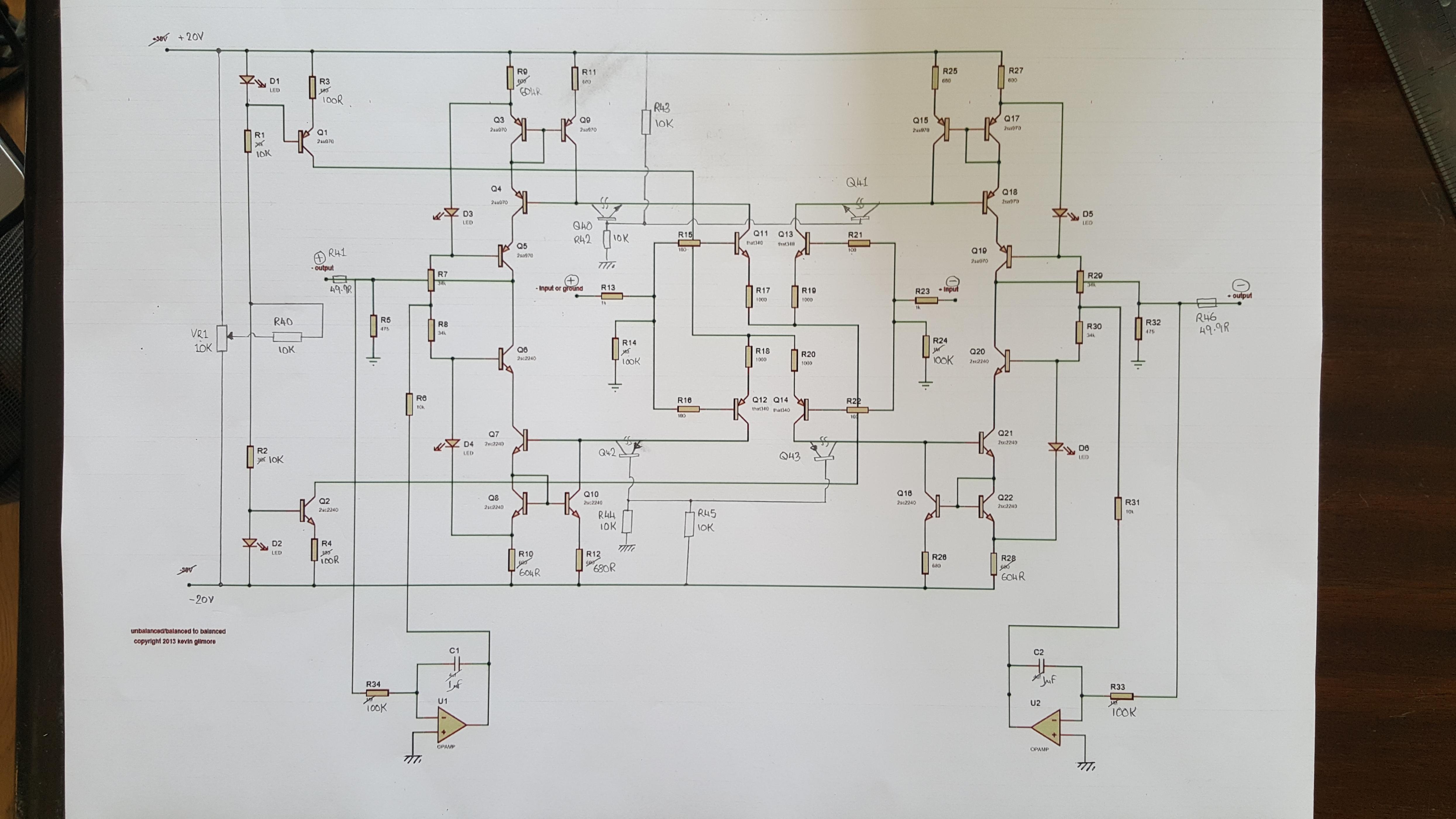

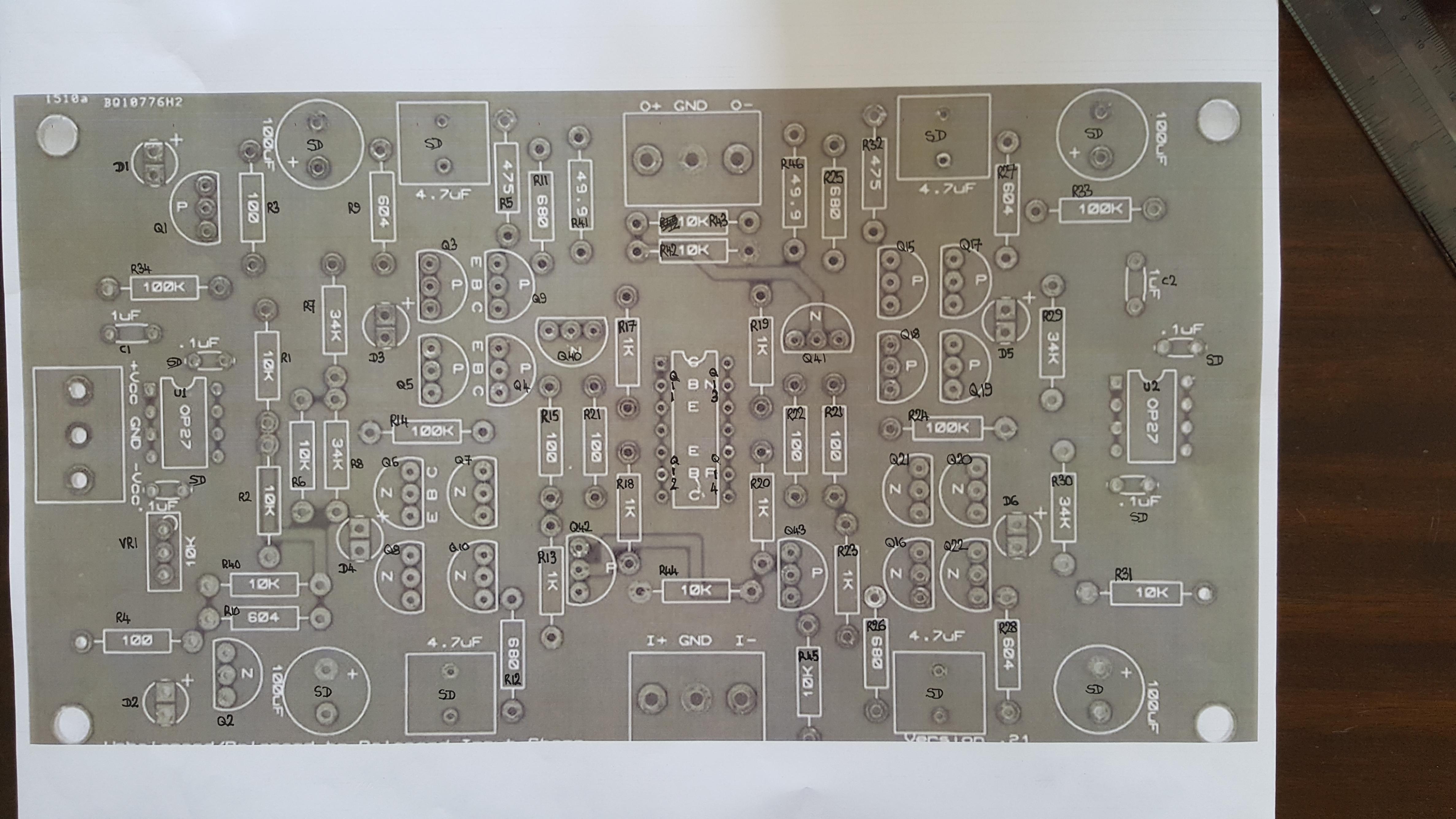

I finally finished the reverse engineering.
There are component differences between the original and the Chinese copy.
Extra components I've designated as 40+.
Components marked SD are for supply decoupling and aren't shown on the schematic.
I still can't see why the op-amps run so warm.

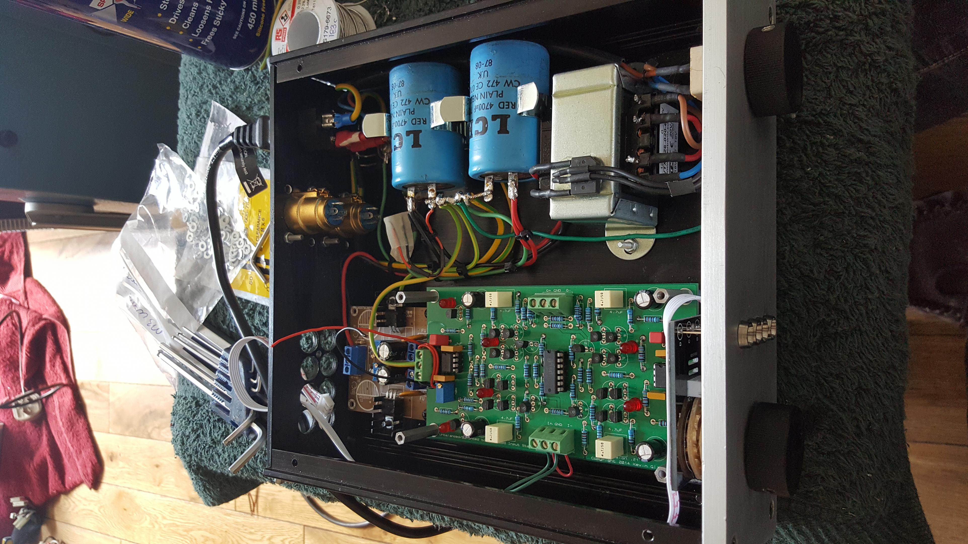

I'm using OP27 op-amps from a reputable supplier (RS as it happens).
I've got VCC at +/- 18V, it should be +/- 20V.
The op-amps aren't HOT but are at about 45C which seems warm to me.
The OP27 is rated at +/- 22VDC so that shouldn't be the issue.
Max power is when opamp output is + or - 20V, with a load of 10k is 2mA (assumed node between R7-R8 stays 0V), so power dissipated is 2*20V * 2mA = 800mW.
The picture in #49 does not show the OP27's, but if it's 8-Lead PDIP the temp specs are (θJA=103,) θJC=43 °C/W yielding in 0.8 * 43 = 34.4 above room temperature, so it's 45 - 34.4 = 10.6°C in your shed if it was possible to use them as coolers.
Expecting some 20°C instead, there is 25°C temp raise, and with this 43°C/W results in 580mW dissipation, which results in 580mW / (2*18V) = 1.6mA current from the output, lifting the output voltage up or down towards the rails, say some 1.6m*10k = 16V.
So, what is the actual output voltage of the opamps?
All working now.
Thank you everyone for your help and comments in this thread, the Kevin Gilmore UnBalanced to Balanced Convertor is now working.
Although the wrong op-amps wouldn't have helped the problem they were not the true source of the problem.
I decided to swap out all the LEDs with "Identical" items, ie all from the same batch.
With identical LEDs throughout the circuit it balances out nicely. The op-amps only help to zero the output to an almost perfect 0mV DC offset.

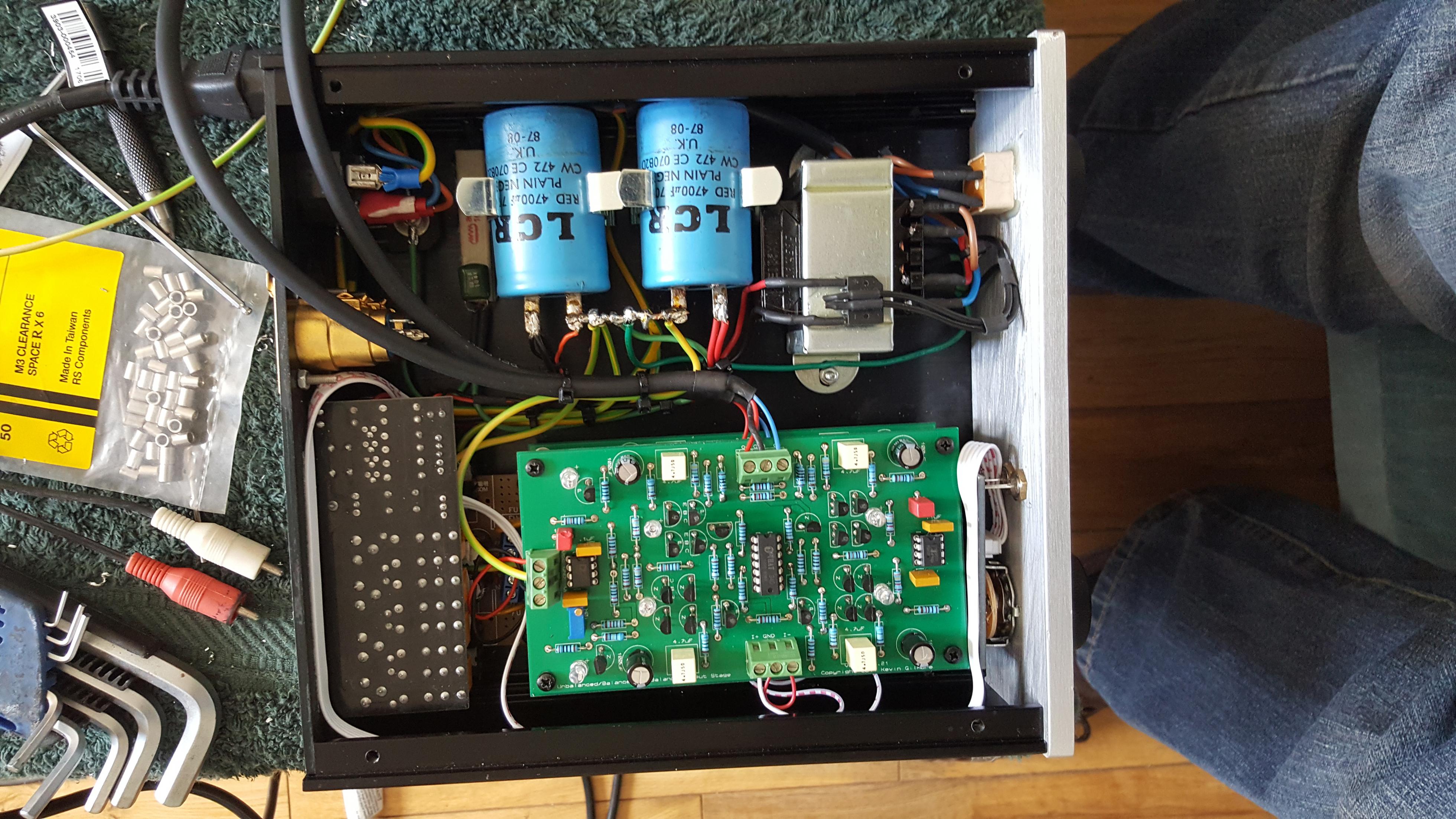

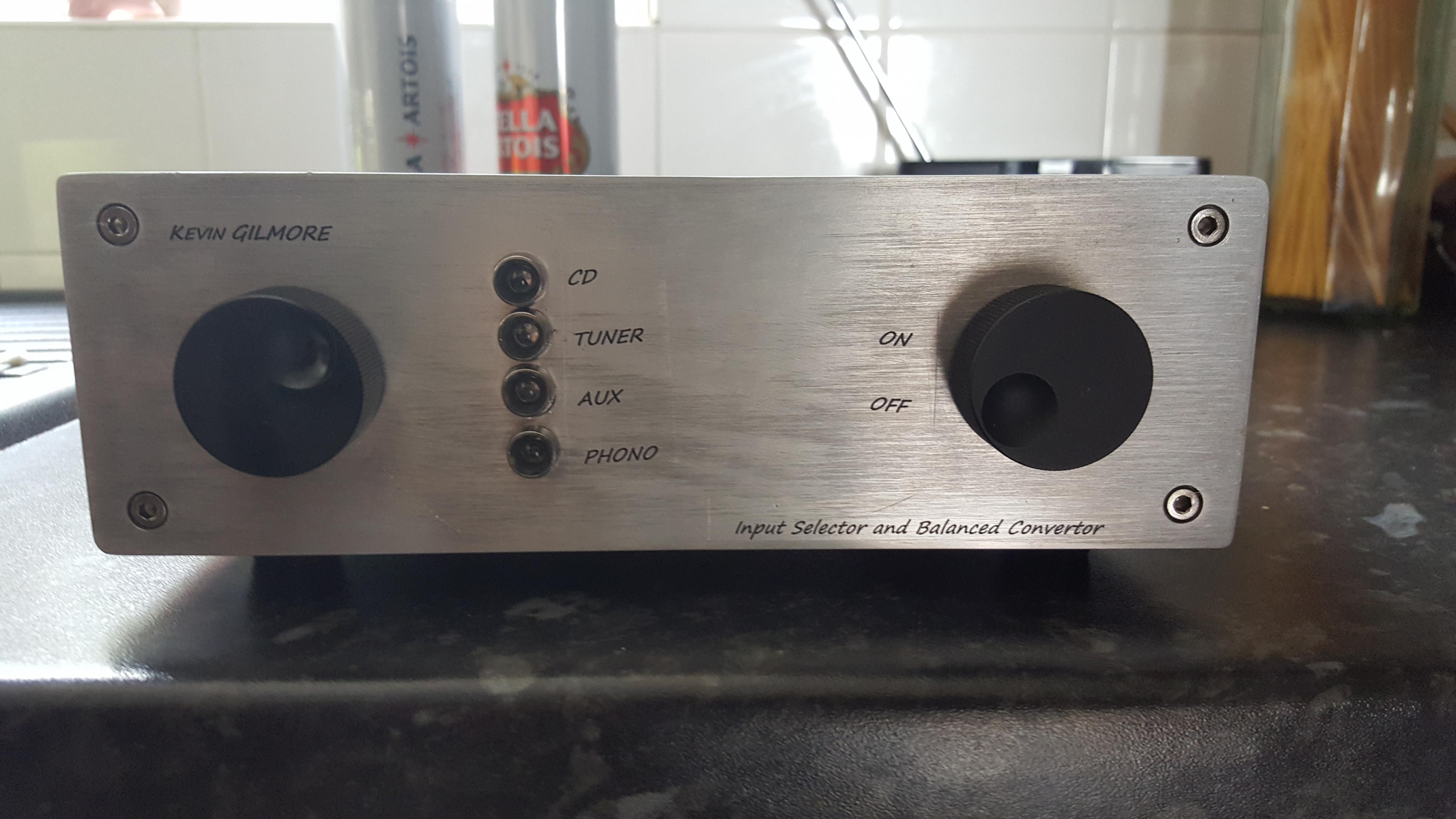

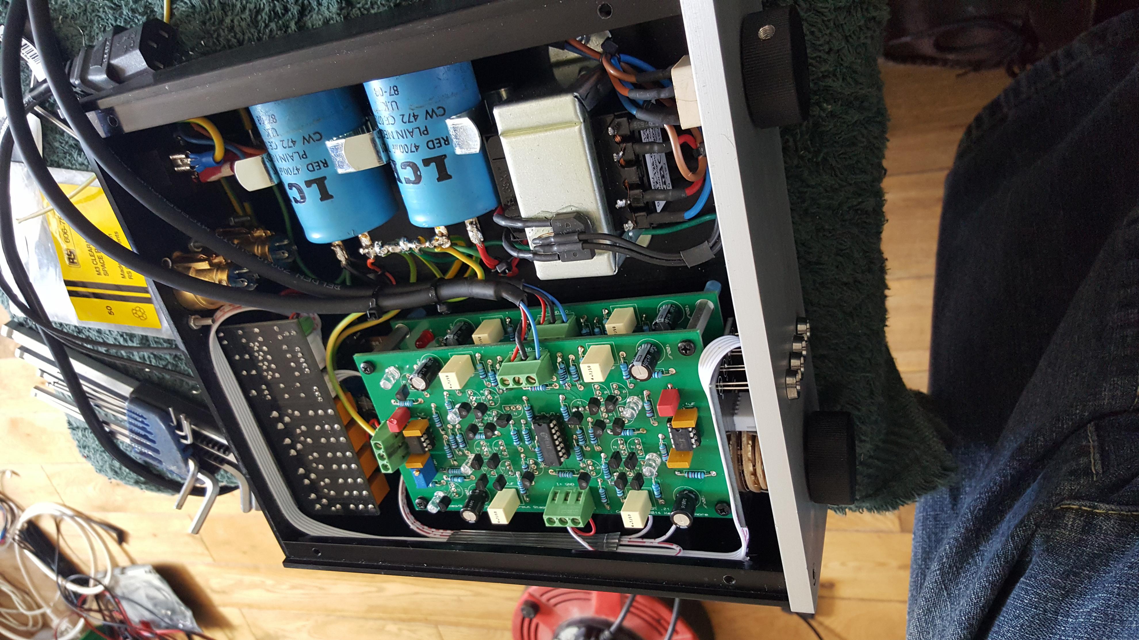

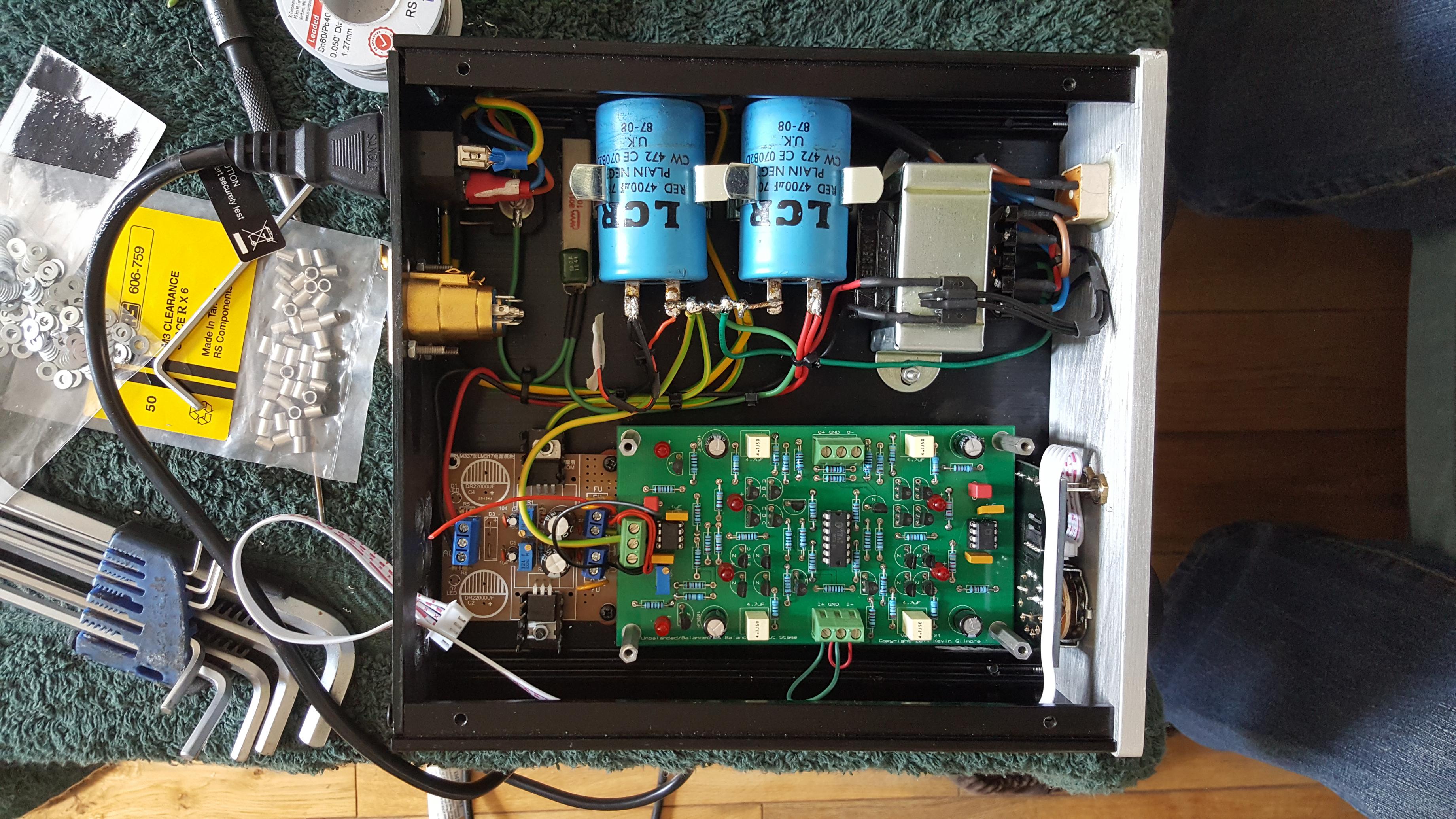

It's a tight fit
It's a tight fit but I'm pleased with the results so far.
The second channel sits on top of the first and the input selector board fits above the regulator board.
