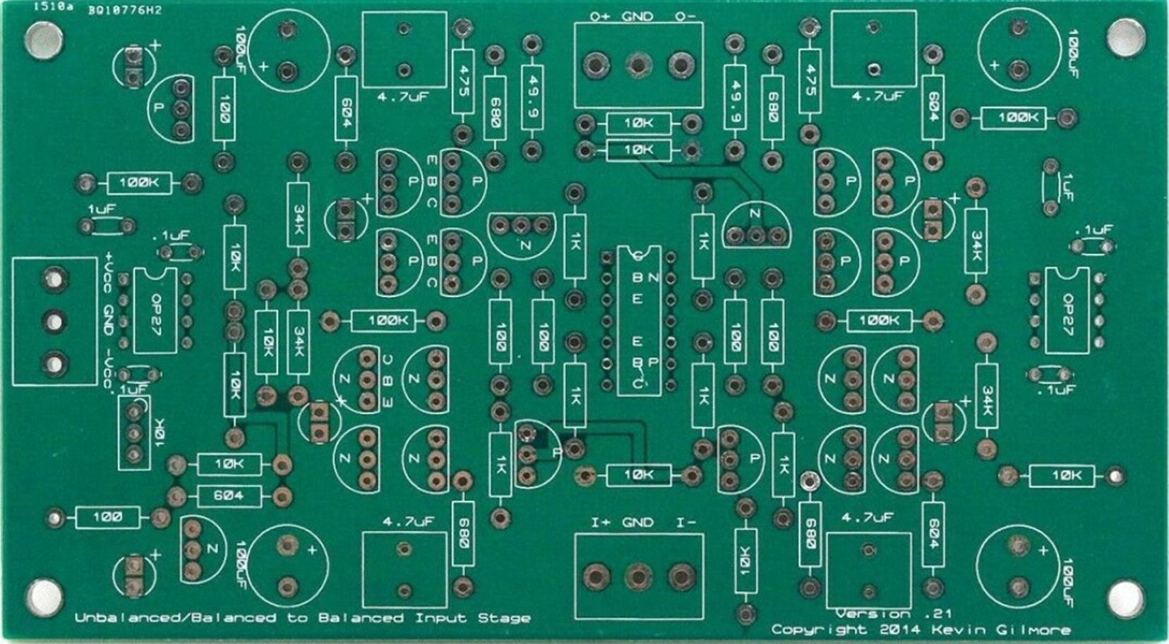

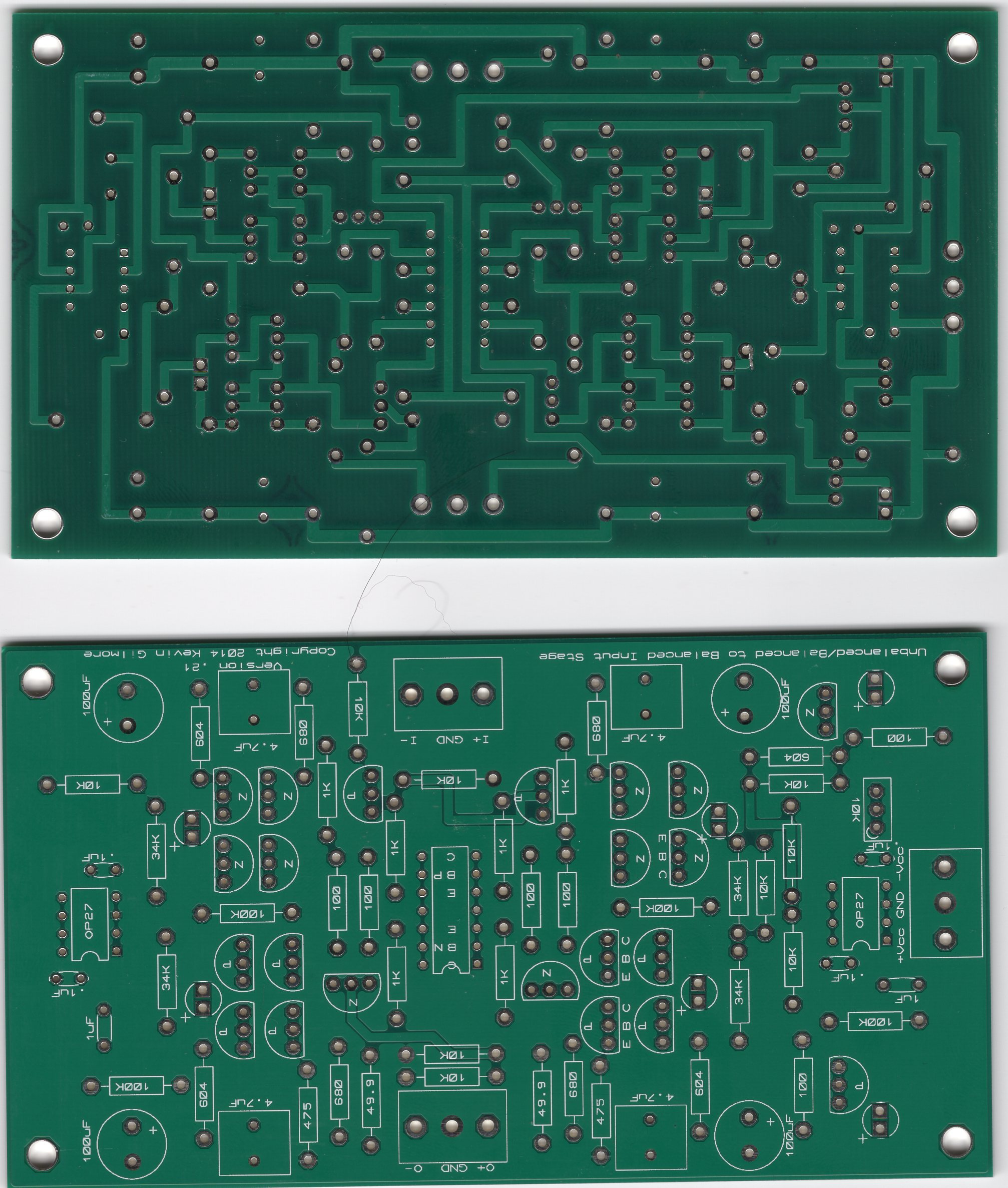

Hmmm, the vendor supplied a schematic but it bears no resemblance to the PCB.
  • ubaltobal3.pdf
    ubaltobal3.pdf
I've managed to buy nearly all the components from the silk screen legend and with help from you folk.
The only remaining mystery are the LEDs. I'm guessing RED but that is only a guess.
I've still not seen a schematic that looks anything like this PCB ?
Thanks Nisbeth, I guessed that it might be RED LEDs.
I bought all the resistors from the Vishay MRS25000C range.
The only value that isn't available in the E96 range is 680R, I'm using 681R (that'll be close enough and close 1% tolerance).

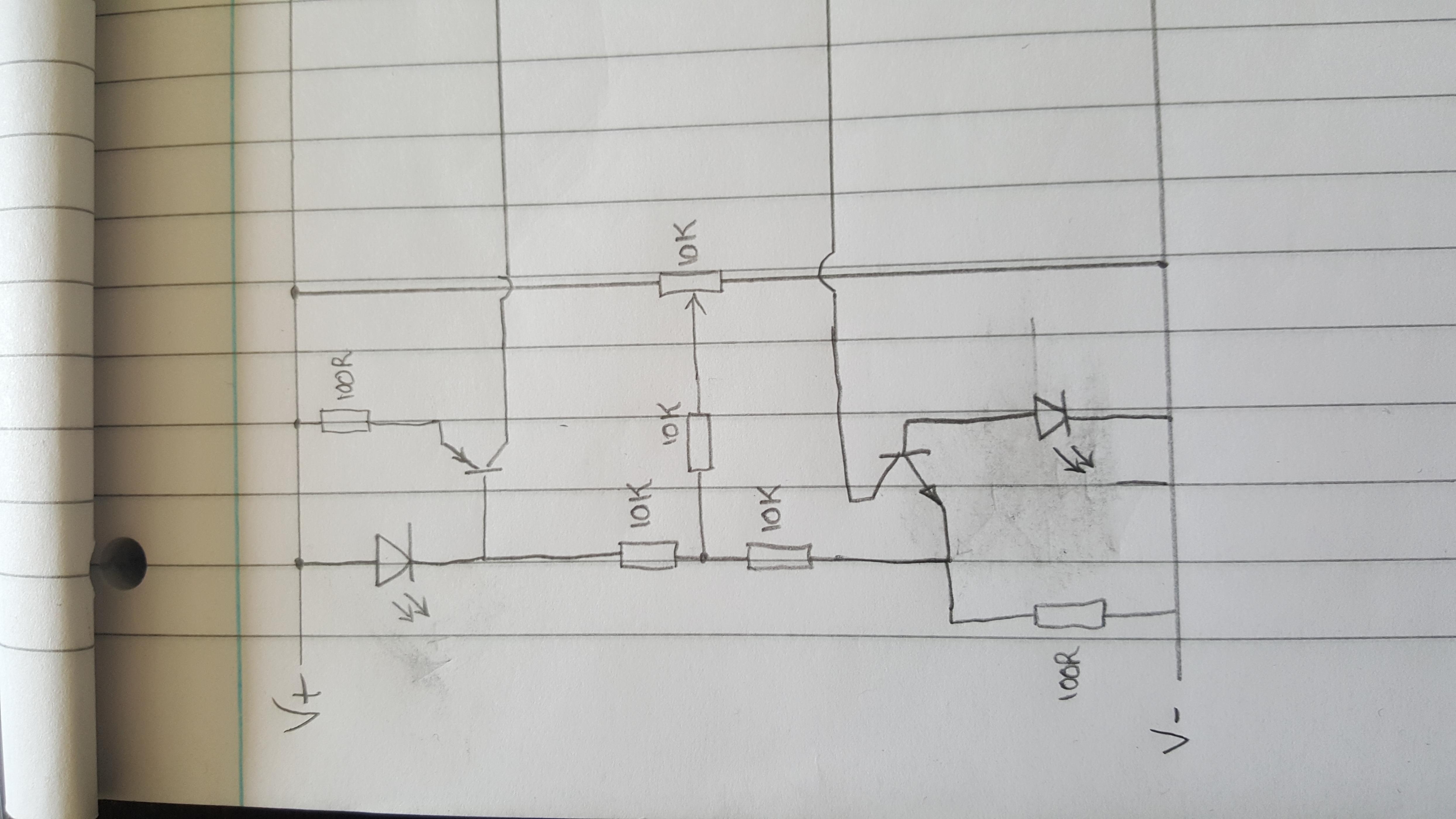

Reverse Engineering
I'm trying to reverse engineer these boards to work out a schematic.
So far I am confused.
The lower LED appears not to be biased ? I've checked my work and that is how that transistor is connected.
Sometimes in the headcase forum they will share links of chinese sales posts (DIY boards and finished units) that use their old and/or faulty boards. That is a 2014 board, there are more recent and working iterations of bal/ubal to bal input boards.
