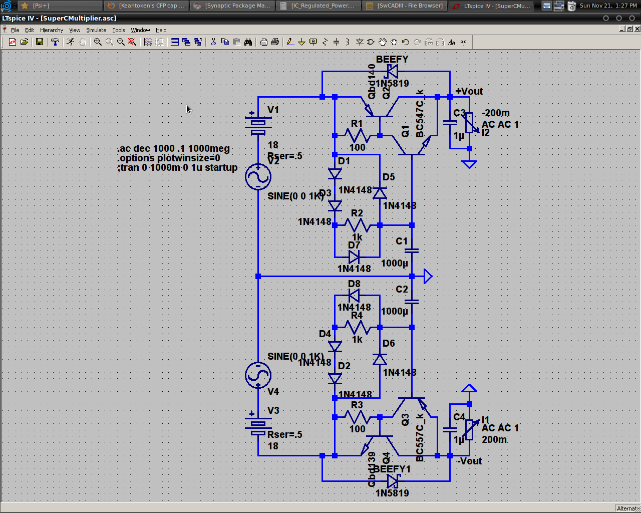

IMHO, negative version will perform much better, since base of Q4 is "feeded" through Q3. In positive version, base of Q2 is feeded through 100R resistor.
According to Walt Jung in Figure 1b, 40dB rejection is possible. No matter if anyone stack 2, 3,...10 transistors, if pass transistor's base is feeded with noise, you have "garbage in, garbage out" situation.
Swap R1 and Q1 positions.
Or feed base of Q1 through resistor, but then you need heavy R/C filtering, which will add complexity.
Or add JFET.
Or.....do anything.
But 100R resistor there is wery bad choice. No way to get better than -40dB (in theory).

There is no difference between the positive and negative versions; the bases of the outputs are "fed" by the drivers, and the 100R resistors give ~6mA bias for the drivers, to reduce output impedance. There may be a difference if Early effect is different for PNP's and NPN's, but if so even Andy_C's models haven't revealed this.
Let me draw the schematic a different way.
- keantoken

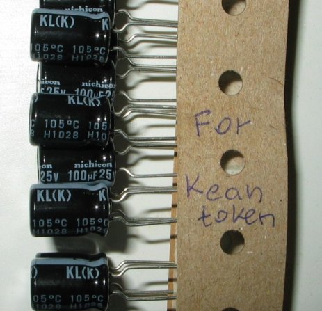

Storm has a good point about low-leakage caps. Unfortunately the rubycon ZL datasheet is down, so I can't check.

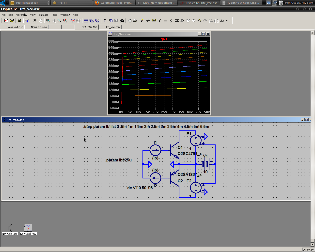

I take that back, the datasheet shows the 2SA1930 has worse Early behavior than the 2SC5171. This would forecast worse input rejection for the positive regulator.

SPICE doesn't have any trouble modeling the Early Effect, but the transistor model may not have the correct parameter for Vaf.

HiFi, I have added varying amounts of ESR and ESL to each capacitor. As it turns out, C1 has a significant affect on the pulse/HF behavior of the multiplier. If I understand correctly, capacitance is multiplied, while resistance and inductance are divided by the current gain of the multiplier. However, Ib grows with frequency, meaning HF load behavior will influence the caps' resonances more. So in this way it does seem Cob of the driver is important.
Your results still mystify me. The only way I can explain it is if the simulator isn't modeling Vcesat effect right (did I confuse this with Early effect?). Perhaps it can model Vcesat effect, but even Andy_C hasn't accomplished this: look at the textbook graphs produced with his models, and compare to the datasheet.
I just simulated with load currents from 100-400mA. As I predicted, input isolation didn't degrade much, about 4db. Still, I don't know where the faulty Vcesat modeling put us.
HiFi, I think we could this if you would add another diode to the string, and see if specs improve. However I cannot be sure.
Also, if the total capacitance for C1 is less than 1000u, the rolloff point will be increased from 100Hz where it is, and ripple isolation will decrease (120Hz).
If there are jagged or toothy traces anywhere, it means a transistor is saturating or a diode is turning on. The output voltage should show a smooth trace, perhaps with some ripple but no sharp corners.
Another possibility is that it's oscillating. But I think that if it was, you would have identified it. However it's still possible that it's faster than your scope can trace. To test this, try inserting a 100ohm resistor in series with the base of the driver and see if anything changes.
