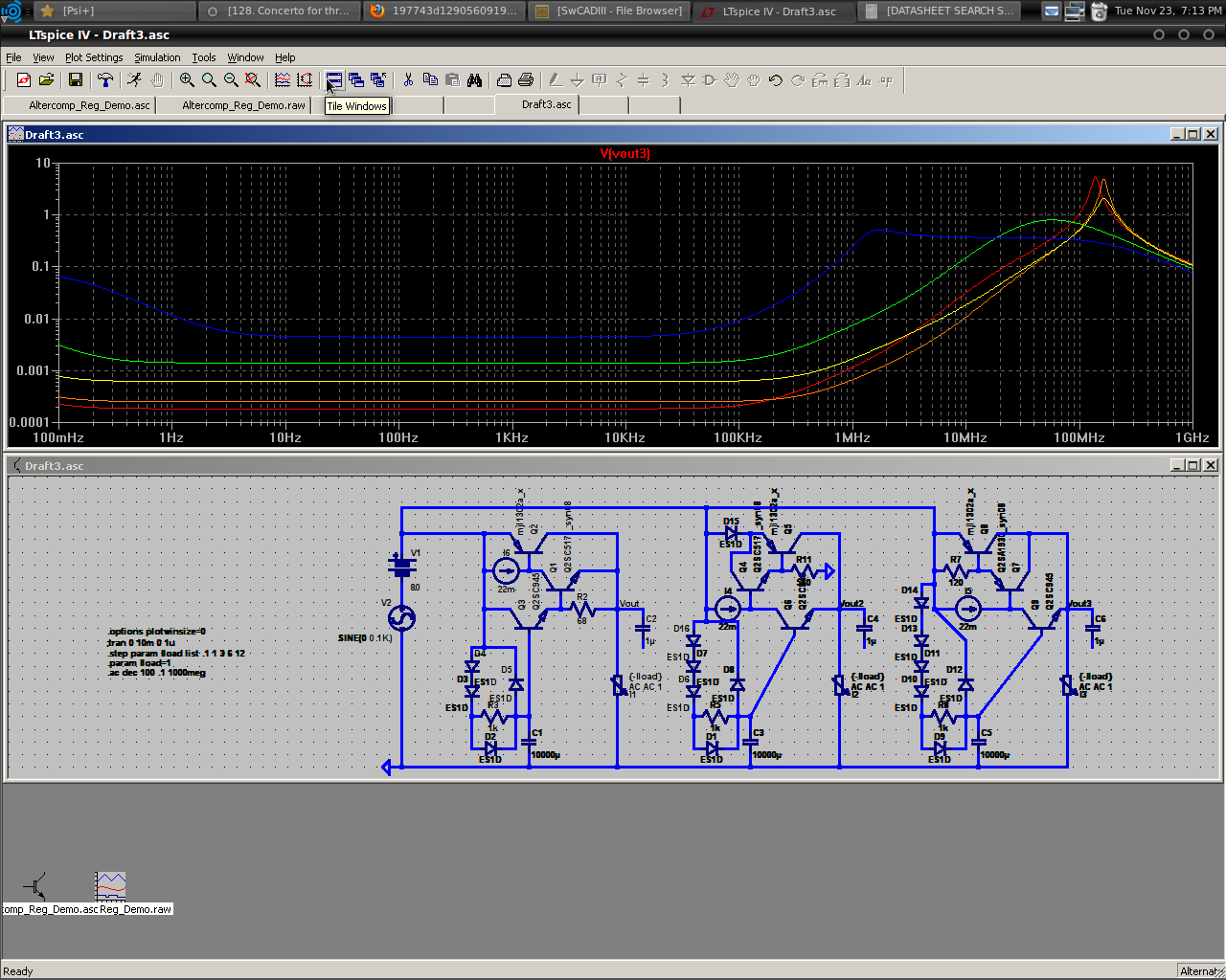

A jfet current source will improve specs dramatically.
- keantoken
The color scheme is no different than the last image. If you can't read it, hover the mouse and you will see a zoom button in the lower left.
Perfect or not, some sort of current source will improve performance. That was the point I intended to make.

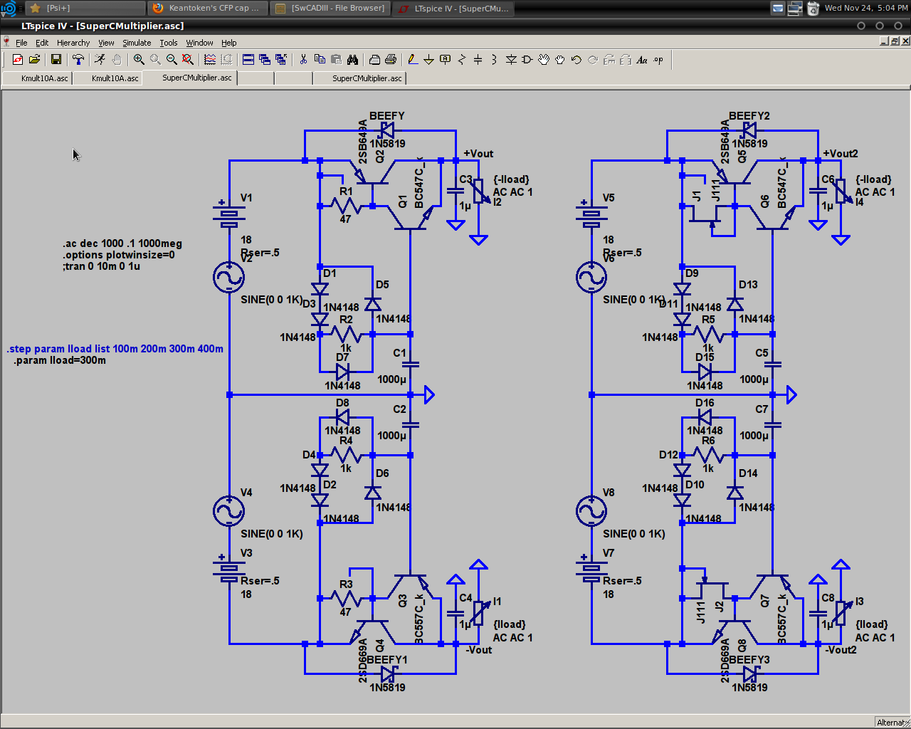

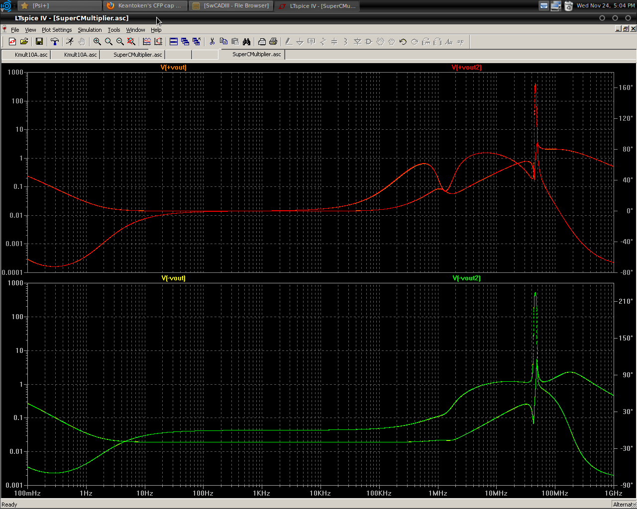

I'm switching gears to the 300mA version again. I was conservative with the original design, but as it turns out, being conservative has bit me in the **** every time. The single best thing you can do to increase performance is to increase the current through the driver transistor. This increases the transistor's transconductance, which the slave's impedance is divided by to produce the final output impedance value. I put the maximum at 20mA, as this is as far as most good small-signal TO92's go that still have good Ft. Decrease to 15mA, considering the Ib of the outputs.
A Jfet should decrease noise, but I don't know much about that. In any case we need a Jfet with low noise and high Idss (20mA max), and tempco is not important.
BTW, my 2SC5171 and A1930 models are VERY broken, I wish I had seen this earlier. I've substituted different models.
Schematic and Zout plots at 300mA. There is actually little difference between the resistor and Jfet. I think this is because at such low currents, there is little voltage variation across the resistor.

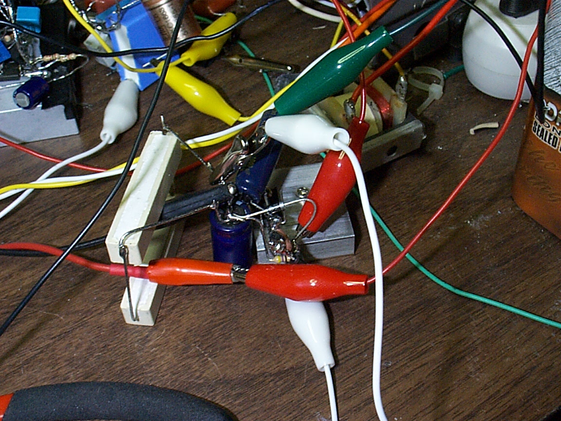

Here Joshua, I built it, and it works EXCEPTIONALLY WELL!
56db input isolation, which was better than last time (tested at about 200mA). Input ripples are 63mV, output are 100uV. Noise is >10uV as far as I can tell.
Josh has a point, but despite that others here don't mind me posting untested schematics just to see what I've been doing as of late. This forum is a casual place, so if you want a scrupulous design team you'd better say so from the beginning, before the mood of the thread is set.
I have to extend great thanks to HiFi as he spent his own money to get me the parts this reg was made from.
So the question is, why were HiFi's results not as good?

Also, the circuits in post 146 are not unstable, in case anyone got the wrong idea. I just built the resistor version (still don't have jfets to test), and it is close enough to simulated specs to satisfy me. While the Jfet version hasn't been built, I'll put my money on it.
I used 1000uF for the reference capacitor, and the same for the output capacitor.

I will send you my wiring guide to you when I get home today, you may check if the wiring is correct. Because I have built two boards with identical result, each has both rails, it is not possible to be a cold soldering joint or wrong connection.
It is possible that my measurements are crapy / my oscillioscope is crapy.
In any case, I am very pleased with your result. You have built it and proved it achieving good result very close to simulation. Other builders should use your result, not mind.
Although I got only -3XdB something (in my possibly unreliable measurement, or perhaps it is better), subjectively it has already produced a giant step forward for my Marantz SACD player, now comparable to the very best players IMHO.
