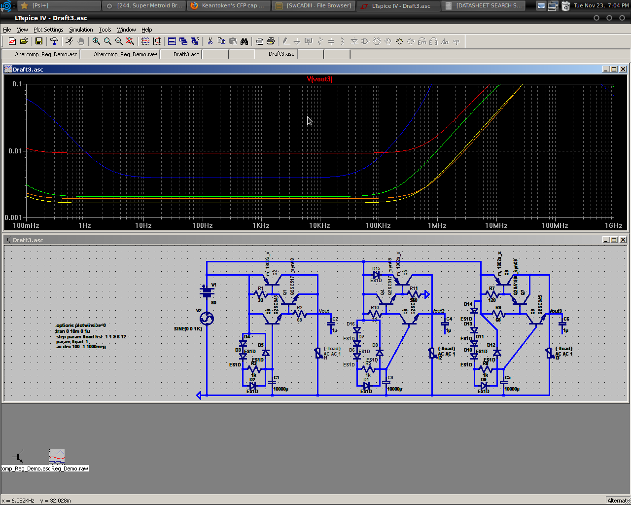

As far as the power k-multipler, you are right with your reasoning. It is important that the reg doesn't have too good bass isolation, so that when the input dips, the reg can track it without saturating. However with the slower devices that will be needed, output impedance at HF will suffer. This doesn't include what may need to be done to stabilize it if it oscillates.

kean,
From the initial simulation you posted I thought that the rolloff point was below 10Hz. If it is at 100Hz then I could use a capacitor larger than 1000uF for C1. I have run out of 1000uF so I am using 820uF. Would 2,200uF be OK? I have a couple left.
The ripples at the output of the rails look smooth, far from being jagged or toothy, and they are at 120Hz. So I see no chance of getting oscillation.
If I add another diode to the string, I expect the output will drop for another 0.56V or so. I can't afford this, as the existing Marantz reg requires some voltage drop to regulate (now given only 2.8V). currently, with the K-Muliplier in place the Marantz reg's input is 14.1V and output is 11.3V. The low voltage drop of 1.6V of the K-Multiplier makes its application possible. Fortunately, the load is constant current draw so things are predictable and the Marantz reg should not run out of headroom, given the output ripples of the K-Multiplier being only a few mV. All other circuits have no chance, unless I replace the Marantz reg completely.
So in conclusion, although the K-Multiplier has not reached its simulated result, it does provide some 30dB+ ripple rejection with low output impedance and low voltage drop, hence serves the Marantz very well. I am happy to live with it at its current state.

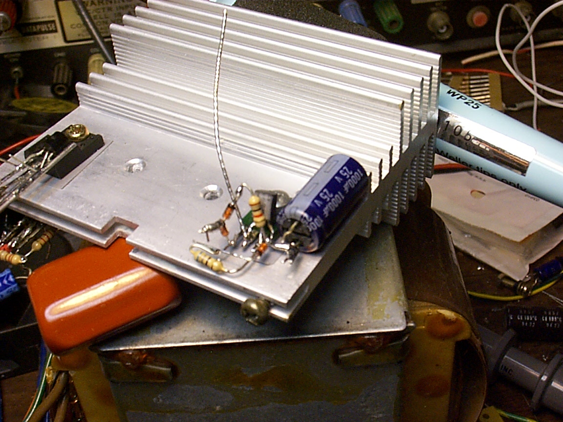

Okay, a less wimpy way of testing my own circuit is in the works.
Using a 2SC945P and the only PNP suitable power transistor I have, the 2SB772. Testing with 1N4148's to see if they explode at turn on (My guess is yes).
- keantoken

The multiplier is up and running. Oscillating into a 1uF mylar film. Since your output filtering is so good, the multiplier may be oscillating it's heart out and you won't notice. The last thing to try I guess, is to remove any film caps you have at the output. I should have thought of this before.

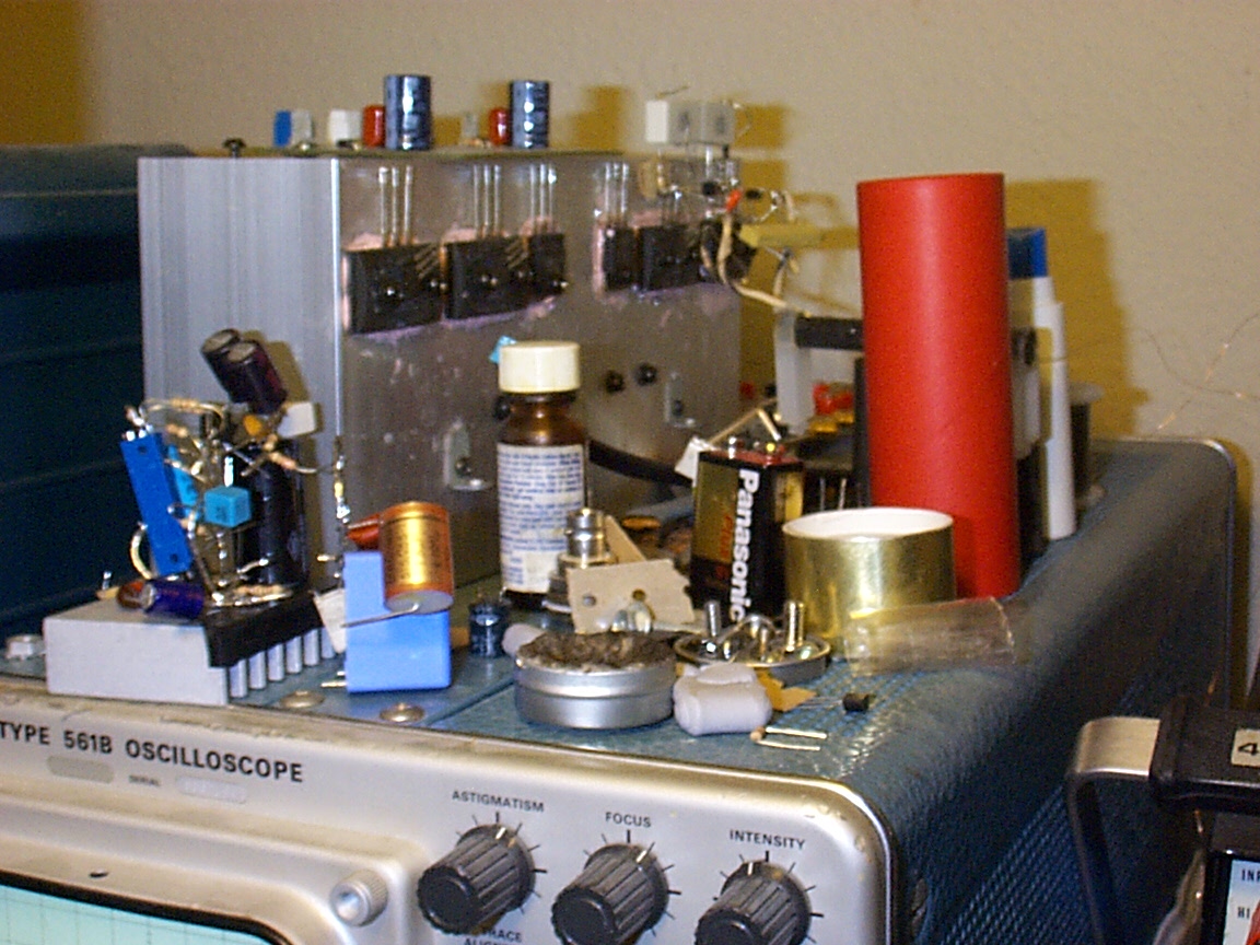

Okay, I switched out the mylar output cap with a 1000u electrolytic, something with peach colored gibberish written down the side so it's got to be low-ESR. So far oscillations are undetected, or at least I can't distinguish them from what is usually propagating through my house.
Measured properly with coax with my 561B, output is rock solid, and shows >20uV pk-pk noise+anything else, with little drift. Slight ripples is visible above the noise. I think that's pretty good!

Lol, current draw is... Zero.
I just wired up a 50 ohm resistor, will test with that, then measure ripples.
Okay, I just did that. Input ripple is 20mV, output is 50uV. That gives 400, which is ~52db input isolation. Still underwhelming considering simulation... But good nonetheless.

HiFi, it turns out you have good timing. I just blew up the prototype.
So it looks like that is that for now. However I did get to look at the ripple for a few seconds with 200mA load, and everything appeared normal.

From 58dB theoretical to 52dB practical I don't see anything underwhelming IMHO. That is about what the CFP does for filtering with practical parts it seems. Now if you wanted something like -60dB real, maybe you could make it RC, RC, instead of straight 1mF C1. If you want the low Zo and a super line regulation practical figure in some application, couldn't it work with two CCTs in a row?
