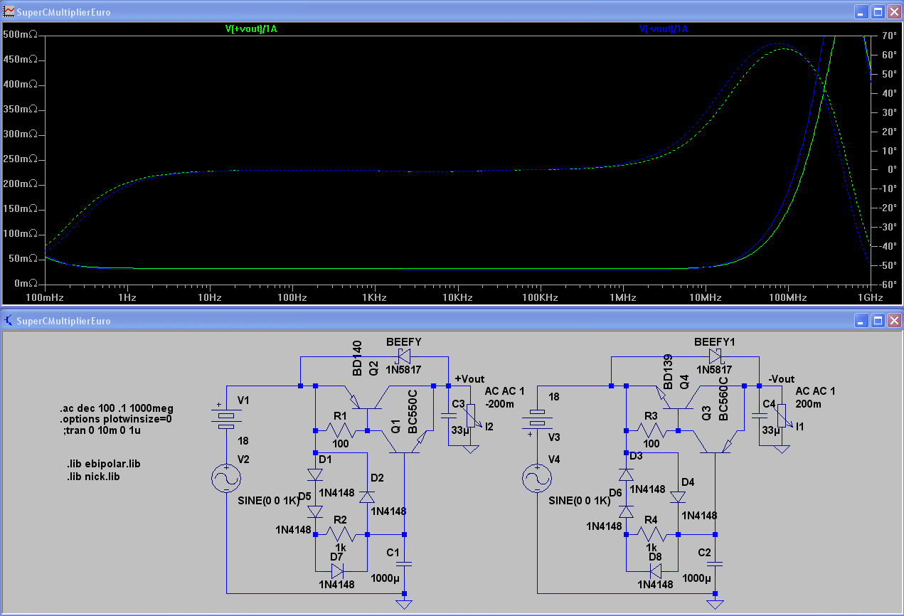

kean, no need for complexity. Ue the same number of parts, just rearange them.
Make Q2 NPN. Make Q1 PNP. Swap positions of R1 and Q1. R1 to the right, Q1 to the left.
I don't know what you mean by less complex, if it has the same number of parts?
There are many things you can do with 2 transistors and a resistors, but few of them will show less output impedance than a diode. It looks like this proposal will make a buffer more suited to driving the base, which will make it fast, but the output impedance will not be any better than the usual capacitance multiplier.
One argument is that Q2's base is driven current-style by Q1. If Q2 demands more Ib, it first has to get it from R1 until NFB catches up and Q1 can respond. If the load happens to have a low impedance, then it will actually see Q2's Cob through Q1's emitter. I don't think one can remedy this without decreasing input rejection.
If we want more input rejection, we need some form of cascode. The main culprit at DC is Early effect. Vbe changes with Vce because Vce changes Ib, blah blah...
In short, to do better I doubt we can maintain a low voltage drop. I don't think we can get past the input rejection "floor" without a fancy cascode.

Technically, I have not been able to get it working 100% as simulated. The first one (with the better 2SA1930 and 2SC5171) put in the player had a near flat negative rail but about 6mV ripples (peak to peak) on the positve rail (of the frequency corresponding to the rectified mains frequency). I failed to find any problems with any parts so I built a second one with completely new parts. The result was the same. Ripples at input is about 400mV, current draw is about 300mA, ripples on the negatively rail output is definitely less than 0.5mV, while on the positive rail 6mV. All other voltage measurements show identical numbers for both rails.
Before I plugged it in, I tested it on resistor dummy load of 390R (about 40mA constant current), and did not find any problems. Both the positive and the negative had a nearly flat output. Measured figures on the positive rail are as follows: input rectified mains ripples: 100mV. Output current draw: 40mA. Input voltage: 18V. Voltage on R2(1k) after two diodes: 17.2V. Voltage at the base of pass transistor: 17.5V. Voltage at the bass of driver transistor: 16.2V. Voltage at output: 16.5V. Basically the same absolute numbers measured on the negative rail.
Any ideas?

Maybe you need even heavier filtering? Like cascading two in a row.
P.S. Can the NPN-PNP have differences in Rbb' that are not accounted for in the simulator, Kean?

Salas, it is possible that the driver transistor has less Hfe than I accounted for (Rbb shouldn't affect performance unless grotesque, AFAIK). 300mV across the 1k resistor means 300uA, which is too large. This current may turn on D7 which will drastically reduce filtering. You can try using another small-signal transistor. However it is equally possible that the output transistor has low beta too, or has worse specs than the datasheet.
1: Remove R1 and see if performance improves.
2: If not, try replacing Q1 with a different TO92 with higher Hfe.
- keantoken
Was referring to Q2,Q4. Can their Rbb' play a role? Q1,Q3 must be high hFE & low noise, no doubt.
Wait, voltage at R1 is 17.2 and at the base of Q1 is 16.2? This means 1V across D7, which means something is shorted or broken.
