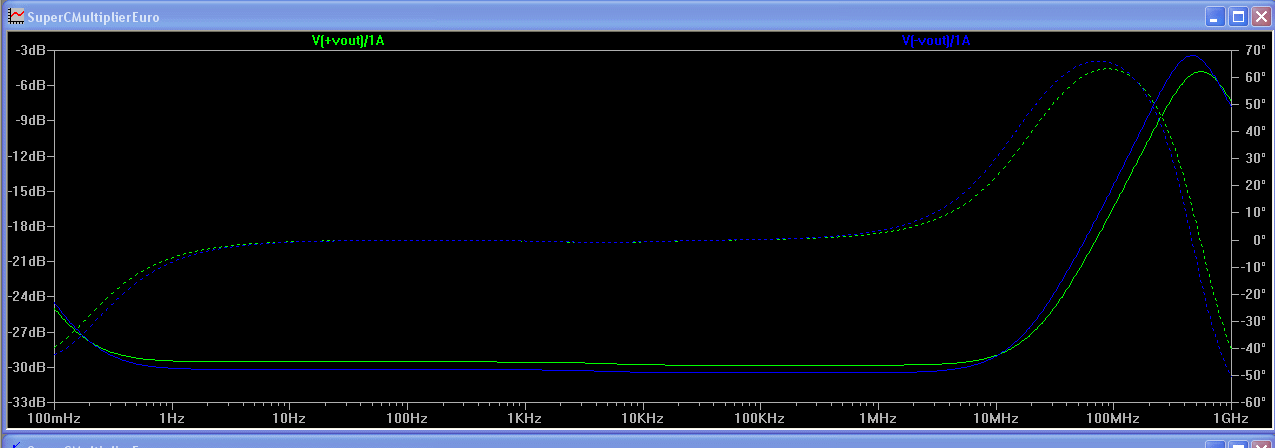

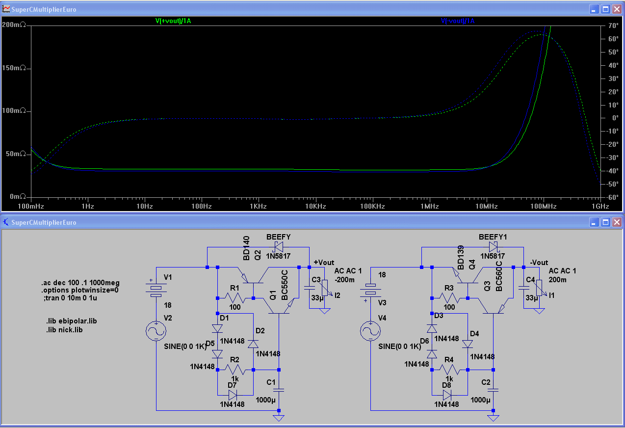

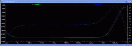

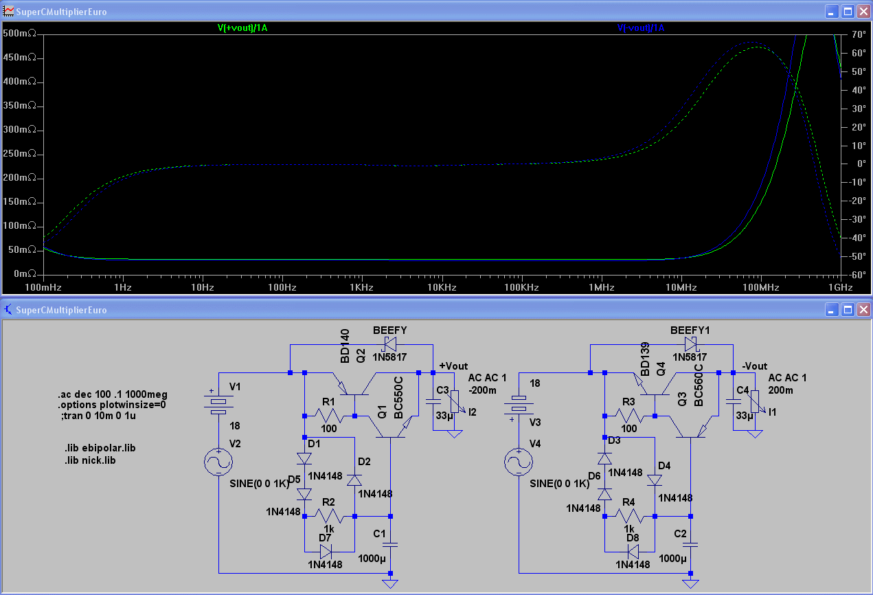

Don't know if the Fairchild models for European classic BJTs are as good as their KS series models but here it is again with BD139-140 BC550C-560C and Panasonic FC 1000uF/63V & 33uF/63V data sheet impedances. For what it may worth.

But it wouldn't be better Zo than the shunts either so to use it after. Not where many stages with enough signal differences are involved. For local residual power line noise filtering of low signal stages of no PSRR, maybe.
I designed the circuit around what was needed or wanted at the time, which were in order of desire:
low voltage drop
good input isolation
low Zout
The main concern was to be careful not to upset proceeding circuitry. This needed a predictable low voltage drop, which I set by relying on diode potentials. For ultimate input isolation something like Iko posted (double or cascoded C-multiplier) would be best.
HiFi decided to adapt the circuit for use in his system and it has/is undergoing refinement. I think Salas' idea to use the BC5x6 transistors is a good one.
For the moment I feel content to think of it as a modern update to the traditional C-multiplier. While the original fulfilled its function well enough in textbooks, the field finds it wanting in output impedance. The most compact solution to me was to use the CFP.

Storm, the 100R resistors could be replaced with Jfets, with some reward but I wanted the circuit to start simple BEFORE getting complex. This way it could be lashed up quickly by less adventurous folks.
I support any refinements, but maybe someone should start a new thread about it.
- keantoken
And as Andrew pointed out, the devices dissipate minimal power. This is intentional.
The other reason for D7/D8 (besides quick start-up time), is to that the full startup voltage isn't applied across the output transistor during startup, possibly into a large output capacitor, easily exceeding SOA. The diode limits this, making it possible to use the regulator even at higher voltages then the transistors are rated for. This would seem to be bad policy perhaps, but if the Vce goes above a few V then something is already wrong with the circuit.
