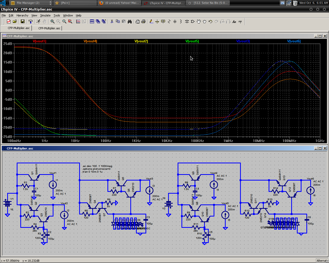

It still acts to multiply capacitance, with the same drawbacks in that regard as a normal multiplier. The difference here is that the output voltage has been largely shielded from variations in supply voltage, via filtering (CCS, capacitors, diodes). In this case bass extenstion will be the best, because of the high source impedance (CCS) which will give the capacitor/s a large time constant.
I like your circuit Storm, and using the CFP will improve it's performance quite a bit.
I was right, NPN BJT is better, but CFP is still worse for HF impedance.

It looks like in StormSonic's circuit the capacitor can be eliminated completely with little impact on performance, except perhaps noise.

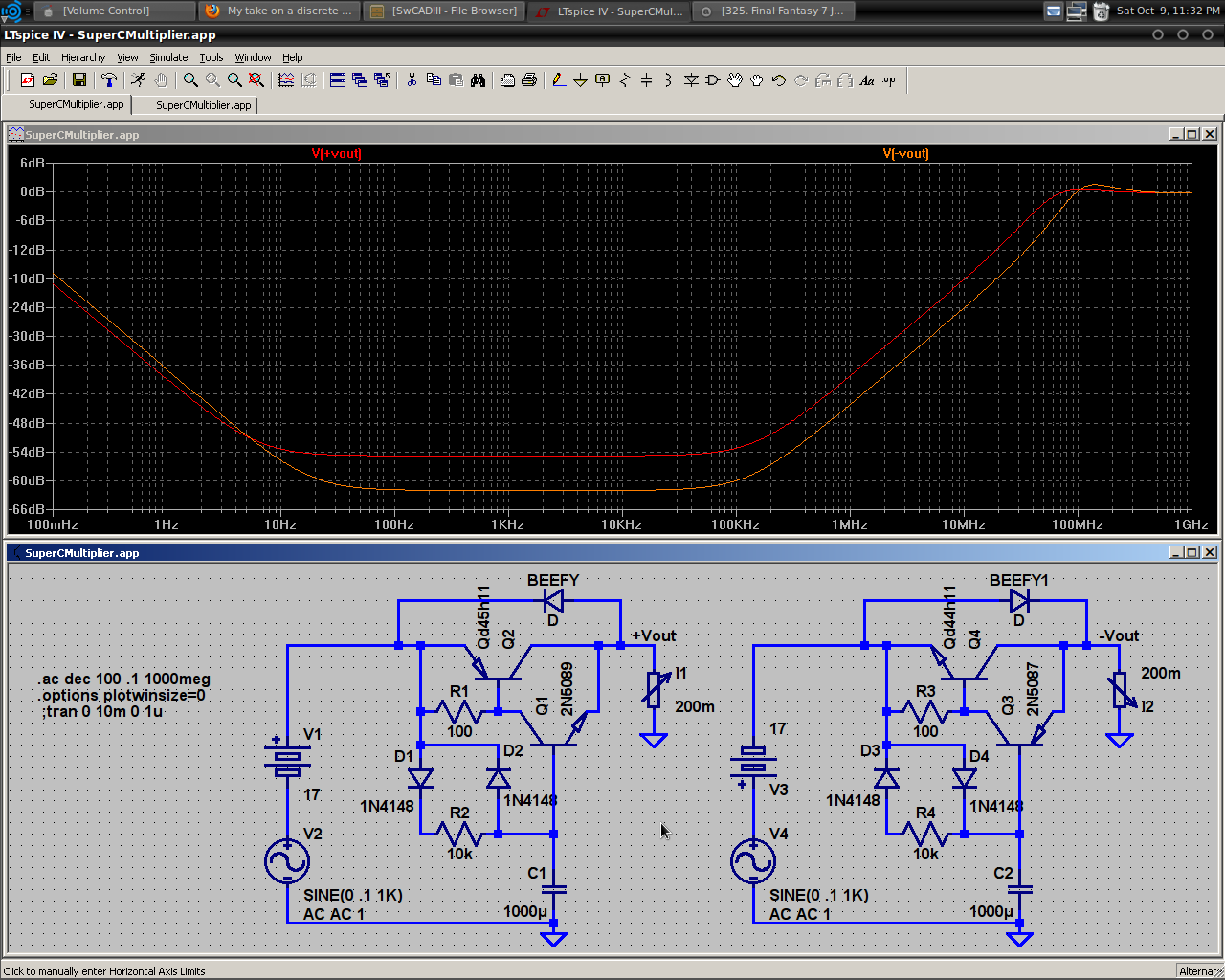

This circuit has the lowest voltage drop and output impedance, with a good PSRR of -54db. If higher voltage drop is allowed, better specs can be achieved. I doubt this is necessary though.

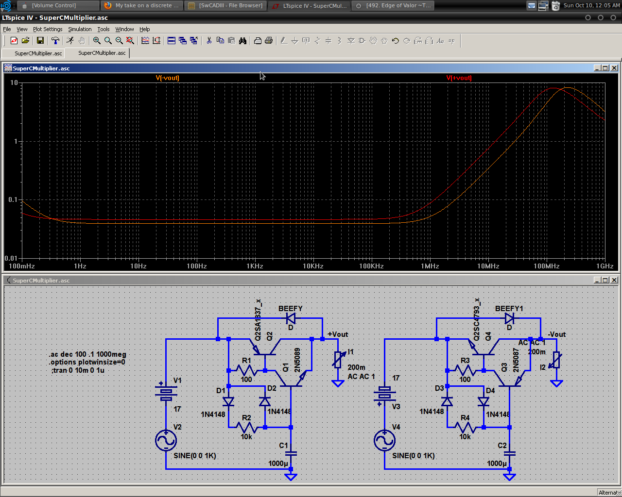

Here is the output impedance using the 2SC4793/A1837 pair

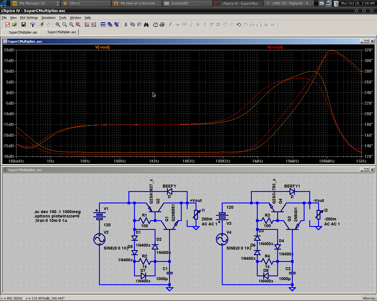

The K-Multiplier is born
Okay, here goes...
I have been consulting HiFi to create a preregulator that matches his application, and this is what I came up with. It is pretty much a Hi-fi C-multiplier. I call it the K-multiplier.
It will handle any load up to 1A, because the voltage across the outputs is limited to 2.7V - 1A*2.7=2.7W. I would not recommend drawing more than 200mA, since this gets into the outputs' low-beta region and performance will drop.
Voltage drop is about 2V. This can be decreased to about 1.3V if we bypass, say D5. However, a large drop in input will saturate the 2N5xx1 transistors.
This is designed as a prereg, not for high-ripple conditions. It is to improve the performance of later regulators. It will work in high-ripple situations, but you should add diodes to the string D1 and D5 depending on how much ripple you have.
HiFi encouraged me to post this here, and I might as well post the finished design, so someone can spot my errors...

There won't be any measurable degradation from using a 1000uF cap that I can see.
100uF is totally fine, the bass at audio frequencies will hardly be affected.

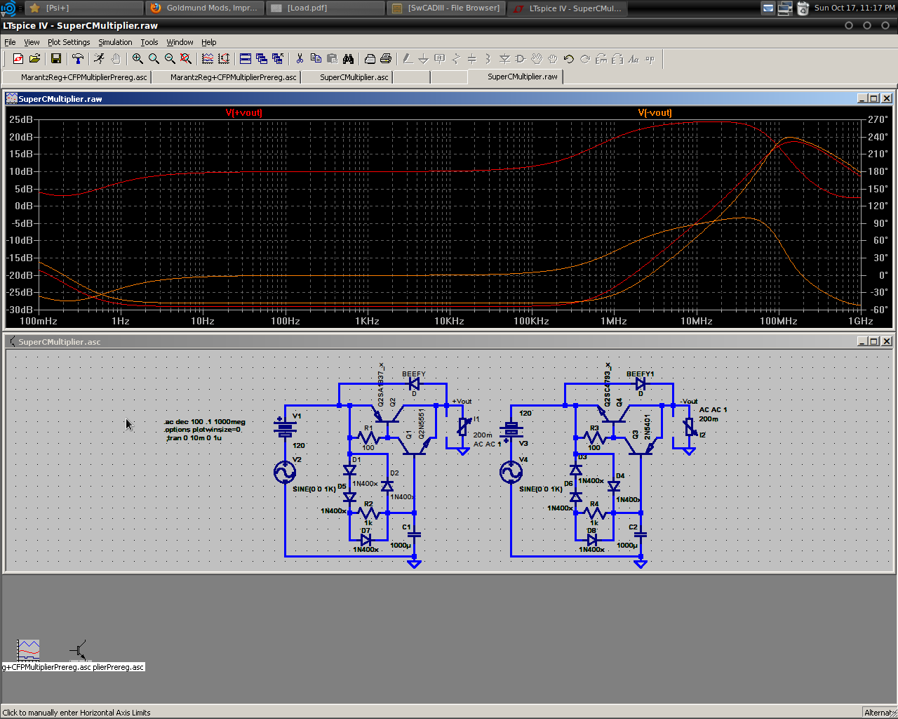

reversing that diode seems to make a big phase difference.
Why is the PNP performing better this time over most of the frequency range?
