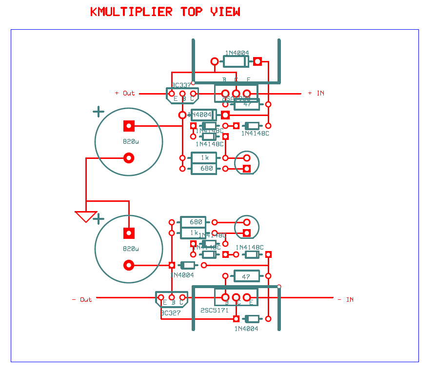

I am now building the k multiplier to feed my latest paradise build.
I am doing it by the book and just finished positive K.
I plan to use it in the psu just before the 15000uF smoothing caps..... Are there any issues I should be aware of because of the large caps ?
I am using 380 hfe BC337 and 327 because I did not have any 25 (only 40 leftovers from the paradise) hope it works as well.
Please have a look at my layout

On my Kmultiplier webpage in my signature you'll see that I have a "design considerations" section. There is a simple equation there that describes how to size R8. Work that out and tell me what value of R8 you get.
Acording to your calc:
25,2 Vin-4.8 15000uF Cout
680 R8 940uF C1
0,037058824
37,0mA
15000/940 = 15,9
37 x 15.9 =591mA
I have 590mA
It is below 1A so I guess it is ok

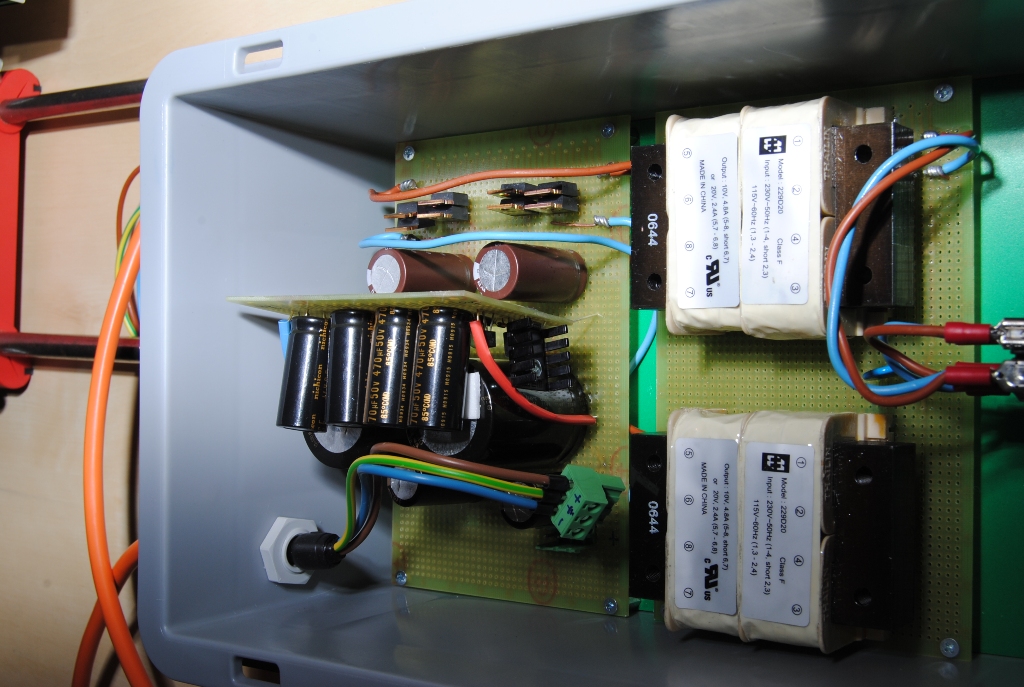

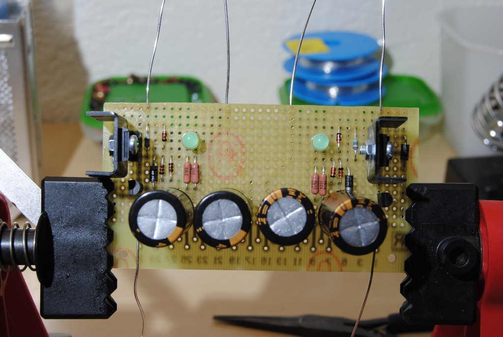

Just finished implementation.... it works perfectly and appart from lowering the noise floor it also provides a very usefull turn on time for the riaa amp.
Noise is much lower than my previous crc setup.
Sound wise it is also very good.... I notice an overall increase in detail retrieval and did not loose any of the "byte" I am already used to.
Thank you so much for sharing such a good schematic.
Indeed... I followed my reasoning after reading your documents and although initially I was afraid I would loose some "snap" due to the extra filtering the final results proved my doubts to be unfounded.
The paradise keeps it's very good bass presentation while presenting much more detailed and fluid highs. (this also proves that the paradise shunts can surely be improved with better termination caps, because the circuit reflects whatever we have behind it).

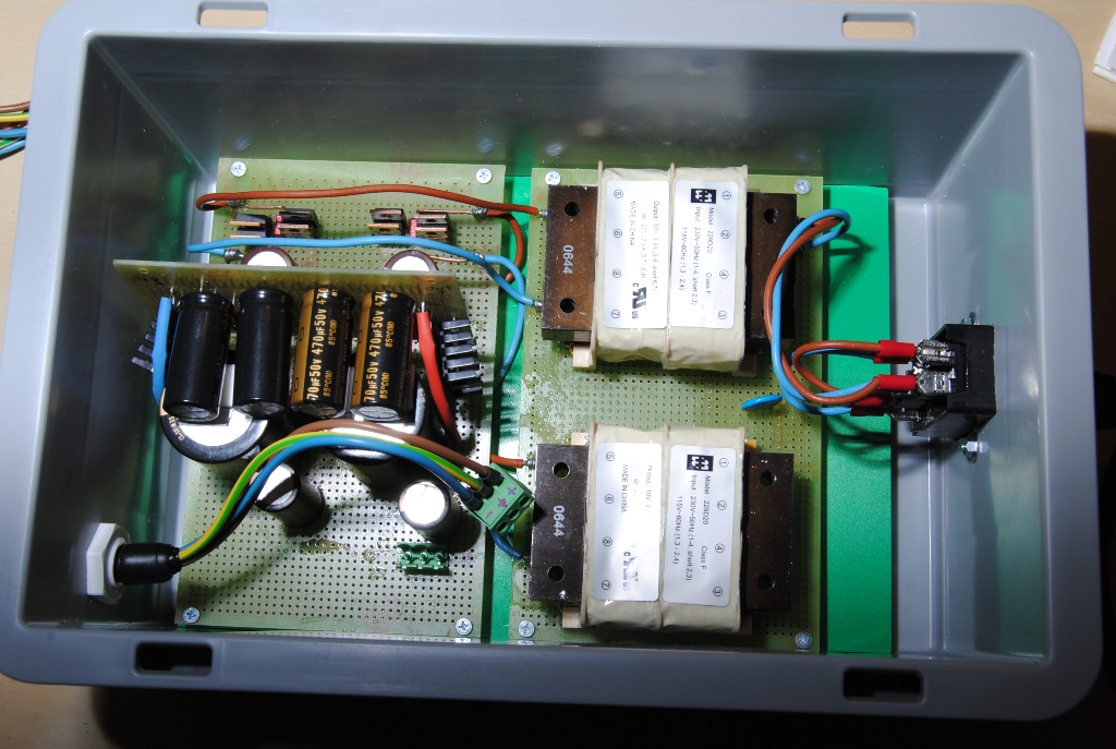

Now I will try the same circuit in my uber folded build.... (it will take a while because due to the kmultiplier vdrop I will need new 18V transformers).
In the folded case I already discovered the benefits from using a higher VA R-core tx and better smoothing caps.... will now see if it can be improved with your circuit.
