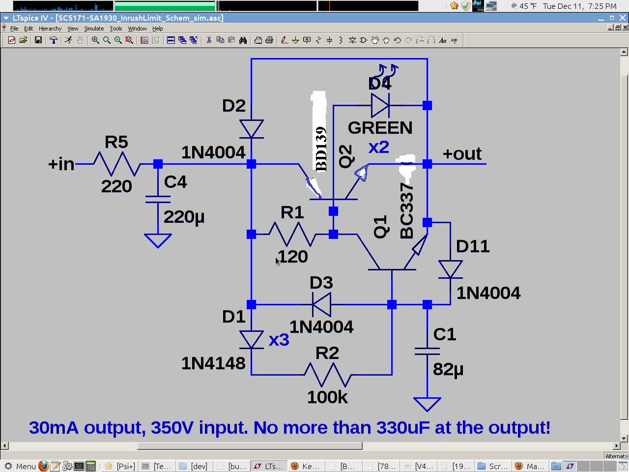

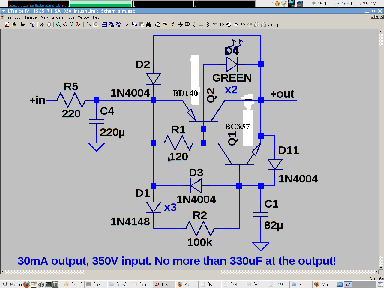

Q2 needs to be a PNP! The BD140 is the PNP version, right? Emitter goes to input.
The BC637 is not a version of the BC3x7. If you don't have BC3x7, use BC5xx in the highest gain grade you can find.
and take the C extension
