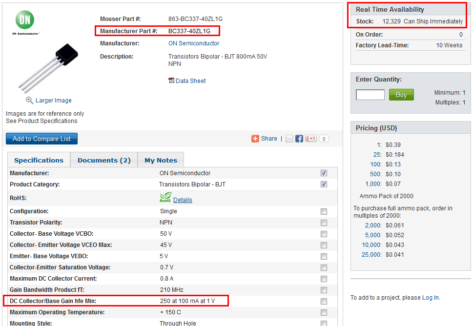

I can work on it, but I've run out of 2SC5171/A1930, and I've only got a few BC3x7-40 (OnSemi) left. If someone can send me some of these I'd be really grateful, but otherwise I can't say when I'll be able to work on improvements to the Kmultiplier, and other things.
If you are curious whether devices like the 2SB649/D669 or BD140/139 or whatnot will work, I'd be glad to test them if you can send some my way. Note that the BD140/139 are different depending on which manufacturer. If you send me something, be sure to say what company it came from (as well as retailer) otherwise the results may be deceptive.
For x=3 , Mouser can send you twelve thousand of them, image below.
They also have 4,500 2SC5171's from Toshiba, and 2,600 2SA1930's from Toshiba.
Mouser ships from Ft. Worth, Texas so the postage ought to be inexpensive.
I've used mouser tons of times. Money is precious though, so like I said, unless someone is really interested in my ideas, it will have to wait indefinitely so I can order in a large batch.
