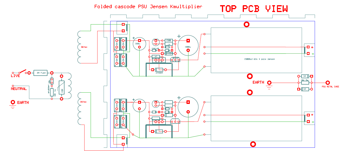

I am now building a kmultiplier for my folded simplistic.
The 36Vac TX will output 51Vdc after rectification and the smoothing cap is 15000uF so if I use your circuit as per the pdf with stock values I will get a 1,2 amp inrush.... no good.
Can I use 1000uF for C1 (instead of 820uF) and increase R8 to 1500 ohm (instead of 680r) to reduce inrush current to an acceptable 470mA ?
Thank you.... will report back by the end of the week 🙂
Please let me know about my layout.....

You may check the value of the first capacitor 330uF. It may be too low. The K-Multiplier can be tuned to have various input ripples. If the ripples are too high for what it is tuned for then the KM will not be able to smooth out the ripples. I used 6800uF or something as the minimum for 300mA load and a 1.3V drop, or somthing like that. You may scale these numbers. For an example, if you have 100mA load, you can reduce the cap to 2700uF, etc. But unless your load is very small 300uF may be insufficient.
Also, if you are not looking for the absolute minimal voltage drop, you can increase the 1N4007, as in Keantoken's original specification, you should use 3 x 1N4007 in series. If you really want to use a single 1N4007, you will need to increase the 1k resistor to 6k8 or something.
On the other hand, the output should usually not require a capacitor as large as 15000uF, because the KM should be fast enough to supply to the load. I think 1500uF should work very fine.
Good luck.
Bill
I see 3x 1N4148 in series, which is correct.
Other than that, Bill has plenty of experience with the Kmultipliers sonically, so his advice is a good bet.

Now following Bill's pitch, I placed the kmultipliers after the 10000u smoothing caps, followed by small 470u Silmics.
Powering the folded simplistic immediately brought very good results. Smooth rendition of low level detail enhances stereo soundstage presentation.
One issue remains... I have low level hum that is not present when using a "normal" psu.... maybe the 1.7V drop is too much for this implementation.... I get a very small margin to power the V12R shunts because I am using my bench 30vac psu TX ....
It is hum related with mains 50Hz.
Due to the very simple layout I was not expecting it also.... It is very low level (can only hear it with the amp at full steam and my ears very near the speakers) but I do not get any using only the "normal" RC smoothing setup.
