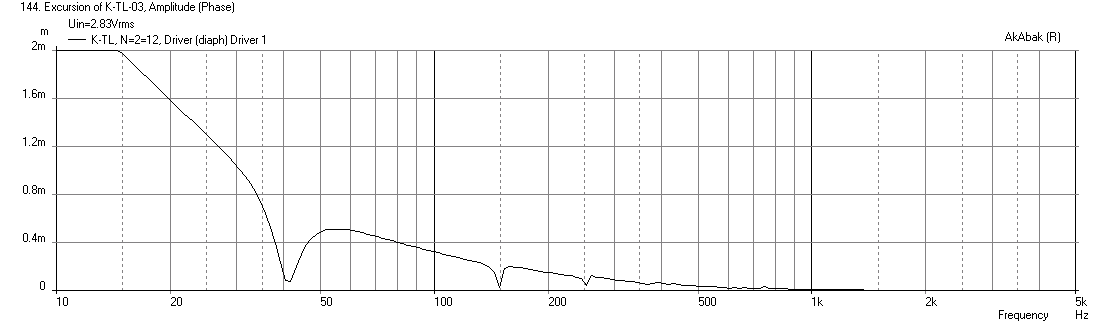

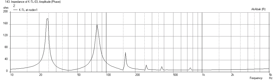

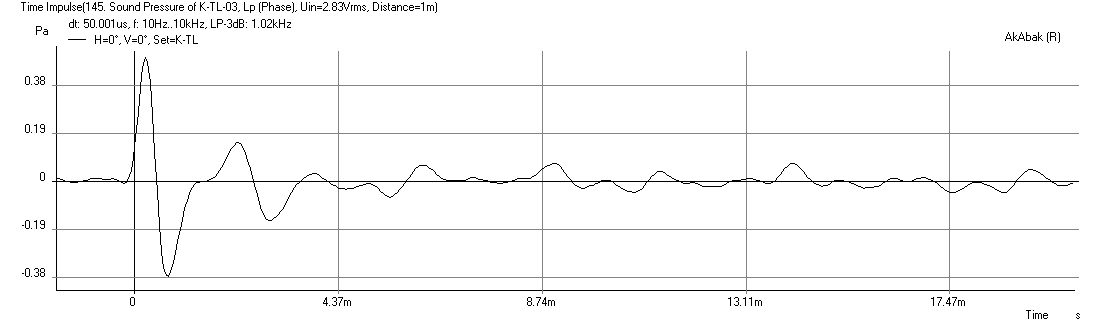

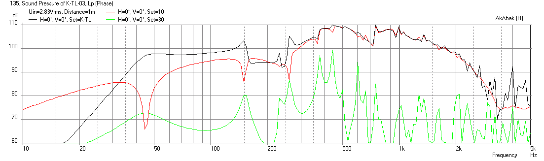

of course, the nominal Re of that blue cone driver was the give-away😀 would a 12pe32L with its low qts be too lean and bumpy in a similar bulk Karlsonator? http://www.parts-express.com/pdf/294-660.pdf
12PE32 sim
Freddi,
This is a very nice driver and it does quite well in a stock Karlsonator (first plot). Second plot is impedance, third is cone displacement (hardly moves), and last is impulse function. I think reducing Vb can improve response since the Qts is very low.
X
Freddi,
X
