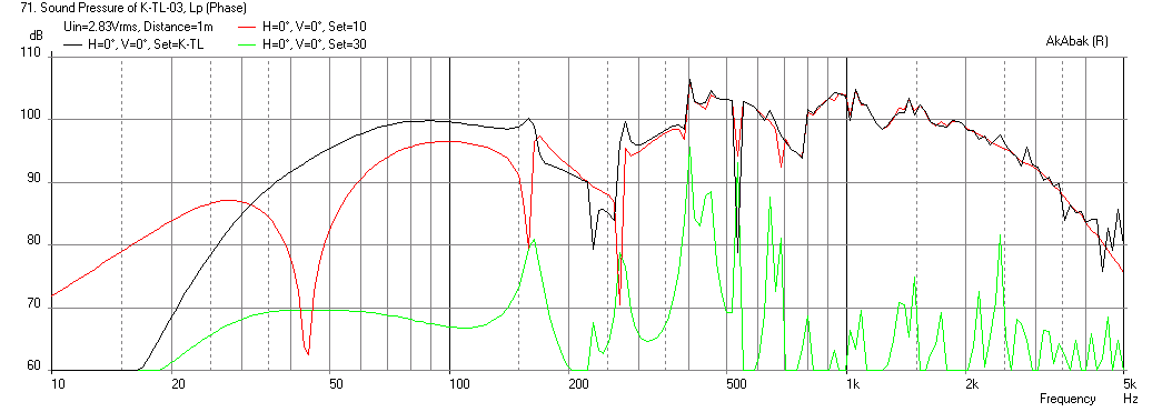

X - have you already simulated BetsyK in the "Karlsonator 8/SuperT##$"? does it go a bit below 50? BetsyK has very nice vocal production

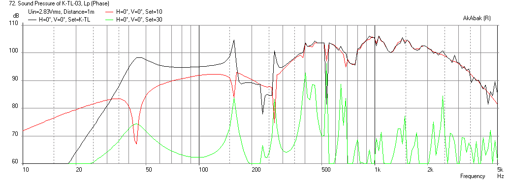

The Betsy K can work in a Karlsonator 8 (aka, Super TW@T) but it does not have a flat bass shelf. However, there is still a lot of output at 50 Hz. I approximated the Karlsonator 8 by scaling the fullsize by 0.95 in vertical/depth and 0.87 in width.
I will run the FE206EN when I get to my computer. I have been eyeing ABEC3 - which combines AkAbak's lumped element model with finite element analysis so that you can put in true 3-dimensional effects. This would be real interesting to see what is really going on inside the K15. Is it a DCR with hybrid BVR or a ML-QWTL? Also, the full impact of the Karlson aperture can be simulated and effect of spatial dispersion and directivity can be seen. Can't justify buying it as this is hobby and demo version doesn't let you save.
Thanks for the replies! xrk, which karlsonator did you scale up for your sim? I like that one as I will be using this in a room and could be placed close to a wall.

FE206EN in 8 inch Karlsonator
Freddi,

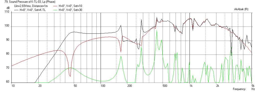

Here is the sim of the FE206EN in an approximation of the Karlsonator 8 (scaled length and depth by 0.95 and width by 0.87). The frequency response looks good - it has a nice flat bass shelf with a little bass peak overshoot at 45 Hz. The impedance has some really high peaks as expected from low Qts high Bl motor - this will need an amp capable of high impedance loads - like a tube amp. The driver cone displacement, however, is problematic - it is in a runaway mode below 45 Hz. You will need a line-level high pass filter between the preamp and power amp (or a big fat cap at speaker level) or you risk blowing the driver with more than a few watts at 30 Hz. The stated xmax is only 0.8 mm.
If you were to scale the original Karsonator by 0.90X in depth and height and by 0.80X in width and the vent by 0.80X additionally, you can get a pretty nice response - last plot. The displacement is somewhat reduced.
not shabby! - how about the strong motor FE206EN in the same Karlsonator? fwiw FE206EN was punchy in the old K12 and sounded better on a Chinese drum CD than my Klipschorns - - - here's something - does it link up with akabak?

thank you very much - the tweaked graph looks very good and pretty deep response

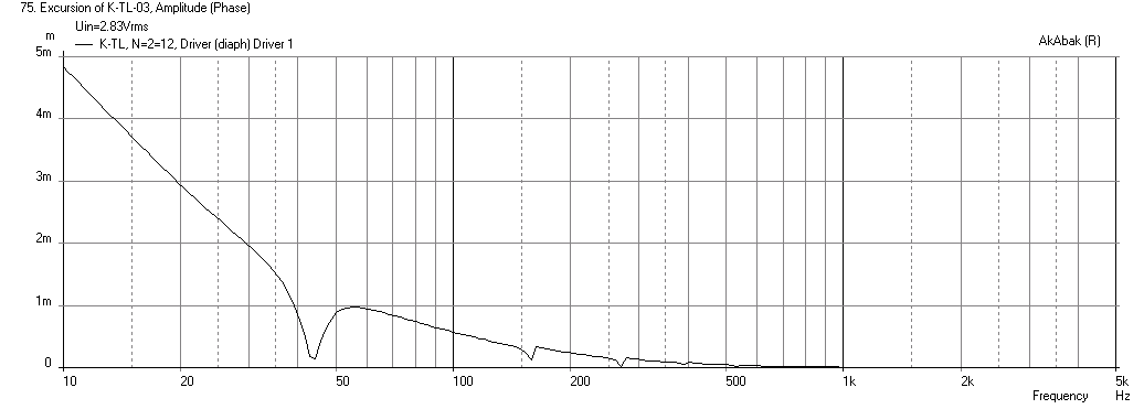

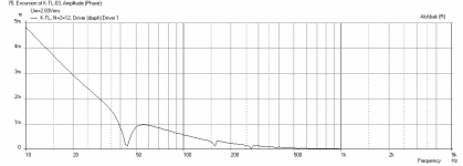

in practice, FE206EN is well behaved in a Karlson K12 and with the material I played (all digital - no turntable), no problems with excursion with an AlephJ clone or even my 250 watt Crown.
FE206EN was well behaved in the K12 - moreso than W8-1772 which was somewhat less "loud" - I'm not sure it was the longer stroke of 1772 or its lower Z pulling more power below cutoff but the Fostex barely moved even at goodly levels on drum - watching 206EN and listening, I'd give it 2mm useful one-way stroke (may be compressing). 206EN is my overall fave fullrange driver so far for the classic K12. 1772 liked a smaller ("SK8") K-coupler - it was kinda like K12's rear chamber was too large for best power handling with 1772. On some material, 1772 would move quite a bit further than 206 - but it wasn't useful motion. A good classic K will make a lot of sound without much if any visible cone motion - probably has something to do with driver compliance of course.
in the Karlsonator8, a high pass filter may be helpful
