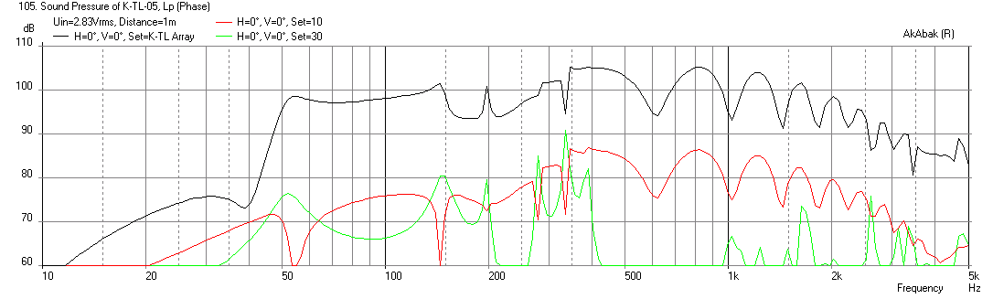

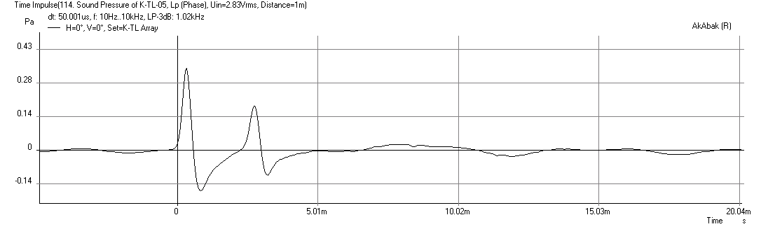

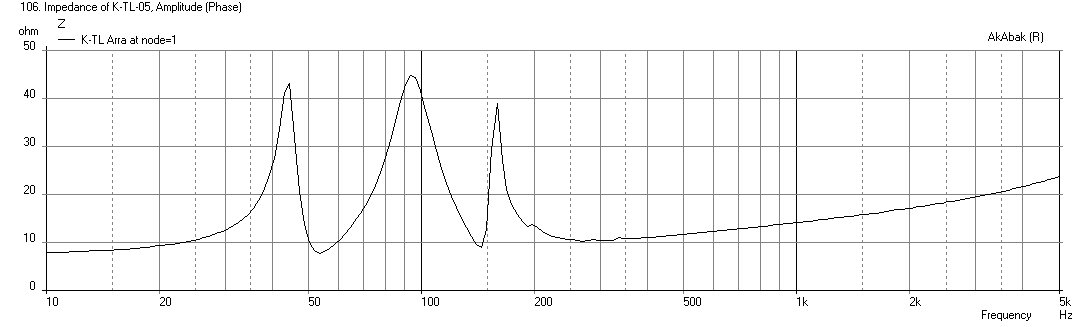

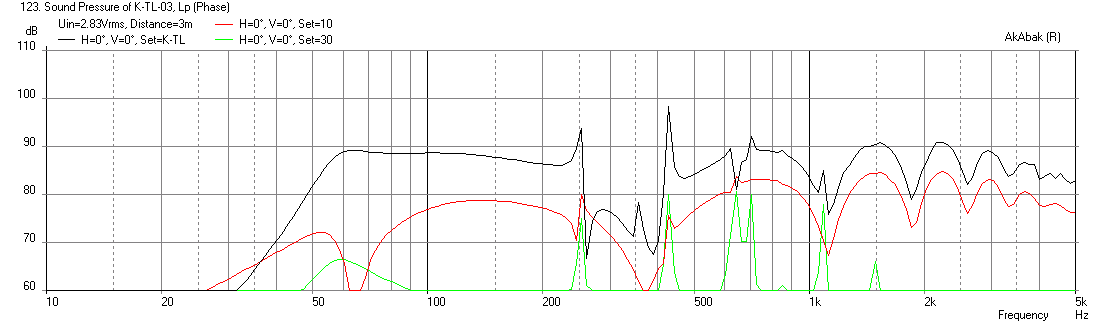

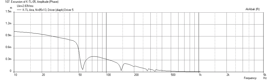

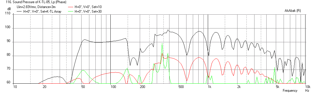

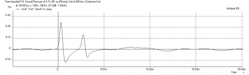

I ran this rather interesting simulation of a driver that has been around for a long time. It is a 3x3 array in a Karlsonator that is scaled up by 14/12 overall and scaled 1.3X for the back chamber volume, and additional 2.3X for the vent (top channel area). So really, a highly modded K'nator... If you look at the frequency response curve for 1 watt at 1 meter, you will see that it is very efficient, the impedance curve shows that it is a nominal 8 ohm speaker as presented to the amplifier and the impedance is all very manageable with low impedance amps, the cone displacement curve shows very little cone motion - 0.4 mm above 50 Hz. The next plot is the impulse response which looks very clean - should have great transient response for drums. Last plot is the freq response at a typical listening position of 3m. Anyhow, I think this is an interesting option for a Karlsonator, and one that has the potential for great HF as it is a 4 in nominal driver. If you have not figured it out by now, and I tell you that all 9 drivers are wired in series. With this info you should have figured out what driver this is. 🙂

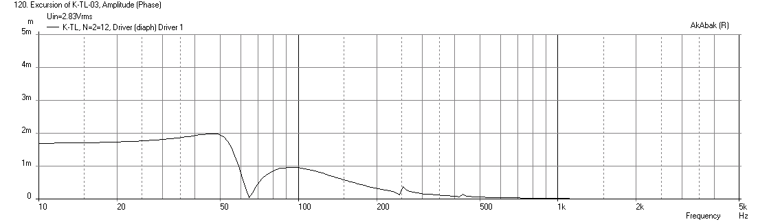

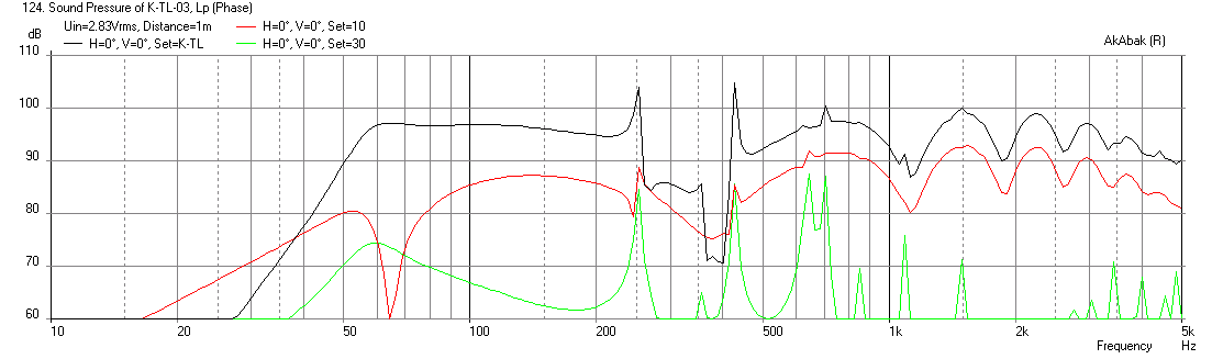

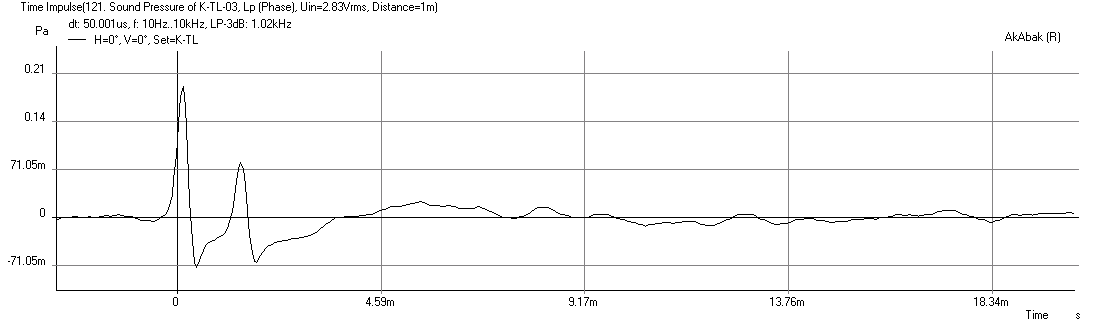

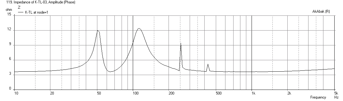

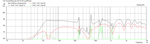

Visaton FR10 in 0.6X Scale Karlsonator
I scaled the base Karlsonator as follows: 0.6X overall, 0.7X additional scale by width, 0.7X additional scale for top channel vent. The FR10 is a relatively inexpensive driver and when paired as a double parallel load for 4 ohms, it has a surprisingly flat bass response. The impedance is very nice, as is the cone displacement and impulse function. The cabinet will be circa 18 in high 9 in wide x 10 in deep. This is one KenLBird's favorite drivers - you should build it Ken.
