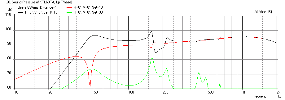

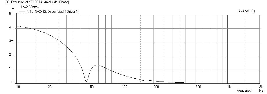

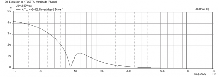

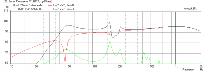

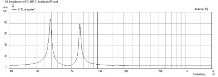

Here is the simulation with walls really far away. The Tannoy looks pretty good - you need to scale the width and depth by 0.67X - leave the height alone.
SPL vs Freq
Impedance
Cone Excursion

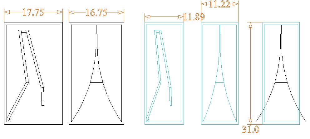

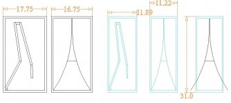

Question on scaling...the two left in black are original size. The two directly to the right in blue are scaled .67 in width and depth. Obviously, I have to do some work to get the plywood thicknesses in line.
However, does the K-slot also change shape, or should it be truncated as in the second shrink example with the black lines showing its original shape?

I'm just trying to learn a bit about the Karlson enclosures myself. But, I assume that the slot should be scaled too (your blue line drawing). From what I've been able to gather there is a lot of room for experimentation.

The drawings look good and yes, the K slot should be scaled like in the blue drawing. Experiment with the slot - it is easy to change.

Go with the 0.67x scale (width and depth) 1.0x height for the Tannoys as that was the optimal scale I arrived at. The sims include stuffing from the closed end all the way down through the bottom turn, right before it goes up. Use moderate density of polyfill. You can adjust to taste by adding or removing through driver cutout. The stuffing from closed end to driver can be more dense. I will have to calc impulse response but it is the inverse Fourier transform of the freq response, and seeing how smooth that is, it should look good. Before you cut wood, let me double check sims one more time to make sure I have the scaling correctly applied.

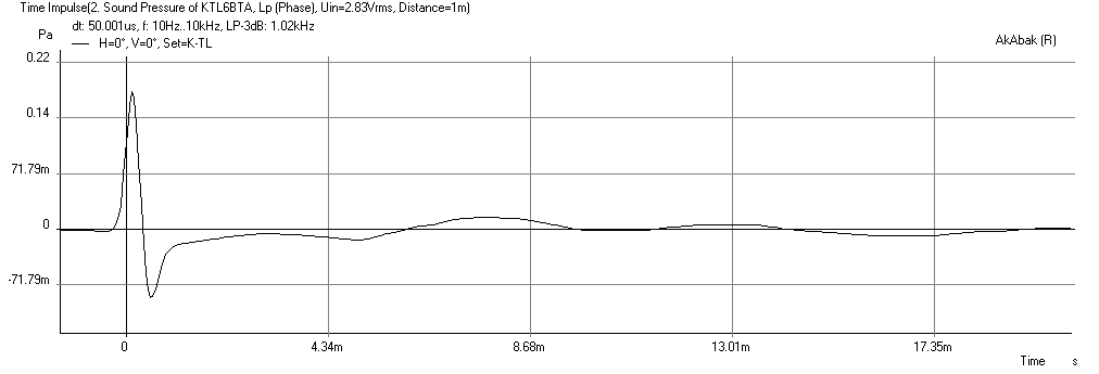

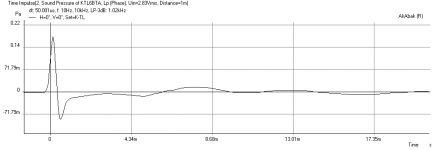

Here is the impulse response with the Tannoy 2046 - looks pretty good. The drawings should be scaled 0.67X in WIDTH ONLY. I mistakenly thought the depth was scaled too but it should be left the same (deep box) - sorry about that.

Correction. The drawing should be scaled in Width only (so the side view should look like the black drawing on left), and the front view should look like the blue drawing on right.
Got it, thanks! So all the Tannoy plots above reflect .67 wide, 1.0x deep, and 1.0x height, correct?
YES.

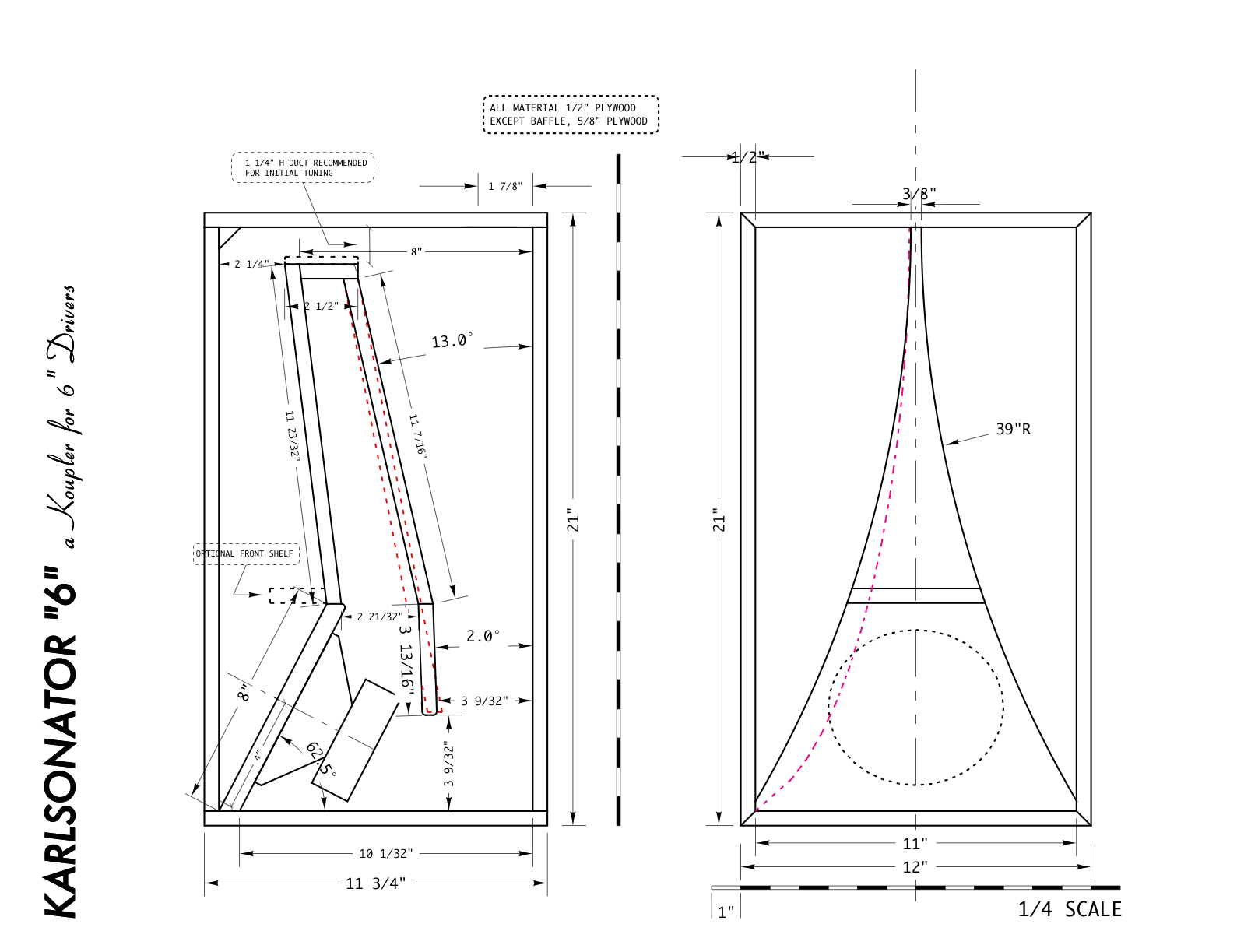

Karlsonator 6 for FE167E
Prior to building the large enclosure for the Tannoys above, I will build the much smaller Karlsonator 6 for pair of FE167E that I have.
The FE167E is virtually identical to the FE164E which was built in a Karlsonator 6 below.
The Karlsonator Six (Page 1) / Karlson / Fullrangedriver Forum

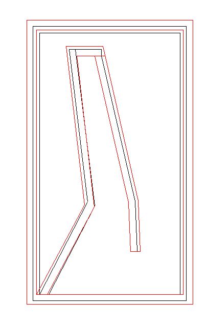

A question on the enclosure, however, it appears to show two builds, one with dotted red lines? Can anyone (Greg B?) elaborate?
The internal red-dotted panel is about equivalent to the two-piece one, if you want to build this way. The red Karlson-slot is only to show an alternative profile to experiment with. The black lines are arcs from a 39" radius as noted, but the red line appears not to be radial. I'd probably go with the black K-slot.
What material will you be using? I suppose one could get away with 0.5" BB-ply as per the plan, but 0.75" would really be ideal. Cool thing how lateral bracing is inherently good. Hardwood dowels to the back panel might be a good idea, as would be for the wings. ~1" internally from the K-slot on each side and roughly half-way up the front chamber. Front-mounting the driver and using the black-trace wing profile should remove the need for removable panels and make for a more inert/solid cabinet.

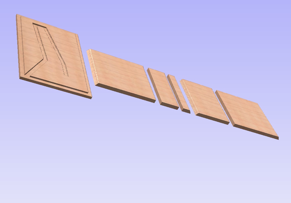

I started to program the CNC. All panels will be rabbeted, mitered, and cut by the machine using a 1/4" straight bit as shown in the rendering of a few of the panels.
I'm not sure I will brace this since I am using 3/4" thick material.

Nice, possibly the first CNC Karlson? 🙂
Bracing can always be added later if you feel it is needed. I was surprised at the pressure exerted on the wings of my K12 and bracing them really helped. I did not brace that of my smaller SK8, also built from 18mm BB-ply, but they could have used it as well.
