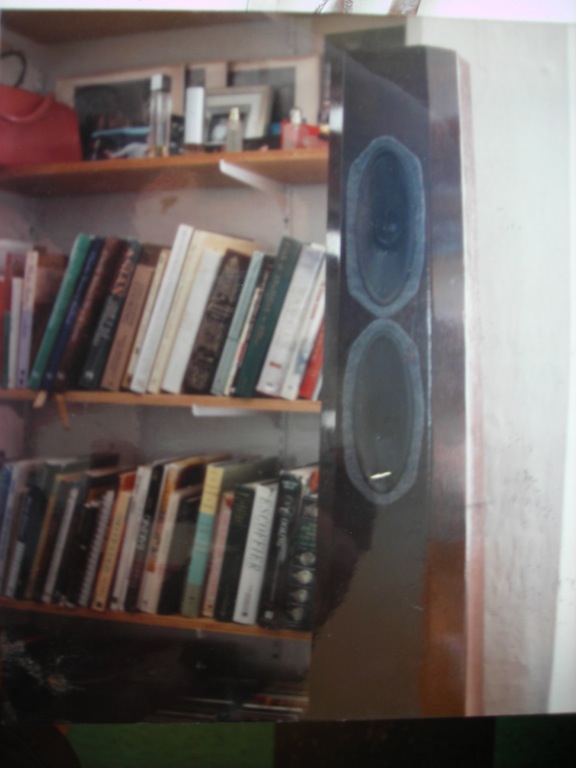

here's a picture - probably 20 years back of a klam subwoofer built by Wayne Neuser - think it was a 10" and employed a tunable passive radiator. The aperture was linear as it only covered bass - the little klam-sub augmented a total of 8-10" Scanspeak in aperiodic boxes. According to Carl it was pretty punchy, and the K-loading reduced the PR's excursion.
hey XRK971 - how would you go about choosing driver and klam chamber sizes for a passive radiator Klam-woofer/sub? Carl with their 10" driver sub-above said they used a 12" passive radiator and to try to avoid adding any weight. I get the idea it would look like a T15 but with PR facing up in place of the vent. The little klam sub above must have been decent to successfully augment 8-10" Scanspeak woofers. (Carl said is was punchy and had explosive power - I'll have to ask what they used for a woofer) Also, other than height, would a conventional Karlson shape with passive radiator be about as useful as the klam-sub? - the upper board would have to be long enough to fit say a 12" Dayton passive radiator for a 10" woofer.
can you modify the T15 model for PR without undue headache? - or would a PR-klam require starting from scratch to keep everything in order?
