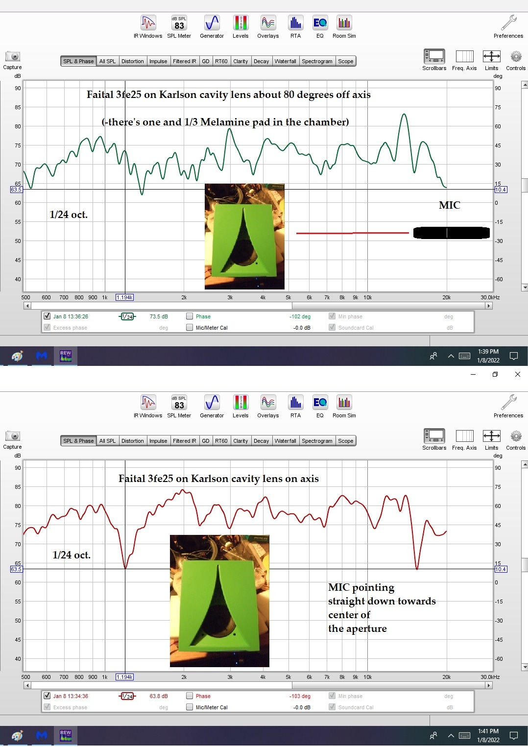

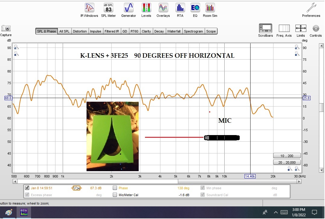

Here's something you might ind interesting. In my box of Christmas K-goodies from Pelanj were a pair of 3D printed Karlson front chambers for 3 inch speakers. They are among my prized possessions and very pretty.
There's 1 melamine sponge sliced diagonally to make two damping pads for the sides and a little piece at the chamber top. There is no back chamber yet its just sitting on a cluttered coffee table.
(BTW, I'm having trouble with REW setting the Y axis - it gets "too tall" so its easier for me to take screen shots)

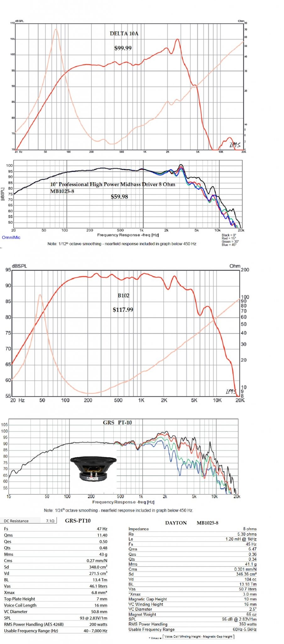

Here's some potential 10s for a K10. That GRS PT10 (introductory price ~$30) is made really well like a Dayton PA310. Inflation is really rough on Delta 10a and B102 prices. PT10 has a lot of overhang - might be fun with an inexpensive compression driver and K-tube.

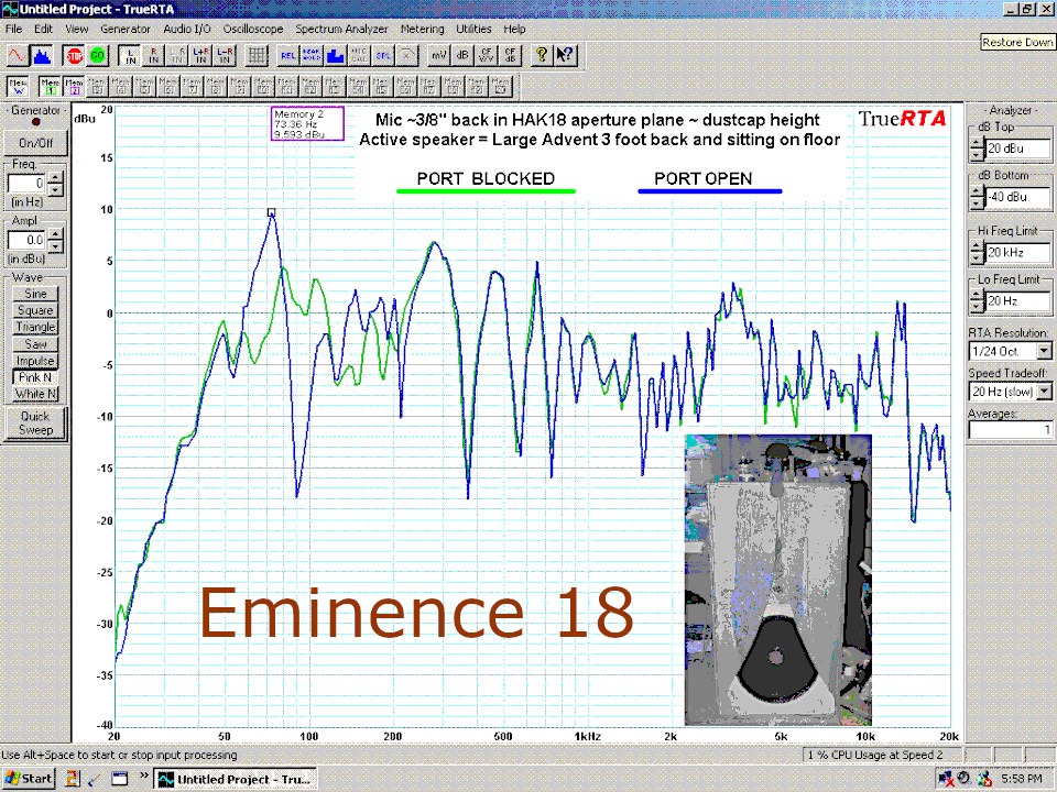

Here's an oddball graph. The mic was placed at the woofer's dustcap height and right into the aperture plane.
Then the K18 was driven by a Large Advent speaker 3 feet away.
See if you can make some sense of it.

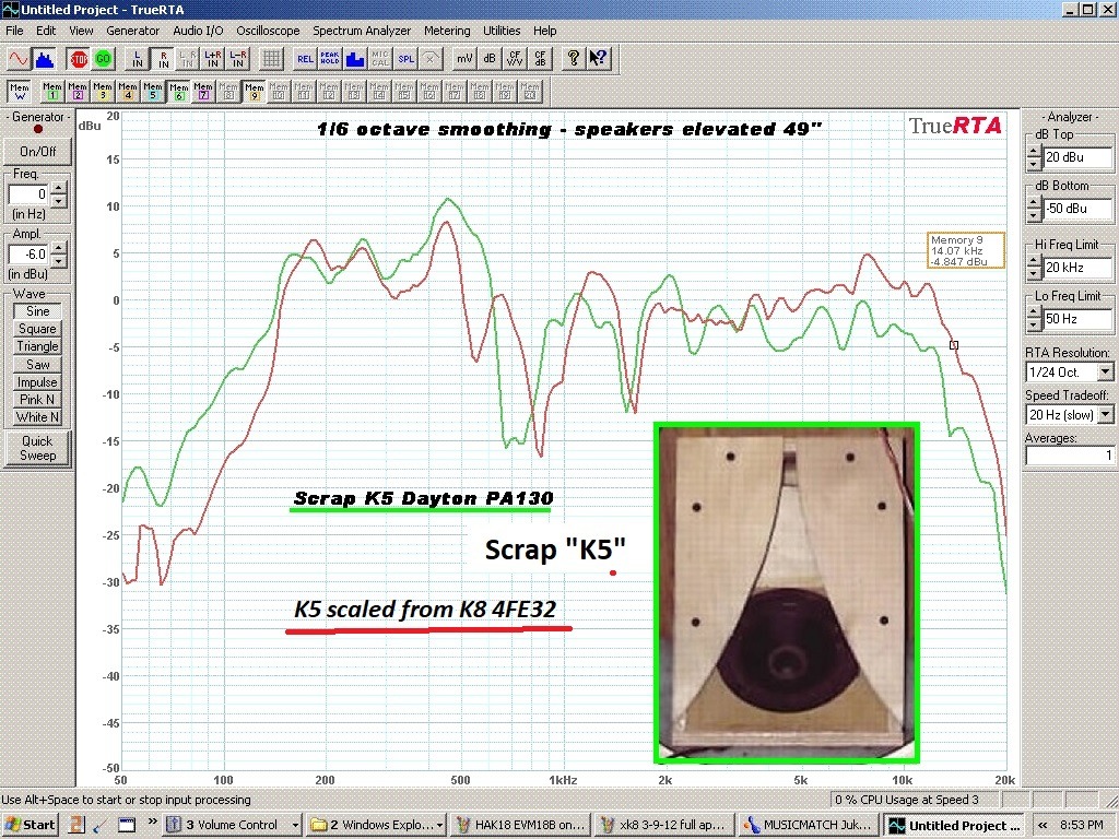

Lets say we want a "K5". Is the best bet for a smooth response a distributive vent?
my scrap K5 had roughly a one inch square vent at the top.
This little size could be fun for a mini 2.1 setup or with reduced back chamber volume, a K5MR ("midrange")
