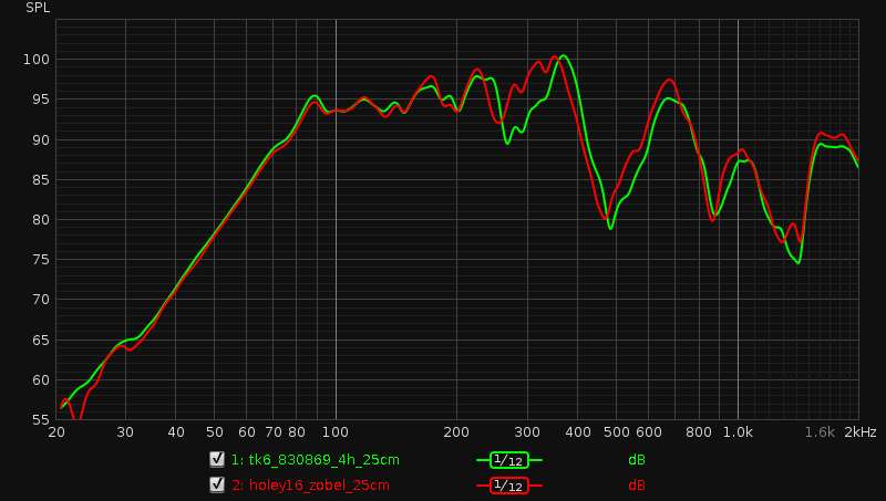

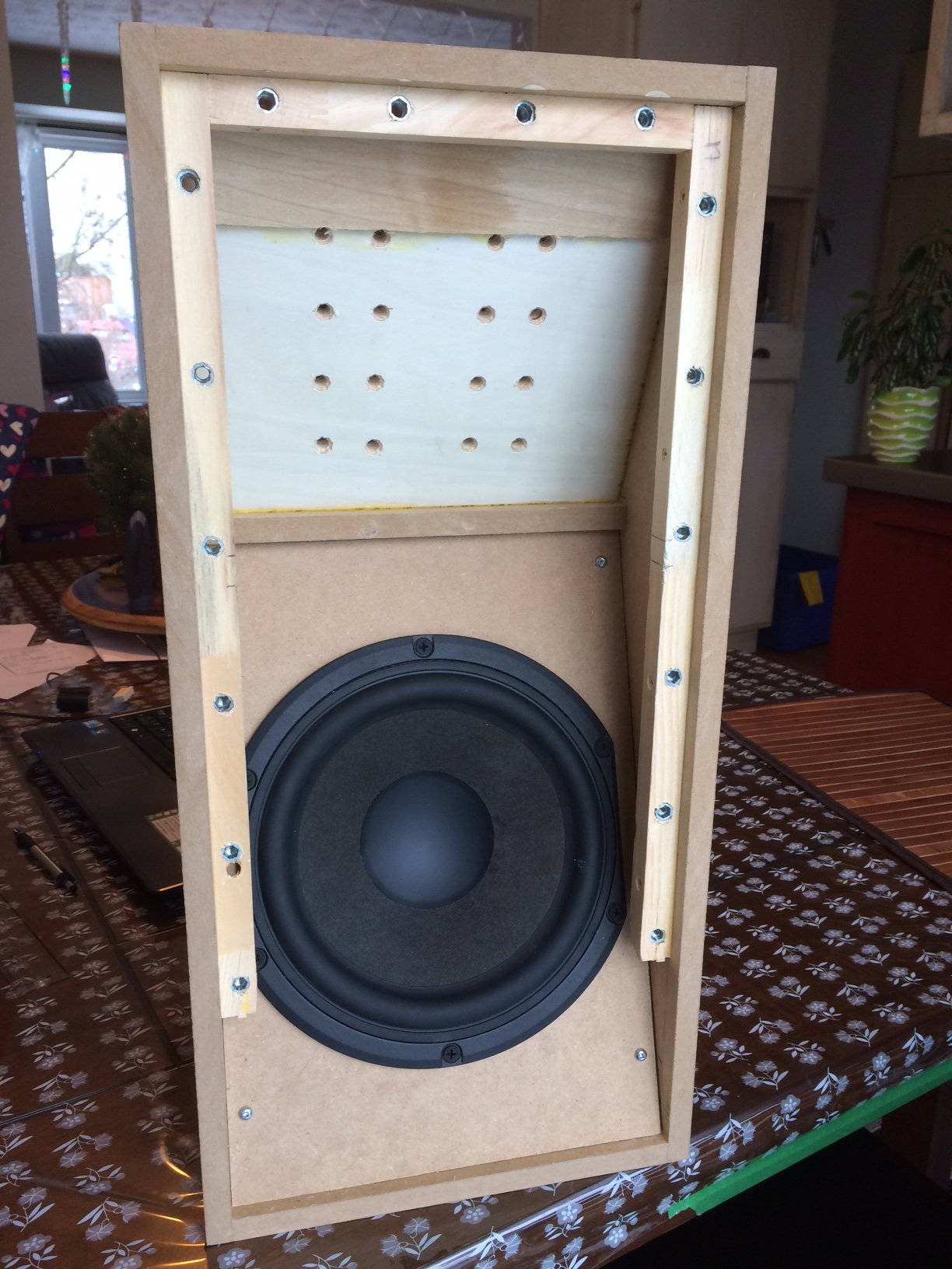

Freddi, regarding the X15, it's venting scheme seems to be fairly unique, with a single circular round hole at the top, a larger rectangular hole below, followed by 4 circular holes around the K-Tube. I was just thinking of somewhat more distributed venting for my TK6, perhaps with a resistive element, what do you think of this?

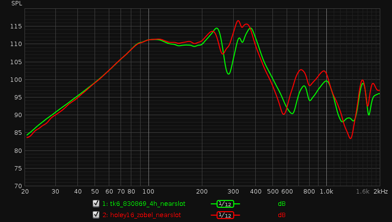

I tried my above proposed distributed vent, here are the results. The green traces are the TK6's previous venting scheme of 4x 1.5" holes at the top of the reflector panel, the red trace is the new scheme consisting of 16x 0.25" holes distributed in the reflector panel.
Picture:
tk6_holey16_nowings-jpg.1010472

Nearslot measurements:
4h_vs_holey16_nearslot-png.1010752

I'd say that worked out quite well. I just went for 16 holes not knowing how it would tune and it turned out a bit lower, but the LF response is hardly changed for that. The 200-400Hz region is improved and the 300Hz cavity resonance is 'tamed'. It also helps that the new driver, Peerless 830869 has a better low-end, making the 300Hz peak not as prominent. The 80Hz~400Hz cabinet bandwidth is pretty flat as Karlson go. The rollercoaster ride above this is hardly changed, not that I expected it to be. I'll have to see if anything can be done there as well.
This TK6 setup isn't Fullrange, but just a quick comment, it sounds much better than the previous 6FE100, FF125K or dual FF125K. I set up a K-Tube on in coming in at 3kHz. The subjective midrange coloration is noticeably lower than the other drivers despite similar response above the T/S+cabinet dominant region. The 15L rear chamber is too small for the 830869, but its low Qt allows for it and the bass sounds good, if not very deep. It's been some years, but I'd say it sounds about as good as the SK8 (K10-sized) with FF225WK.

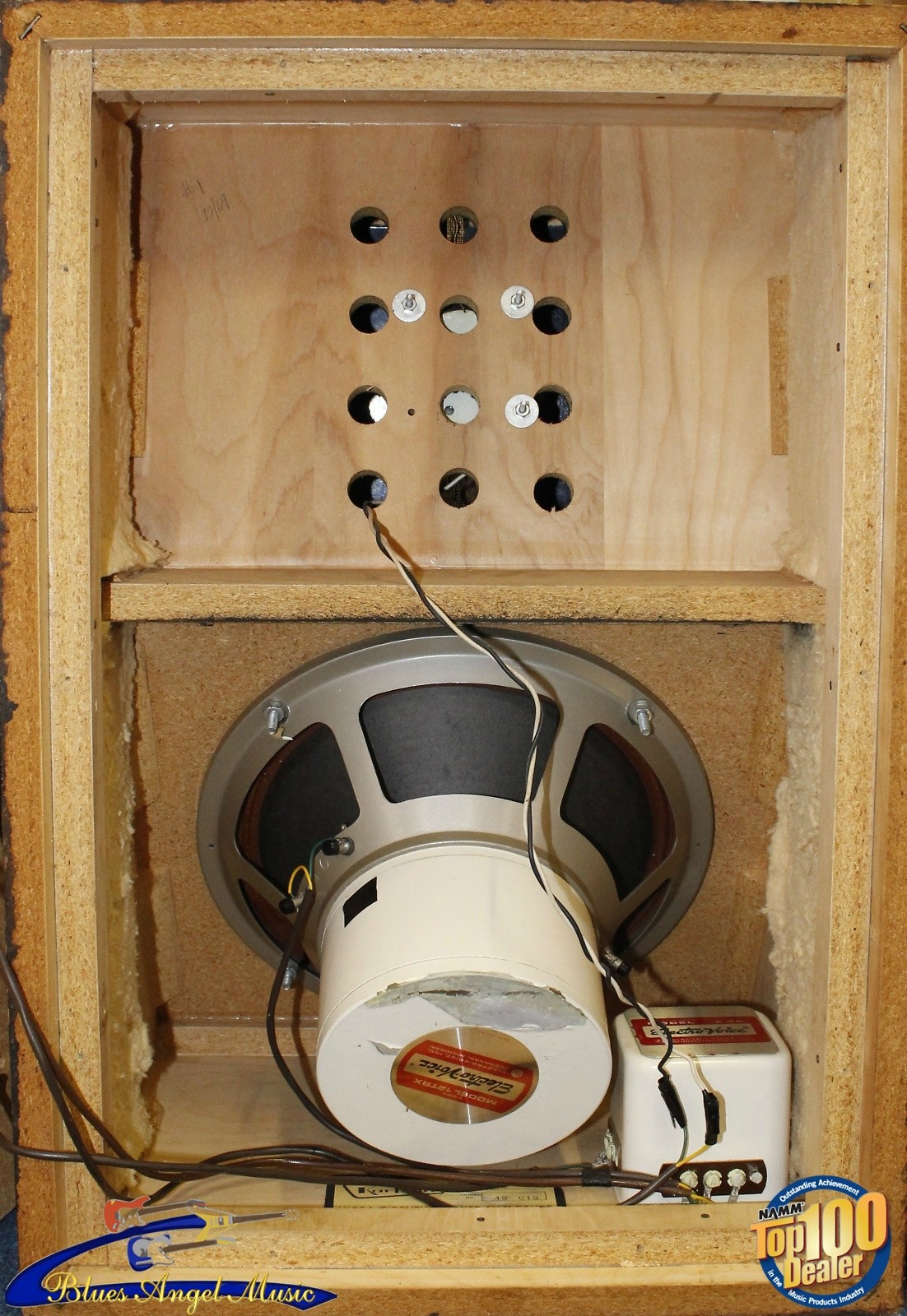

Cool work IG81 - I'm guessing if you feed the cabinet a sine wave at fb - there will be quite a bit of overtones from the little holes. Does some music stay in place long enough to cause audible effects? - transient material may aound better with a distributive vent. Karlson's X15 has been seen with a large vent like the later Acoiustic Control 115BK and choked down wih a plate with holes drilled. The late Martin Poppe said that Ann Karlson's X15 cabinet was tuned with 43- 3/8" diameter holes.
Karlson's later K12 kit has been seen with a blank panel and so with its assembly sheet. Missing must be instructions on what size and how many holes to drill for popular drivers of its day.

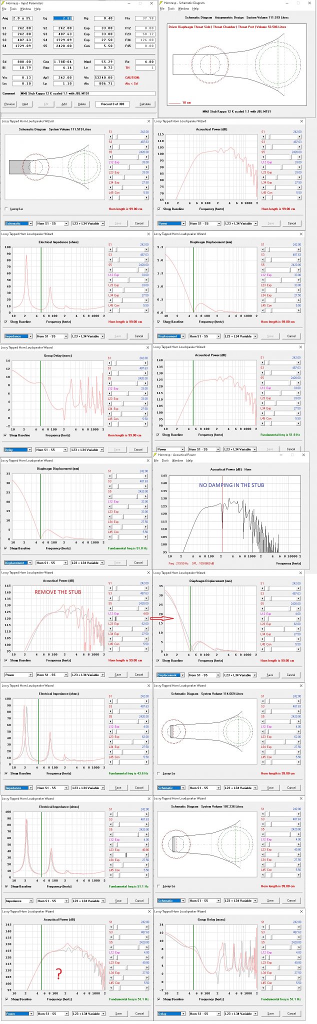

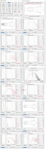

If you use hornresp, see if you can make sense of how to better compare a stub to no stub condition. This set of sims is for a little cabinet and the fudged-sim by MMJ

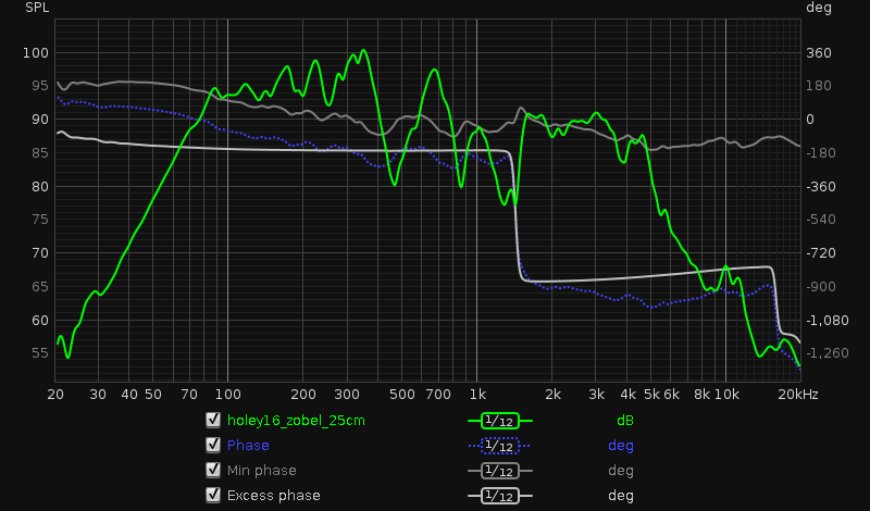

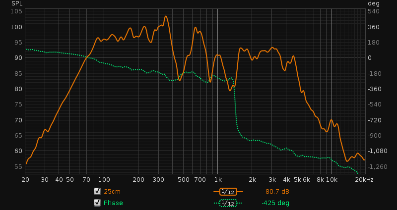

Here's a measurement I posted earlier, still the 830869 woofer with distributed 'holey' venting, measured at 25cm, this time showing phase with minimum phase extracted - not that I pretend to really know what's going on there.
The phase response looks fair enough, even through the large peaks and dips. Noticeable is the large phase shift at ~1400Hz, not something that should be there for a single driver and no EQ or processing applied. I measure similar on my smaller XKi, but at a slightly higher frequency. It seems to correspond to the frequency where the SPL response gets back to that of the drive unit, IOW where the cabinet stop affecting the response. The shift is just so sudden, ~700deg (of excess phase) over a few hundred Hz. I would expect the front chamber to 'disappear' more gradually, as the wavelength gets shorter, so I don't know whether this is suggestive of that or something else.

Karlson's flat pack K12 apparently came with an un-drilled port panel. Two examples which appeared to be factory drilled (one for Tannoy Red-other for EV) were vented as so and likely tuned
around 60Hz. Why did Karlson return to a full width rear chamber shelf vs the split shelf in K12 introduced around 1956?

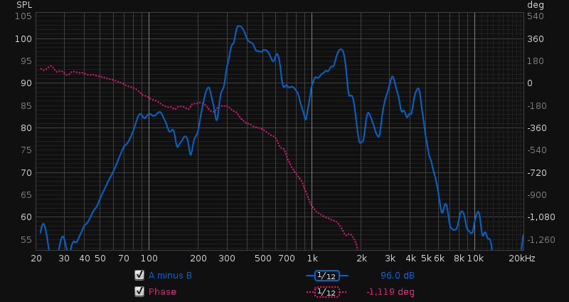

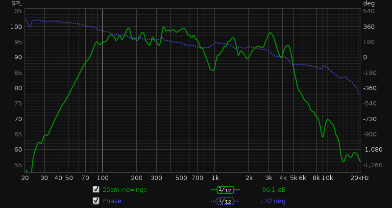

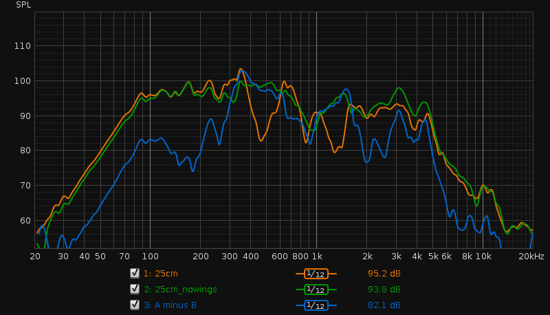

The reflections evident in the REW file are very close in and hard to resolve. Here's an idea. Do a measurement with and without the aperture (without disturbing the mic or speaker) and then we can subtract one measurement from the other, leaving only the difference caused by the aperture. You can even view the impulse response of the difference, provided your measurements are time aligned.
I did just that this morning. Measured at 25cm, mic did not move, though I moved the speaker to remove the wings, but placed it back within 1-2mm. I don't believe I time-aligned, as I did not yet look into how to do it in REW.
With aperture:
Without aperture:
Aperture minus no-aperture:
All on the same graph:
I don't think the subtracted impulse response makes sense, as I was not time-aligned.
