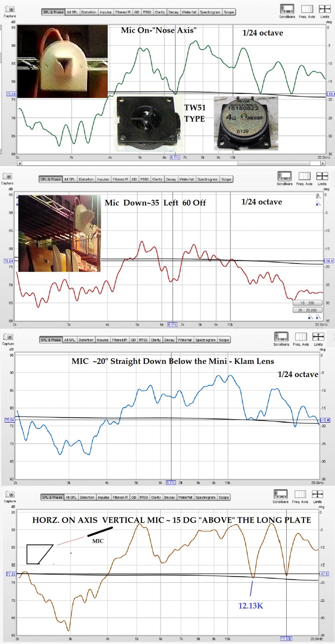

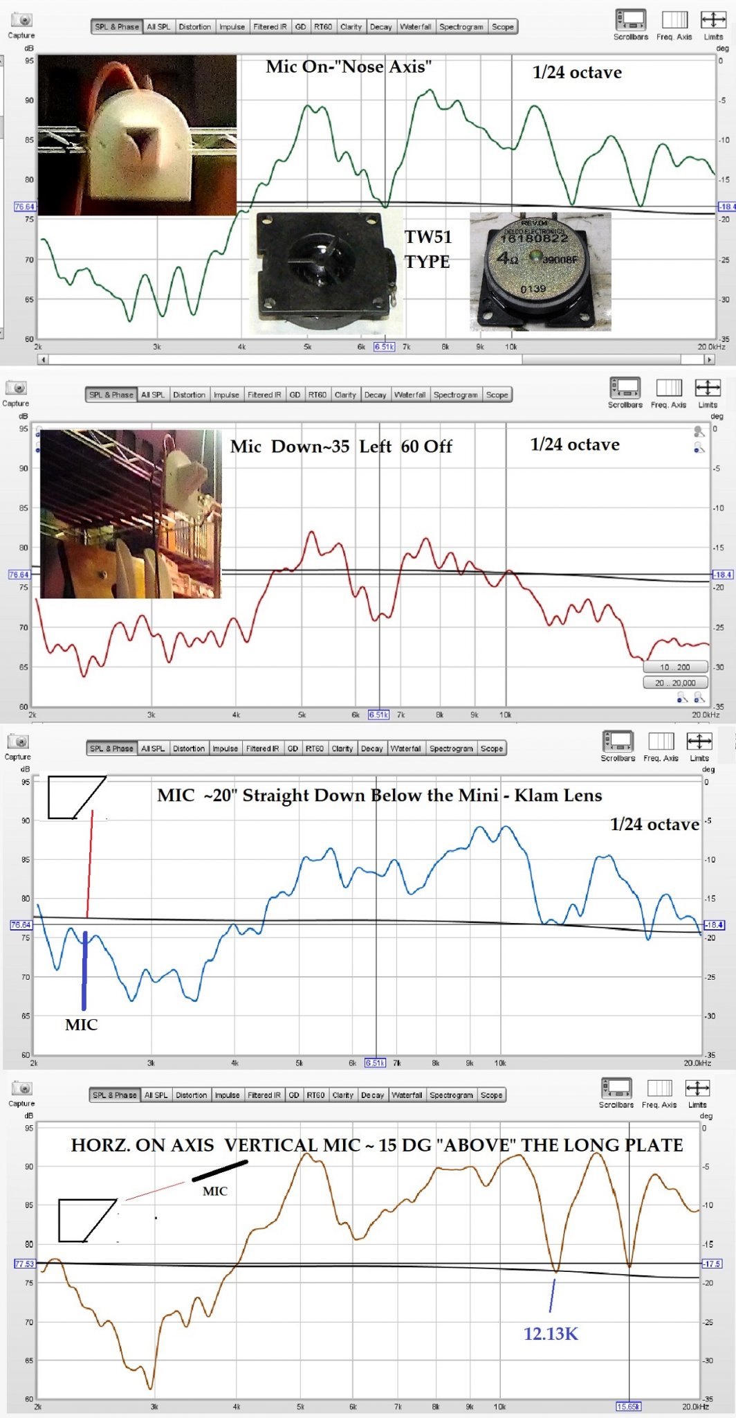

FWIW here's the general behavior of the1-inch throat micro klam whose 3D print file was made by Pelanj.
I don't think the multi-way folks would like it and probably not of interest for
FR people either. BUT its something I think kinda neat. Alan Weiss (whom I understand worked with John Karlson in later times) patented (now expired) the micro-klam within a multi-channel patent. Alan had a home theatre system with four 2-way speakers and a subwoofer. Each speaker had 1- Eminence Beta 8A woofer and a one-inch format sheet metal nicro klam. The micro-klam's driver was Eminence's CD1 ("type 1" with aluminum diaphragm-limited to ~13KHz but considered by some to have better sound quality than the later titanium version)
At Job Ulfman's old Karlson forum I saw a few blurry pictures of Alan's theatre speakers. They had direct radiator woofer - direct radiator midrange- and metal klam compression driver lens. (not sure if 1" or 1.4" format -?) Peavey's J. Risch heard them - maybe as something Peavey might market and said the tweeter "sprayed highs everywhere" -thus not meeting THX standards for movie theatre work. There was a story that Alan's speakeres were destroyed right befor a showing with ball bats by "THE MOB" (!) but that posting was before I joined Job's K-forum.
The driver on the baby klam lens below is a 4 ohm sqaure plate version of Audax's TW51 type.
Here's a general first hand look of the1 dollar (but excellent driver) sliced/diced and sprayed by the little K-lens. With the klam's long plate at the top, It should be placed above ear level and fire down/forwards. There's a fair amount of energy below and perhaps up to "90"off horizontal. The baffle tilt makes it tough to describe.

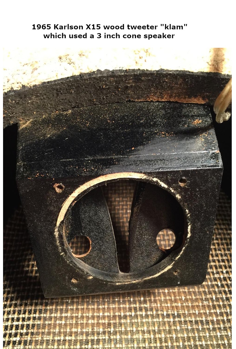

Karlson's 1st X15 2-way speaker had an open-ack 3 inch cone speaker on a little wood mini - "klam". It attached to the tilted baffle. The back chamber was a styrofoam coffee cup.

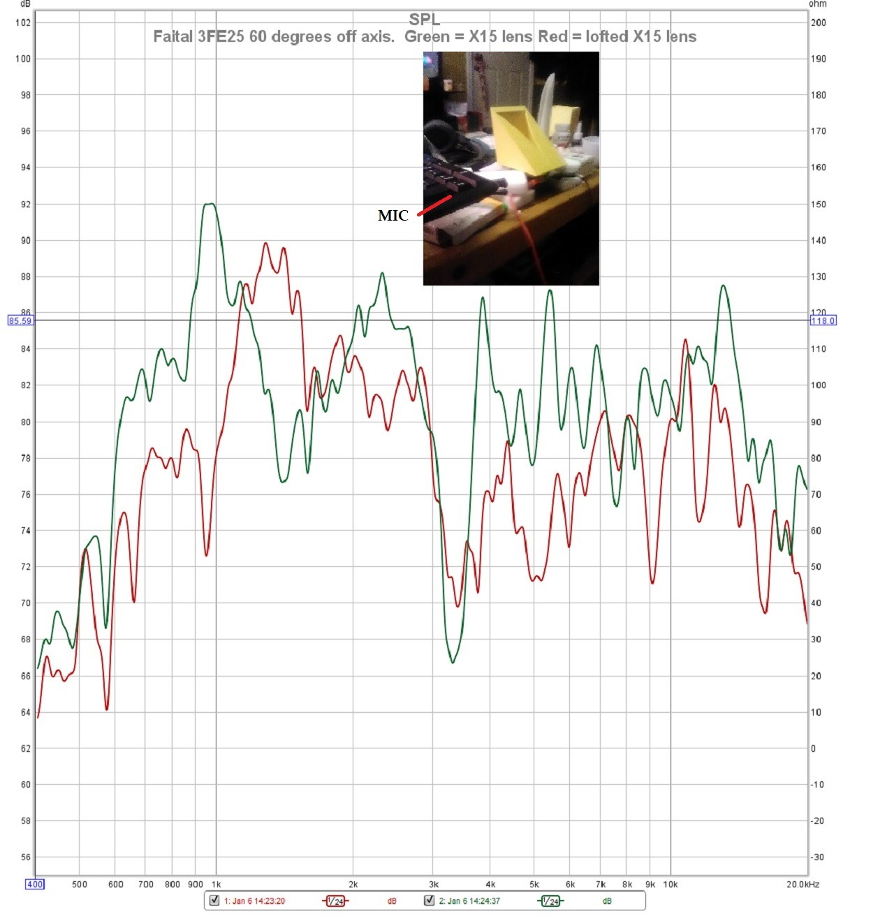

As a super wonderful Christmas gift, I received a box of various 3D printed K-goodies from Pelanj. Included was a replica x15 tweeter klam and modified "lofted" version with curved internal surfaces.
Here's a graph using a 3fe25 with the mic about 60 degrees or more off axis relative to the orientation shown in the embedded blurry picture. I'm surprised to see a large difference but
the lofted version has significantly less internal volume due to very thick curved walls.
In Karlson's X15, some energy was firing up against the 3 panel upper reflector, some fired left and right against the back of the wings, etc.
K-builder Carl Neuser liked a particular Eminence made woofer sold by Martin under 15169. That woofer won't go above 800Hz and is less sensitive than the kind I generally use but it can move some air. I think this mini klam - or perhaps IG81's V-slot type tube could make a fun tweeter with the15169 (Eminence #151269 IIRC)
Those are 2dB vertical increments so not as horrific as may seem.
3fe25 sounds pretty peppy on sine sweeps.

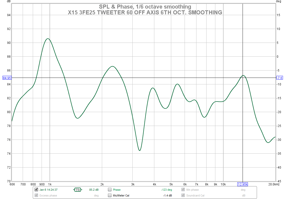

Here's the same data 1/6 octave
BTW, Karlson's wood klam-lens had two holes near the tight portion of thes - slot
-- did they correct for some peak ?

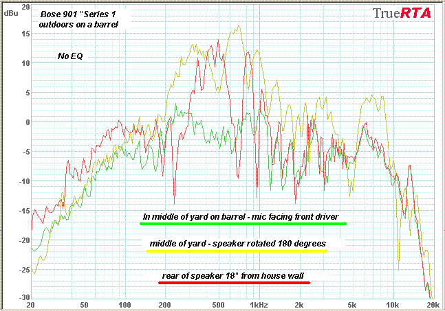

Bose with the 901 tolerated dips and peaks. Here's my 901 Series I outdoors (no EQ) from front rear and rear bounced perspectives.

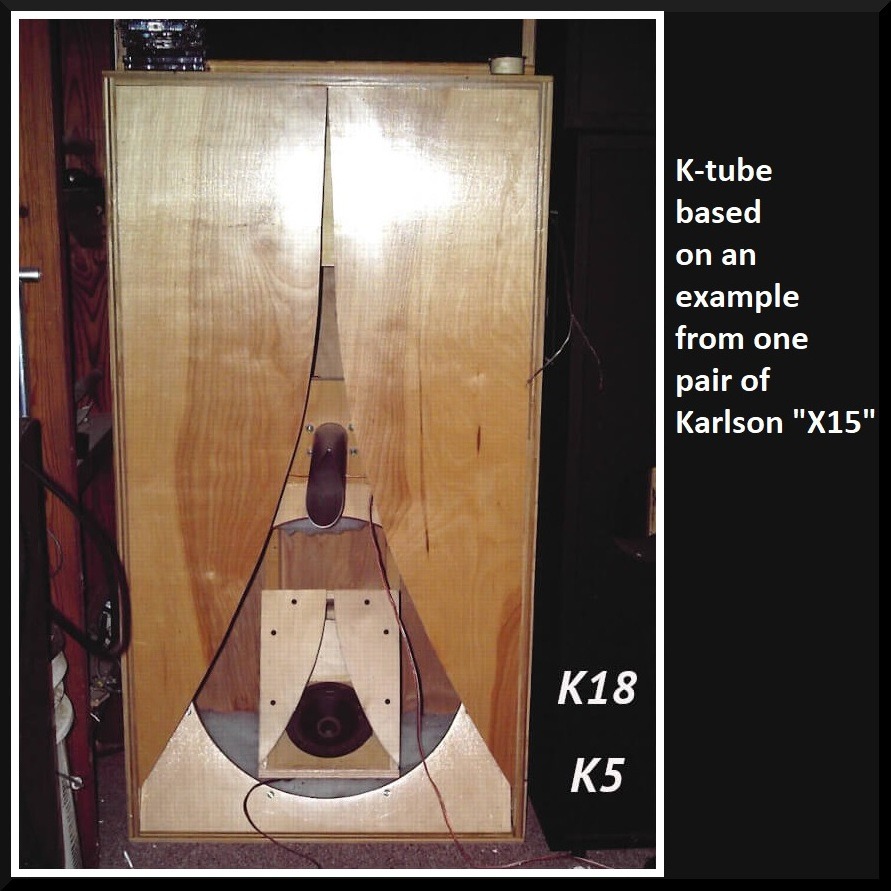

XRK971 curved the top portion of one build with improvements I can't find it in my drive but it's probably in his XKi thread.

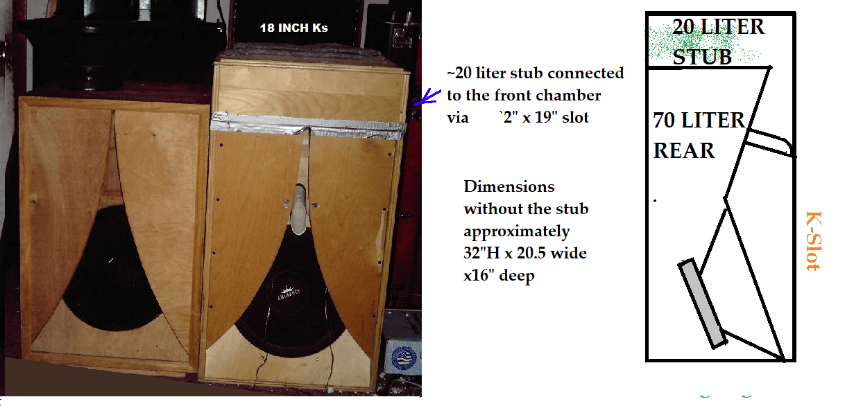

The little K18 where I used a 1.2" starting gap to get it sounding right was 32" tall, about 20.5" or 21" wide and either 15" or 16" deep. It had roughly a 70 liter back chamber. It was made simple
like a "big K12". For experiments I screwed on a 20 liter stub chamber connected to the top of the front chamber by a 2" by 19" slot. That smoothed the response ripple and leveraged maybe 2dB more bass. 70 liters rear chamber was sufficient for the 0.25 qts Eminence 18" speaker.
I cut ~3" off the top of the wings to raise them -really no improvement in sound quality but some clearance for the parabolic slot K-tube.

My first "K18" was an attempt at Karlson's "Fig.6" with 15" speaker from patent 3540544. I think the cavity was just too deep. A front shelf made it play and sound close to K15. I somehow took a jigsaw and re-cut the baffle for an 18" Emiennce. That was real fun - mellow with good power to probably 60Hz and cannonball punch.

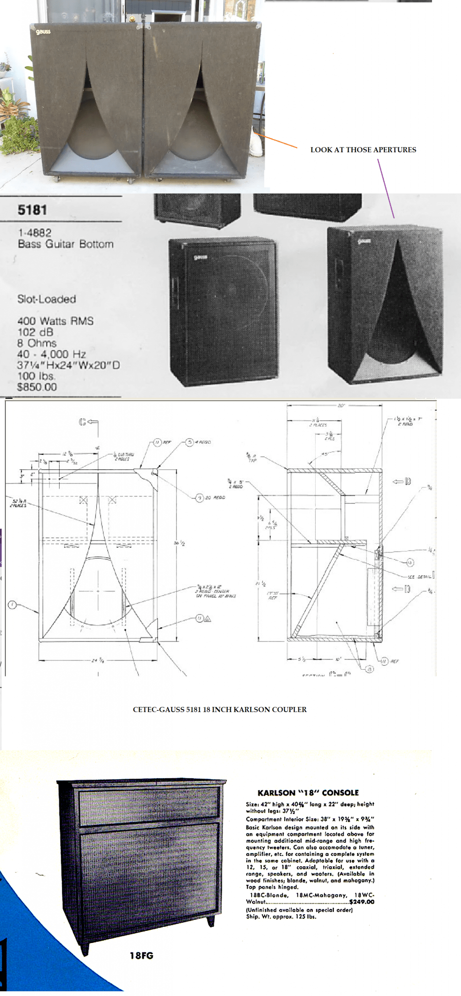

Regarding K18, I don't know if you recall, but many years back, possibly in 2013 or so, I 'discovered' yet another possible licensee of Karlson tech who'd made a K18 IIRC and emailed the guy from the company whose names I both forget, for some info, some of which was provided. I think it was geared towards pro-sound application, no so much home hi-fi. I might have posted this over on Gainclone or Fullrangedriver.com, maybe even just email to you. Any of this rings a bell?
was it the Cetec-Gauss 5181 K18? I used to have a note from that company's VP saying it was trial and error developed/tuned.
Funny thing - Karlson had already made a K18
