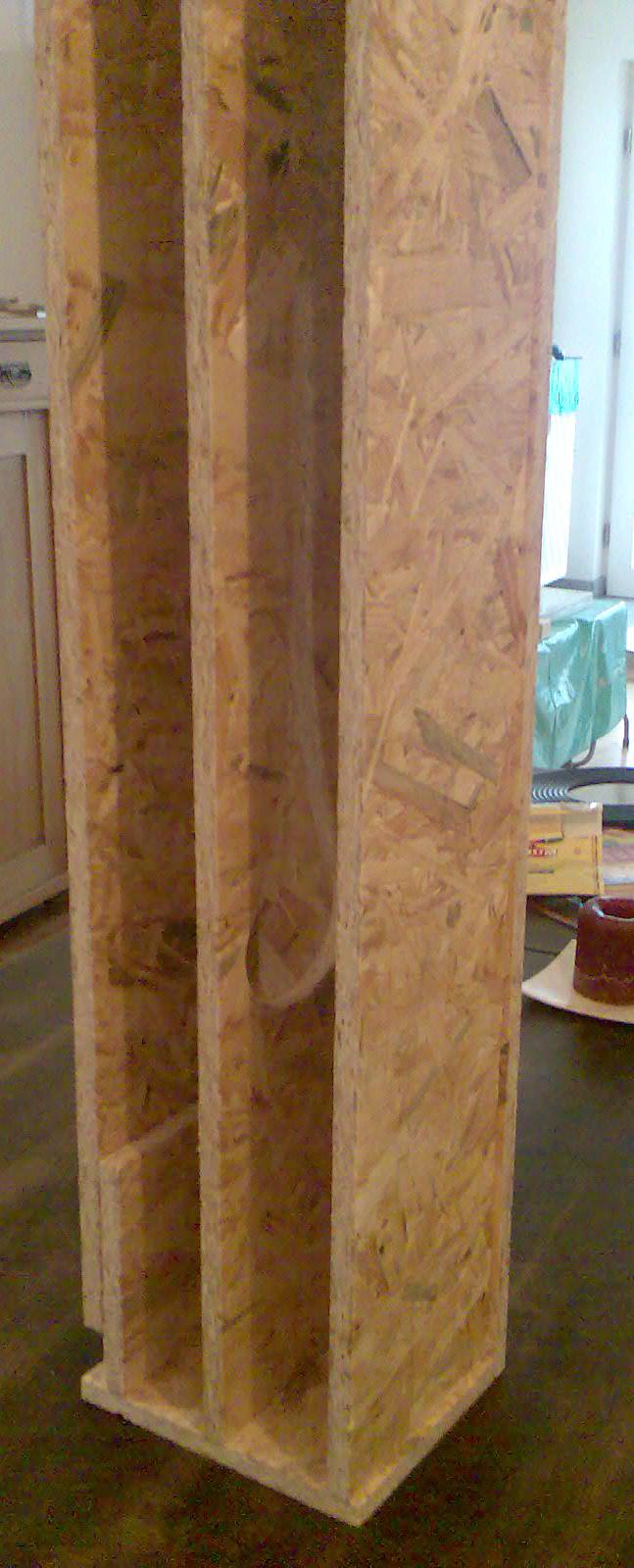

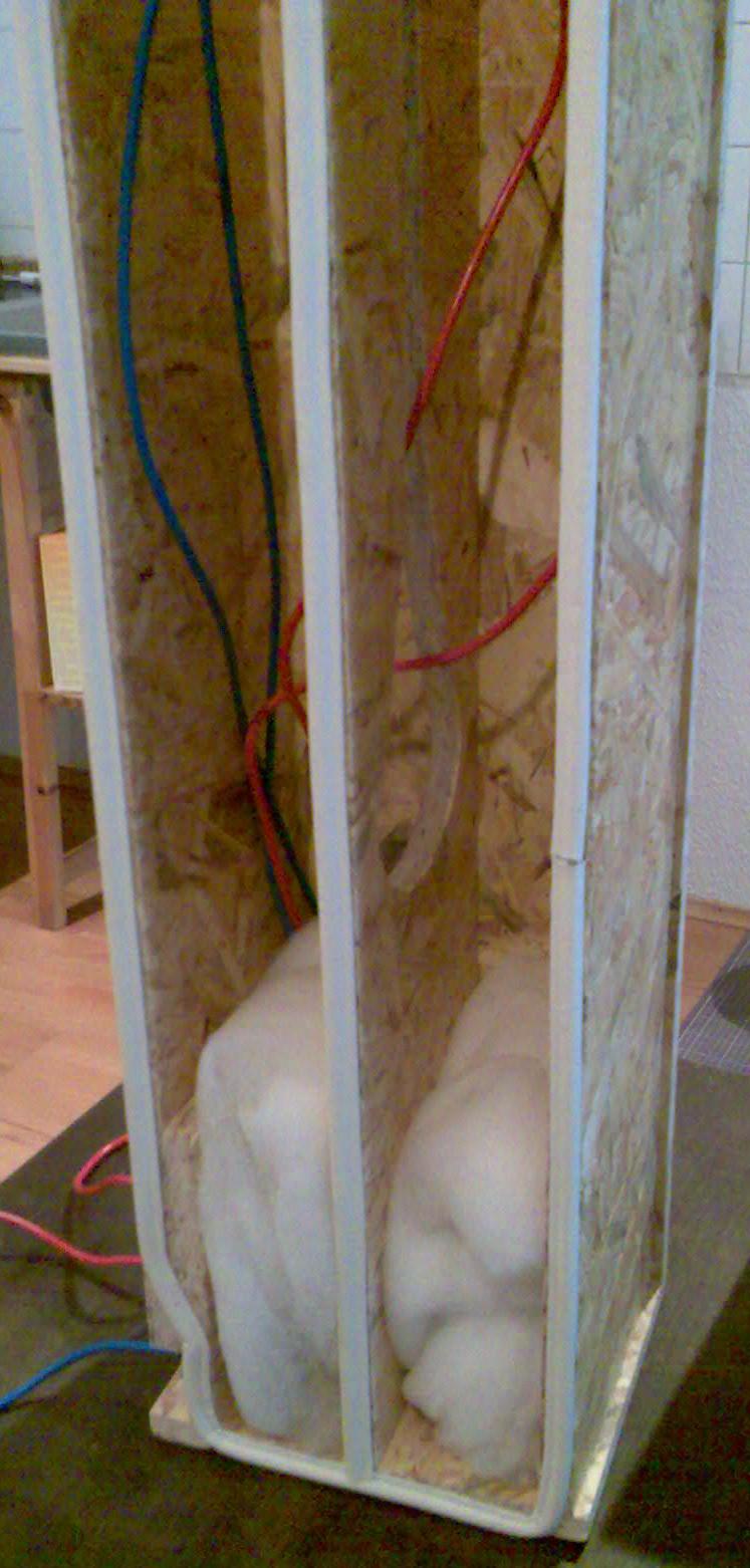

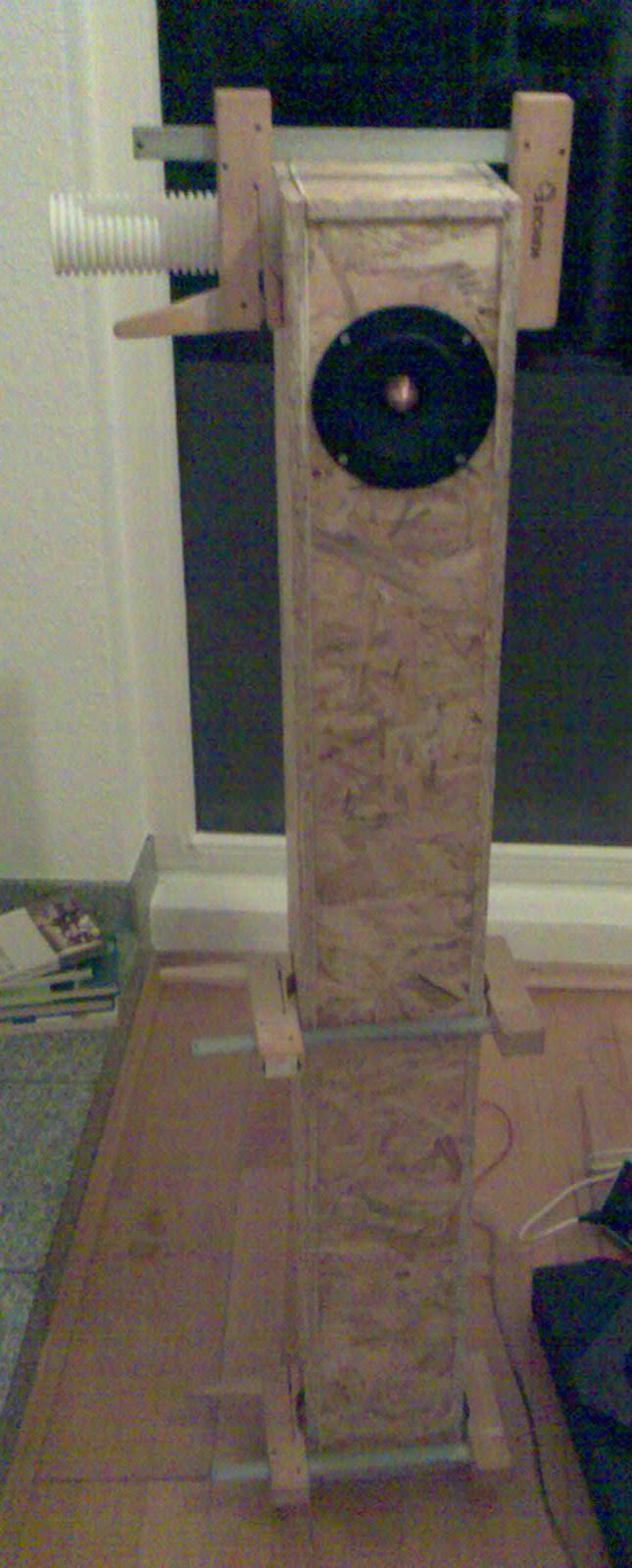

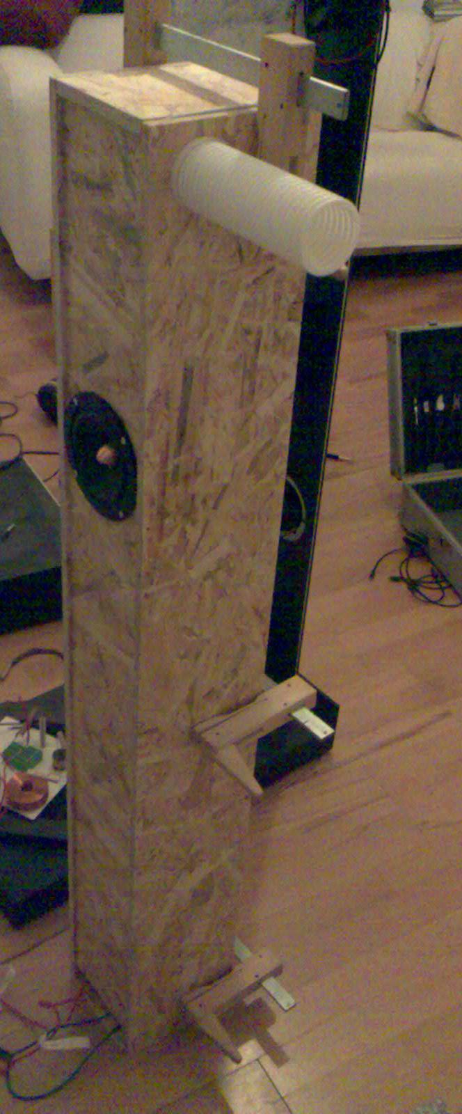

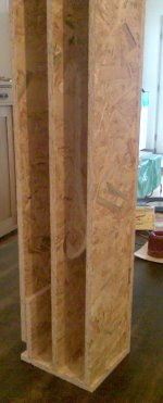

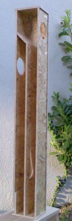

Not really, but i used "Carlsonification" of pipes
occasionally.
This one e.g. was a modification of a design by
Graham Maynard.
occasionally.
Graham Maynard.

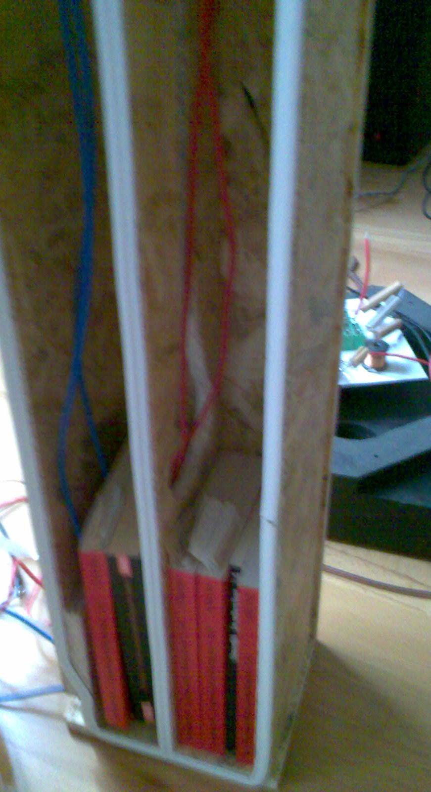

Hi LineArray
Thanks for the photos.
I looked at your site and enjoyed your thoughts there.
I can see the Karlson 'shape', 'slot' whatever, inside your speakers linking the 2 chambers.
Would you explain why you used this shape cut-out here. Why not a circle, square or any other shape.
I can't work out why the Karlson shape (It actualy looks like the shape of a falling drop of water in your photos)
Nice work !
Cheers
Simon

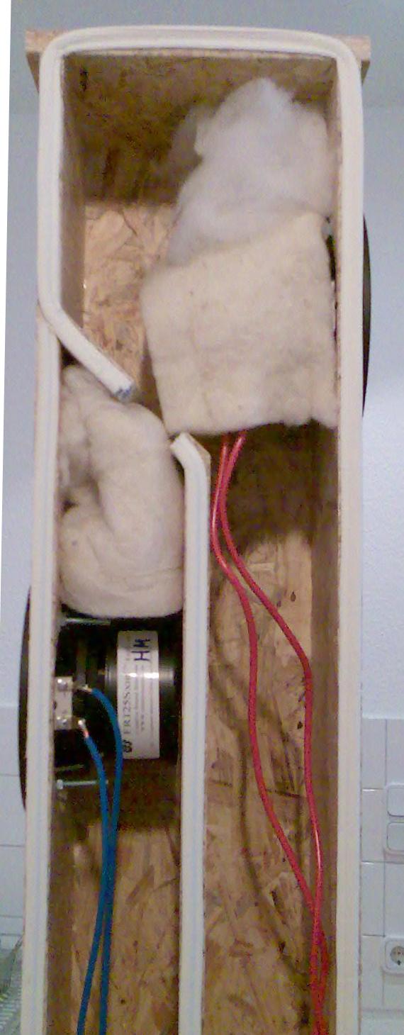

Hi Simon,
this enclosure has been developed in a rather
'non scientific way' let's say 'freestile acoustics' with
some educated guessing 😉
Goal was to have a fairly resistive load, when both
drivers wired in parallel are seen as one 'unit',
and the slot was introduced mainly to supress higher
order modes of the pipe, which is excited at both ends
with the drivers operating in phase.
There is a resistive slot between the drivers in the top
section as well and a port, which is attached to the
- somewhat larger - rear chamber of the 'front' driver.

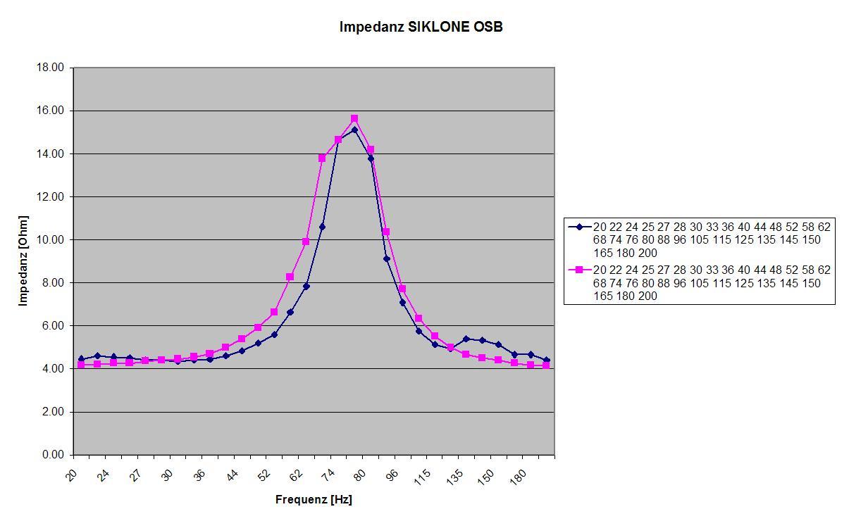

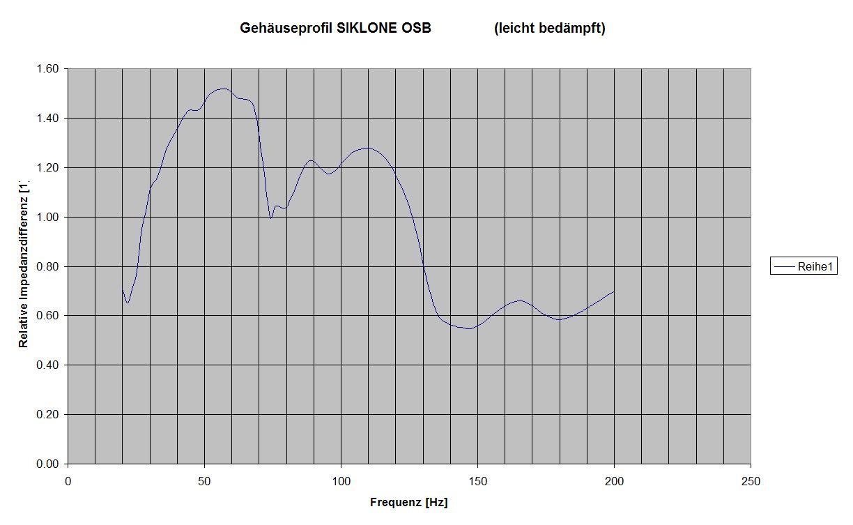

1. Attached picture shows the impedance of both drivers
in free air (pink), and builtin to the enclosure (blue).
2. (ZfreeAir - Rg) / (Zbuiltin - Rg)
Kind of "impedance ratio" using only the magnitude of
builtin and free air impedance.
As can be seen, the enclosure reduces electrical impedance
- and thus average voice coil velocity and excursion of both
drivers- even as low as 30Hz.
I haven't measured nearfield frequency response at that time
playing around with it, but it goes significantly lower than
40Hz using two FR 125s drivers.
As far as i remember there was only the stuffing shown in the
pics - near the drivers - during impedance measurement.
While detuning pipe that way might have been useful, I don't think behaved as Koupler.
Far too symmetrical. Would transform impedance the same way forward as backward,
thus undoing itself.
If you ever faced a Karlson into a corner or wall you would know what I mean. Don't
benefit as much as horn. Why? Cause impedance transform of K slot requires access
to an outside volume bigger (lower characteristic impedance) than the transmission
line to be so terminated.
Your impedance graph comparison to free air shows nothing significantly changed.
Thats not to say it isn't "working" properly. Just to say its not working like a K.
Three impedance spikes, etc etc... What you got is a whole different animal.
