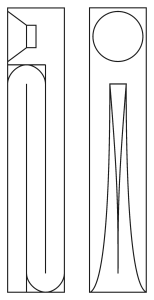

I think there is a little mixture here, about to different things:
The either thing is the karlson theory itself, namely that an open air column (a TL)
resonates by default crispy, and when you cut the pipe with this 2/3 long exponential
slot, its FR shoud be smoother (ideally perfectly flat...).
My question about this was: wont be the cutted TL loss from its efficiency in the low
bass region, cause of the slot (due to acoustical shortcut) ?
The other thing, is the widespread, famous hybrid Karlson, that is basically a reflex
(and not a TL) enclosure with his curtains, which likely helps to disperse the sound,
reach better midbass, and maybe achieve a little more efficieny in the (mid!)bass,
due to the exponential shape slot opened to the floor.
I would like to build soon a special Karlson TL, with such an exponential slot.
What do you think, would be the karlson theory also work with a design like this ?

Cortez said:My question about this was: wont be the cutted TL loss from its efficiency in the low bass region, cause of the slot (due to acoustical shortcut) ?
Greets!
Yes, there's some efficiency losses due to the tuning point being spread out over a wider BW than normal.
You can use the 'Karlson Coupler' on any vented design. Scroll down to the BLH design with one and the comparison measurements between it and a rectangular terminus: http://gallery.audioasylum.com/cgi/view.mpl?UserImages=21168&session=
GM

And when my TL is tuned to 30Hz, ideally it should be flat up to x * 100Hz ?GM said:You can use the 'Karlson Coupler' on any vented design.
What would happen, if we would use a karlson cut to a reflex-tube ?
Maybe a BR design would also resonate in a wider band ?

Cortez,
I have built a TL like that, using a 5" Sanyo speaker that I thought had good wide rage potential.
The only difference is trhat I sloped the speaker back about 15 degrees.
It is 85Cm high, giving effective length of around 2.4 M >40Hz.
(sorry, can't find a pic at present)
(I'm using them as my computer speakers...)
Yeah, the low end does drop off due to less loading from the pipe, but its a gentle roll off, which allows lower stuff to be heard.
As to the slot length, I've followed the traditional 1/3 - 1/4 of pipe length, but I suspect that a more scientific appraoch, deciding how much of a pass band is desired before calculating & cutting, would be better. Of course, longer slots to give wider bandwidth probably means the unloading effect of the pipe starts higher up the spectrum, (and is steeper?)

And what would happen if we would make a long TL tuned to 20 Hz,
and the cut would be 2/3 long. Ideally the karlson cut should
make a smooth FR up to 20Hz, so when the speaker has an Fr
30Hz, this shouldnt be trouble, cause our TL resonate also on 30Hz.
cutting a slot probably de-Q's and effectively shortens a line
Karlson have a front chamber so may differ from a slotted TL/Fulmer
slotting a reflex tube might introduce 'wheeze' at higher levels especially with sine but so could distributed/resistive vents
